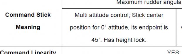

pretty sure the shutoff intelligent thing is so while flying you can't shut em off so you gotta do the startup sequence to get em going while it's falling and your trying to figure out what happened. I also though it leaned 45 degrees in atti and unlimited in manual. it doesn't shut off at 45 degrees, just makes it go forward, back, whatever direction your pointing it and corresponding to the throttle gaining or dumping altitude.

In intelligent mode, if you lean it over 70 degree and throt 10% below, in Atti/GPS mode, motors will stop right away. The purpose is to protect the motors if it is tipped over in an accident.
I too have had it in my hand and tilted it over, both up to and beyond 70 degrees and still no shut off. Not sure why. But on a number of forums, people are describing NAZA based copters dropping out of the sky for unknown reasons. My guess is that the NAZA is somehow erroneously misinterpreting some inputs as a motor shutdown command.
I have re-read the 1.4 Manual for NAZA and it states this:-
Intelligent Mode: By using this mode, different control mode has different way of stopping
motors. In Manual Mode, only executing CSC can stop motors. In Atti Mode, any one of
following four cases will stop motors:
a) You don’t push throttle stick after motors start in three seconds;
b) Executing CSC;
c) Throttle stick under 10%, and after landing 3 seconds.
d) The slope angle of multi-rotor is over 70°, and throttle stick under 10%.
