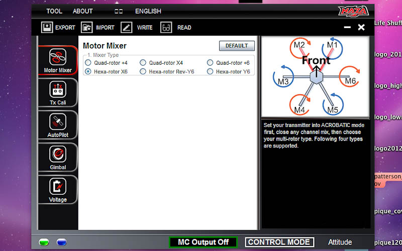

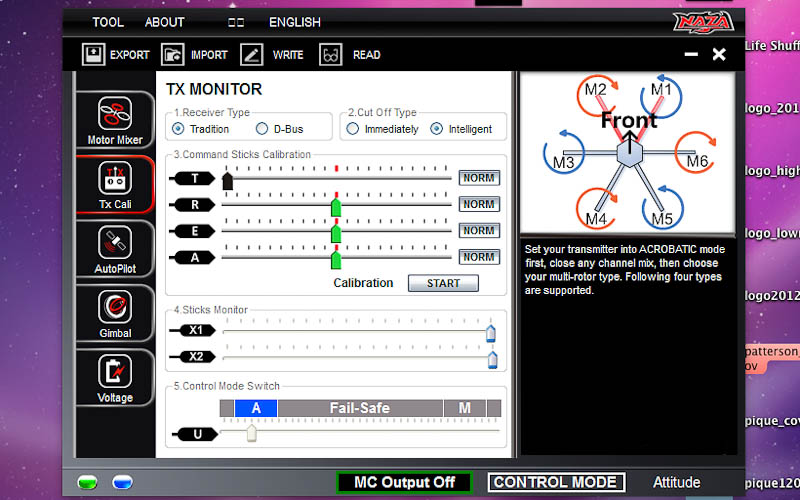

Show us some pictures of your set up including some screen shots of your Tx Calibration screen. Motor 1 is right front, motor 2 is left front and motor 3 is left side and so on. Make sure that you have your motors connected accordingly.

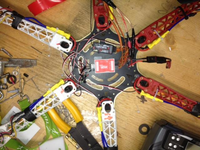

photos asap.. YES, you bet all motors are placed / wired accordingly 1-6 placed counter clockwise starting front right at M1. I'll pop the top board again here and get some images.

View attachment 4431 naza placement. Motors as marked / wired 1-6 starting front right of naza front. All blades / rotations are correct
RX - NAZA
1- A
2 - E
3 - T
4 - R
5 - U

Back should be where his battery connector is, by the direction his naza is mounted - if that is correct and everything is setup accordingly the setup looks ok - as you need to counter steer the quad to keep its position I'd say check you transmitter for travel adjustments or any other introduced modification - check your monitor screen if the transmitter sends a forward elevator signal
you bet - white was front. Spent all night trying to sort it out. TX seems to be sending all the right signals. Back to square one, I went through the esc's again to recalibrate "just in case" the first couple times didnt work.. Putting it back together here today. I think from my test fire it may have solved the issue!

For the sake of rapid orientation, and this is only a suggestion, I would switch the #5 arm for a red one or #2 for white. Won't solve your problem, but will be a whole lot easier to tell front from back. Does that make sense?

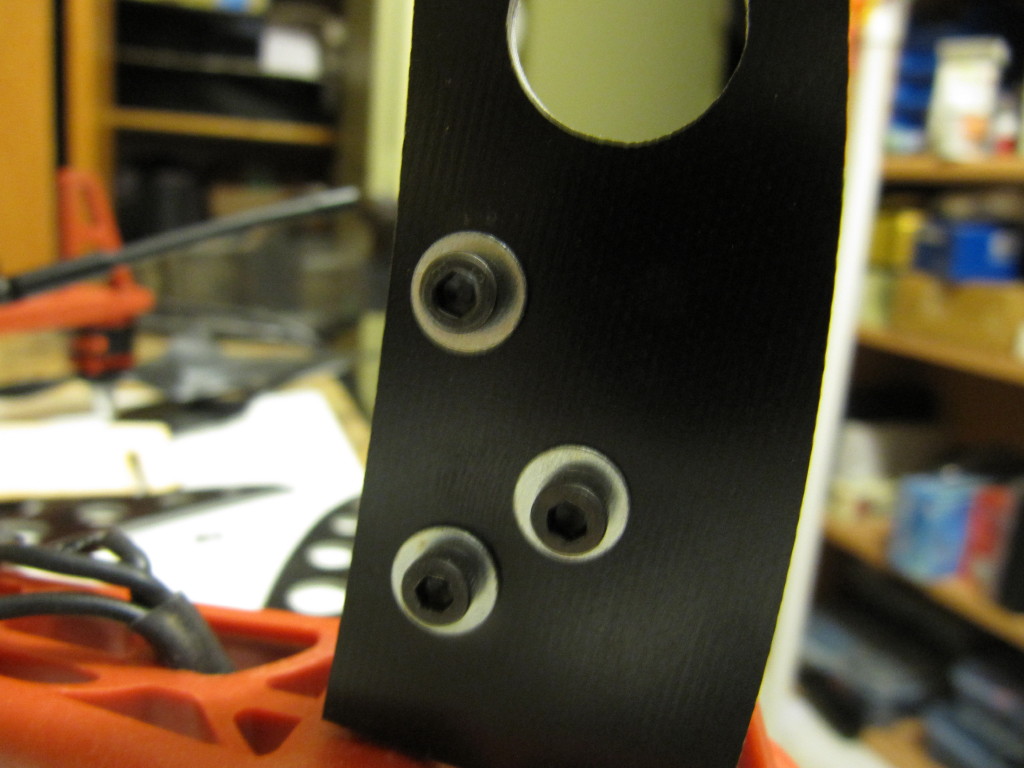

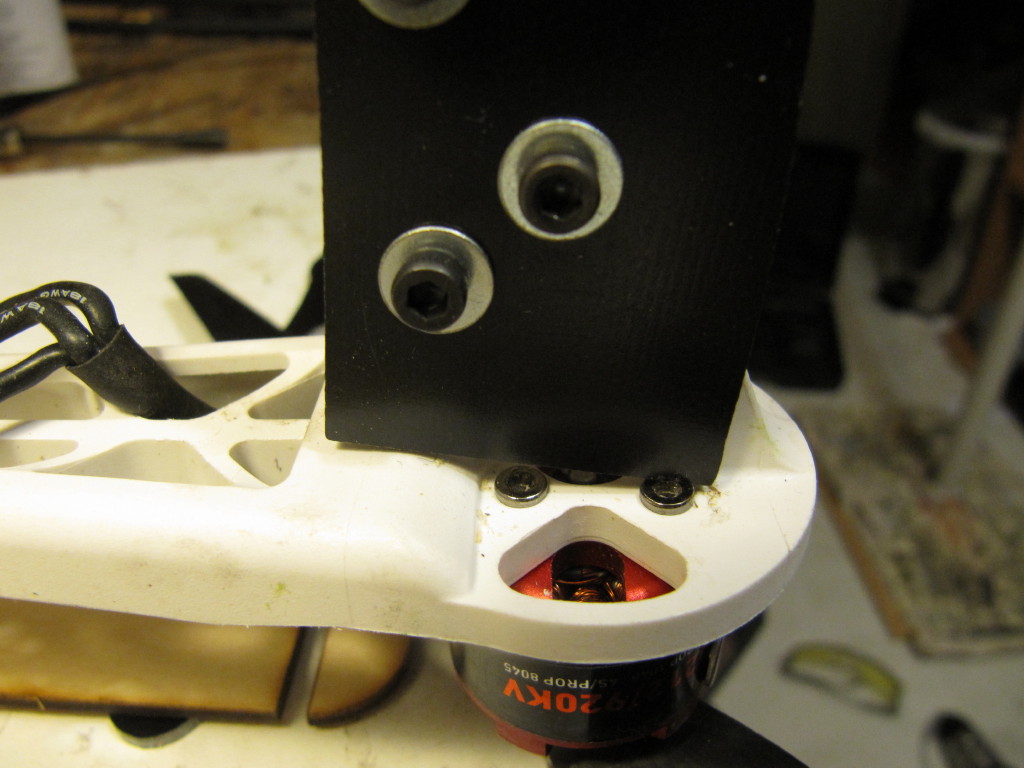

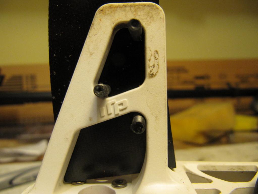

well, she seems to be flying now. Second issue arose. Same as on my 450 I'm unable to get the bird to fly with the standard 10" props. It "jumps" in hover, is super unstable and jjust wants to climb but very spuratic.
I've tried loads of different gain settings based on the 450 google doc.
I'm flying the 550 with the 468 landing gear, and the 2 way gimbal and a contour camera.
8" standard gaui props it flys like a dream with 1.04 software, 160 160 160 180 90 90 gains.
any suggestions. I want to run the larger props...
