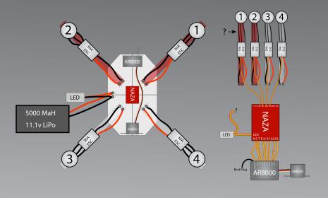

View attachment 3707Hey guys so I think I'm nearly set. between school, work, and parenting I haven't had as much time as I wished I did but I once I get this thing built I'll be ready to move on to the next stage of the process which is learning the TX. I know this probably should have only taken like an hour but I've managed to spread it over two weeks. :)
I was just wondering if you all could give some insight on my diagram. The only real questions I have is how do I know which line plugs into which port from the motors to the ESC's, and which port to plug the second LED line into.
Any thoughts?

Plug in the 3 motor lines to the esc (worry about proper direction later), one of the led lines (the one over the + side) plugs into F3 on the naza, the other plugs into the horizontal slot that sits above the throttle, aileron, rudder, etc. plugs (it sits horizontal compared to the other pins that sit vertical). Once you get it all plugged in and happy happy with the naza software, check your motor rotation, if the motor needs to be reversed just pull the 2 outside plugs out of the esc and reverse them.View attachment 3708

You're the man! thank you
