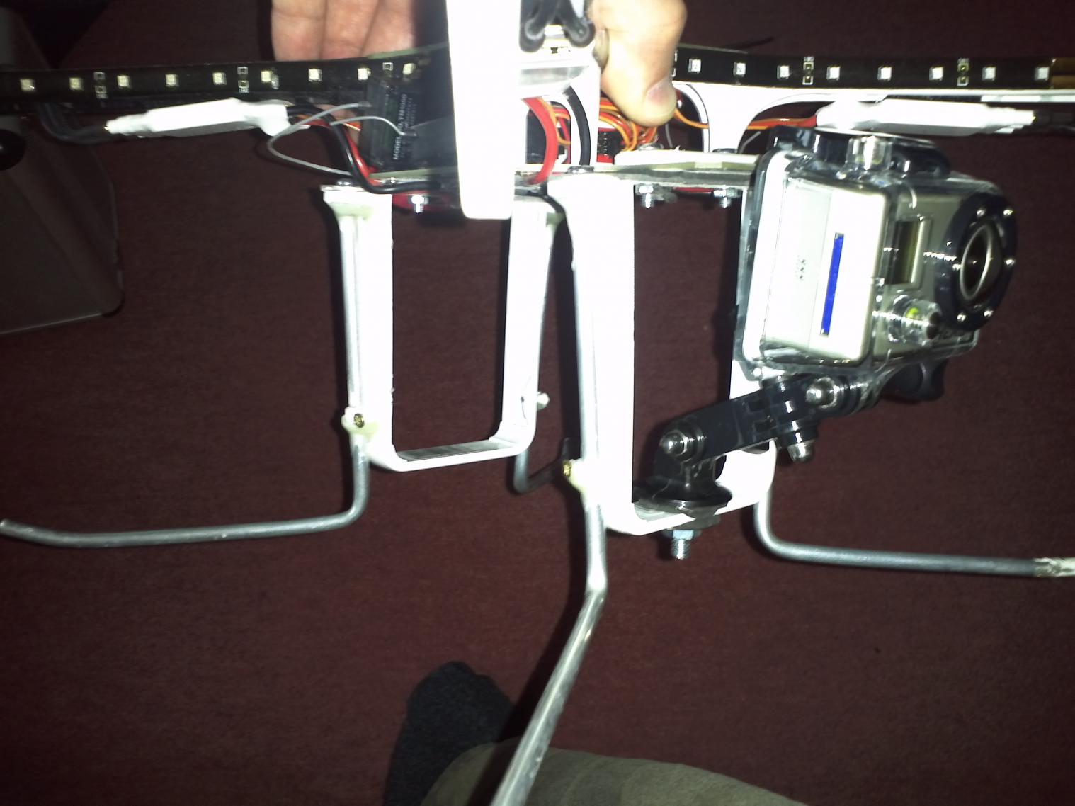

I built it with the bottom plate tabs facing back and front so I could hard mout the go pro on the front tab. I did that but wasn't happy with it so I,ve made an under carrage out of some 6mm ali tube some ali bar and a pair of drain pipe clips. Lifts the quad about 5 inches and lets me under sling the go pro.
Bit of a lash up but works.
Quad seem more stable with this on, but only get about 5 minutes out of a 2300 3s pack.
Wondering if a pair of them to give 4600 3s will give significantly better duration or if the extra weight will negate a lot of the capacity gain.
Filming at fistral last night the initial results look ok. A few twitches to try to iron out.
