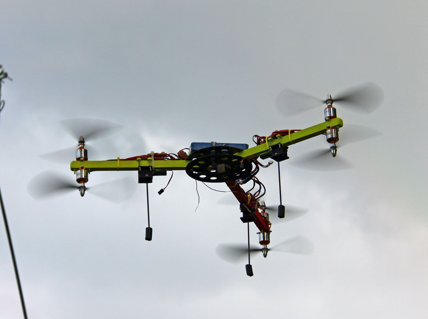

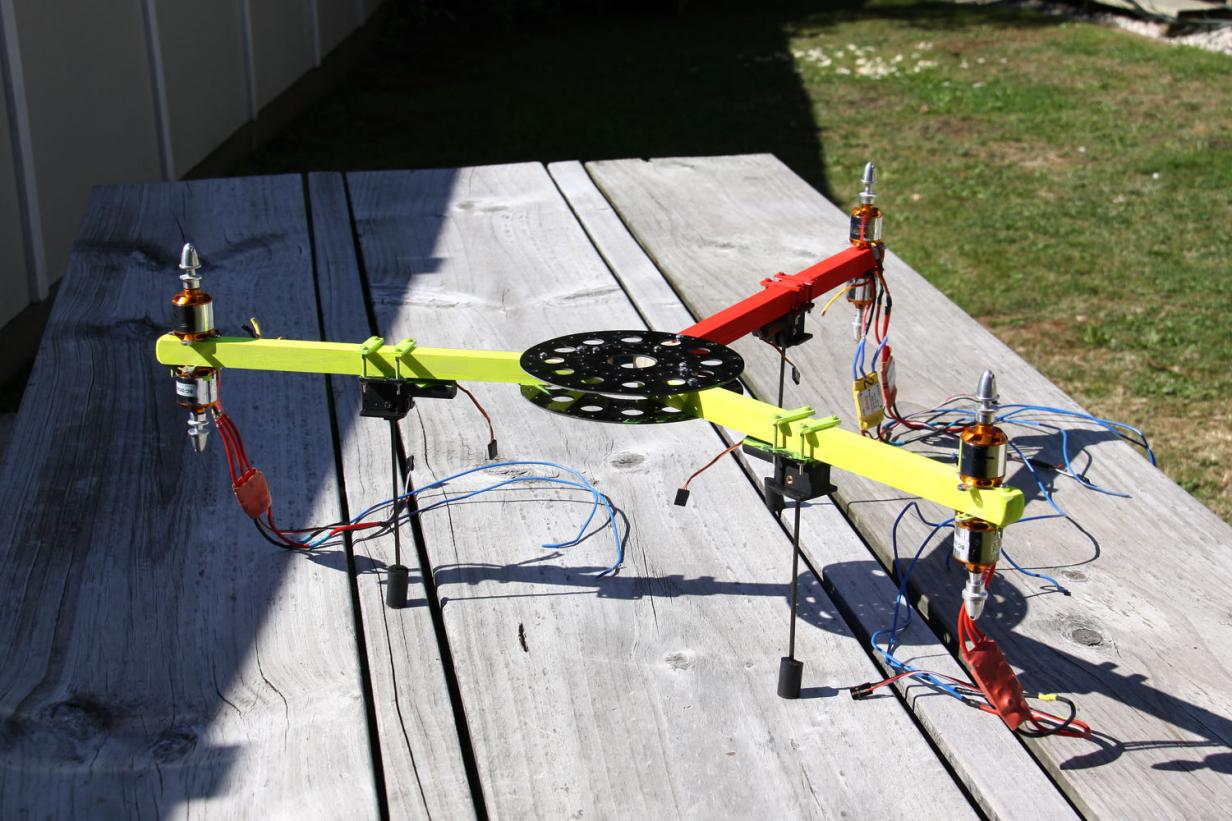

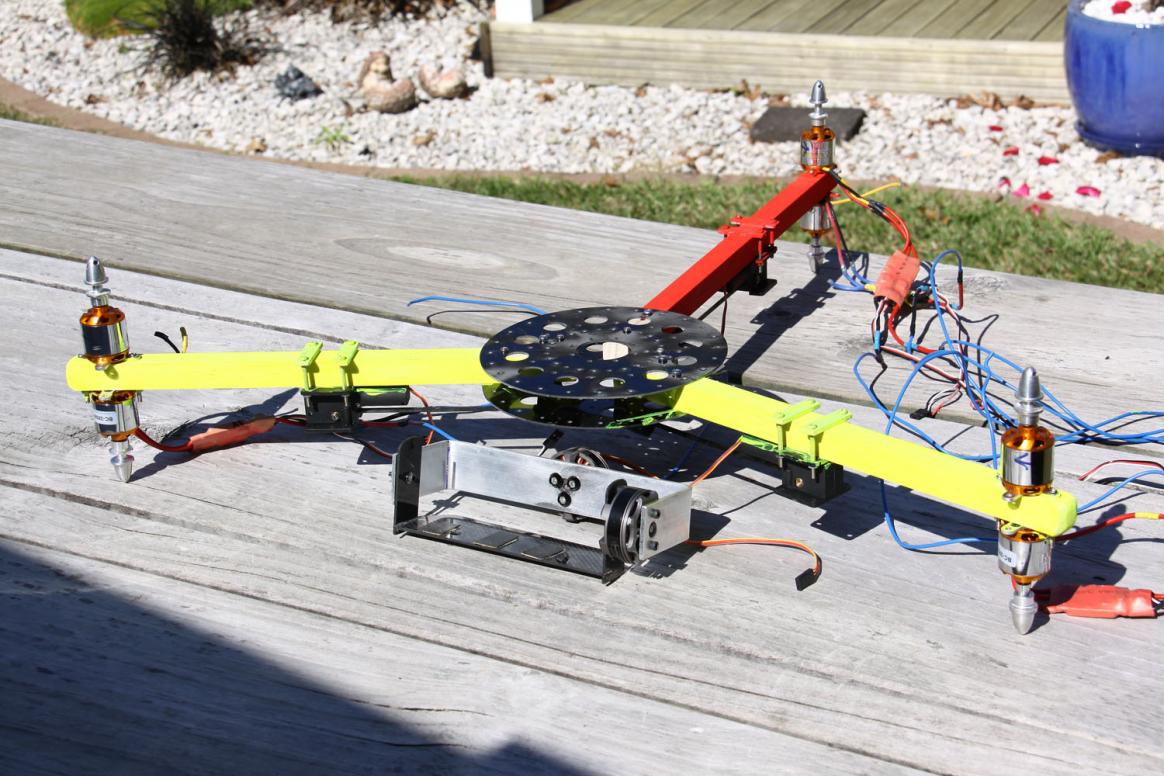

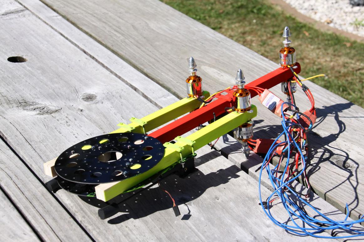

I have been looking at a model suitable for travelling / tramping. I built a travel Tricopter over two years ago and it was brilliant :D Time to go for an fpv folding Y6.
I will look at some Sunnysky motors but I have a dozen spare RCTimer 2836/11's - so today I built a Y6.
630mm m-m
18mm square pine for arms.
6 x RCT2836 motors
A spare Rusty's centre hub
Spare HK electric retracts (because I can)
Hoverfly Sport board.
3S3000mA
6 hours later :) it goes.
Tidy-up and gimbal tomorrow
View attachment 10884 View attachment 10885 View attachment 10886 View attachment 10887

This is how she goes...
I have an hour on this machine now and it is a blast. Time to get the fpv camera on it.
