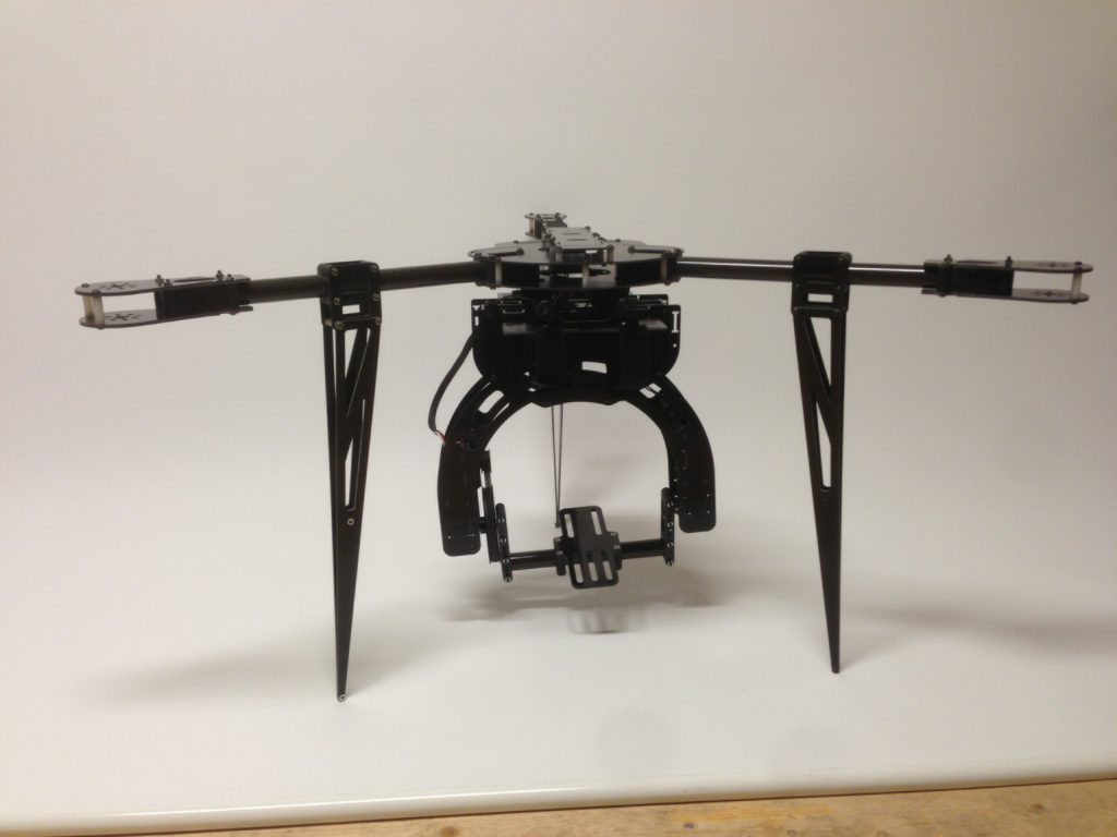

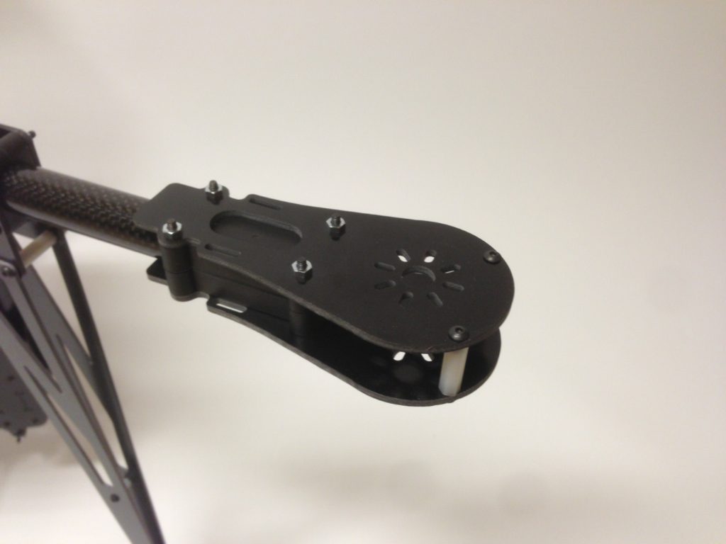

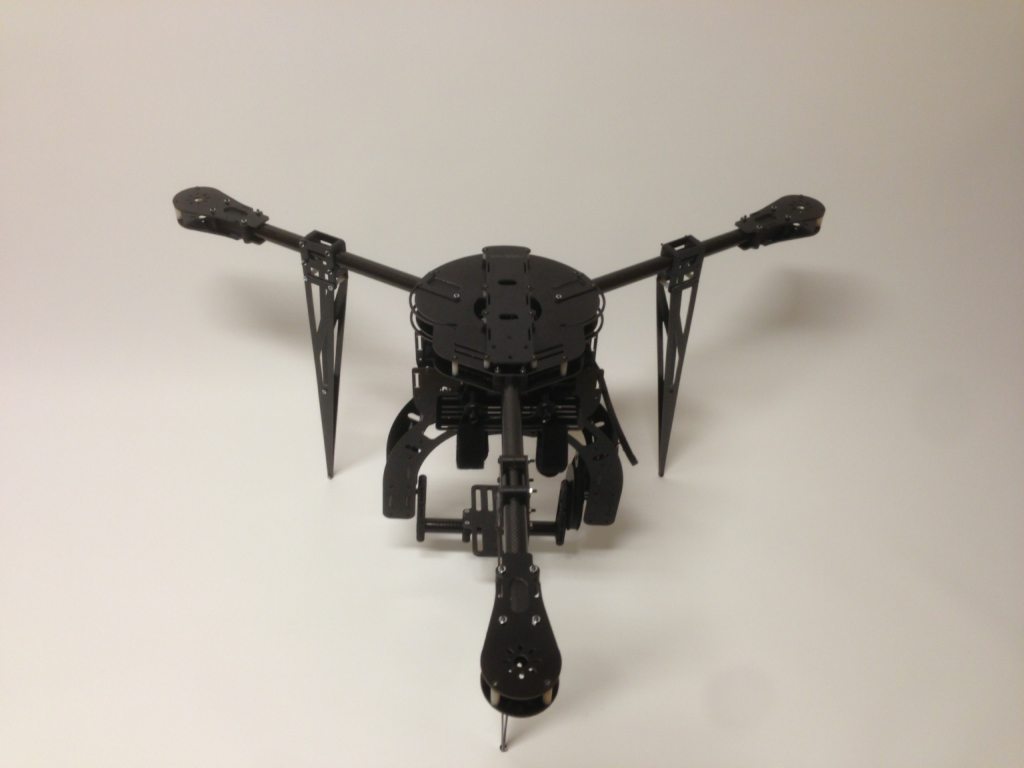

My new Y6

Your setup looks great!
If I may ask, where did you buy the parts - or is this something you made?
Thanks in advance for any info.
Fredrik R
Made it myself. 19mm carbon booms. 2.5mm motor plates and the rest is 2mm.

Do the arms spin or how do they lock the motors down? That's always a concern of mine when I set that setup. It looks really good though!! You might want to consider going with landing gear that is smaller or round or at least has less of a "wind signature" meaning they won't act as sails slowing you down. One thing I've learned is round legs produce less wind resistance and therefore make it easier to fly in the wind. I just recently had a major scare where I thought I wasn't going to make it back, I was flying in 45mph winds and I was about 4,000 feet out when I was trying to push my way back. I got a low battery warning at 3,500 feet out and I was pulling 800W just to move 10mph so I was terrified I was going to splash down. Lesson learned!!!
