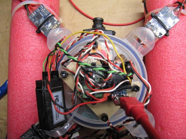

I finally got around to wiring up the MultiWii board that I put together months ago.
The wiring is a bit of a mess because I didn't have an interface board and with it just being a test craft, I did it fast. Bottom line is that it flew well with no tuning. I only flew half a battery but so far I like the board.
I used the old way of doing things because that's the way it was done 5 months ago when I started collecting pieces. It's an Arduino Mini Pro ($20), USB adapter board ($10 or $20), a gutted Wii remote, and a gutted Wii Nunchuck. Everything is shoe gooed together on the back of an old credit card.
I used my Jakub frame that previously held the KapteinKuk board. One of the things I like is the ability to switch to stable mode which uses the Accelerometer to self level.

It levels well. I can snap the sticks and the quad will hit about a 45 degree angle and bounce back immediately. I do need to use a lot of trim to maintain a level hover. It's a problem with my setup that I haven't figured out yet. I ordered a new board that has all the sensors built-in so I'm not going to worry about it too much.
All in all, it's a good setup for a beater or sport quad or for someone who wants to start cheap. The MK battery costs more than this thing. ;)

It's on a Jakub frame that costs $70 I think. You could build this on an old yard stick and plastic tub from the dollar store. So including a 3000mAh battery it was a little more than $200. Motors and ESCs were about $10 each.
