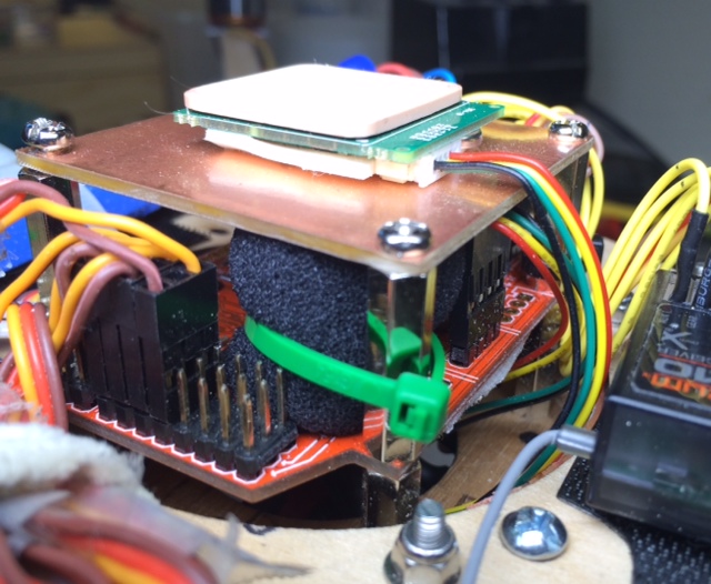

I have horizon on all the time on my board and I then add Baro to Horizon once I am in the air. I use a small black foam pop screen from a headset microphone I wasn't using and positioned it, covering the baro chip (the one with the pinhole in the center). That chip dislikes both light and gusts of wind (prop wash). A microphone pop filter's foam can do just the trick. Search for ways to secure it to your board. Since I have a copper clad pc board over my flight board on standoffs, I wedge the pop screen under the board and secure it using a small loose cable tie. The pc board serves as a base for my gps chip.
