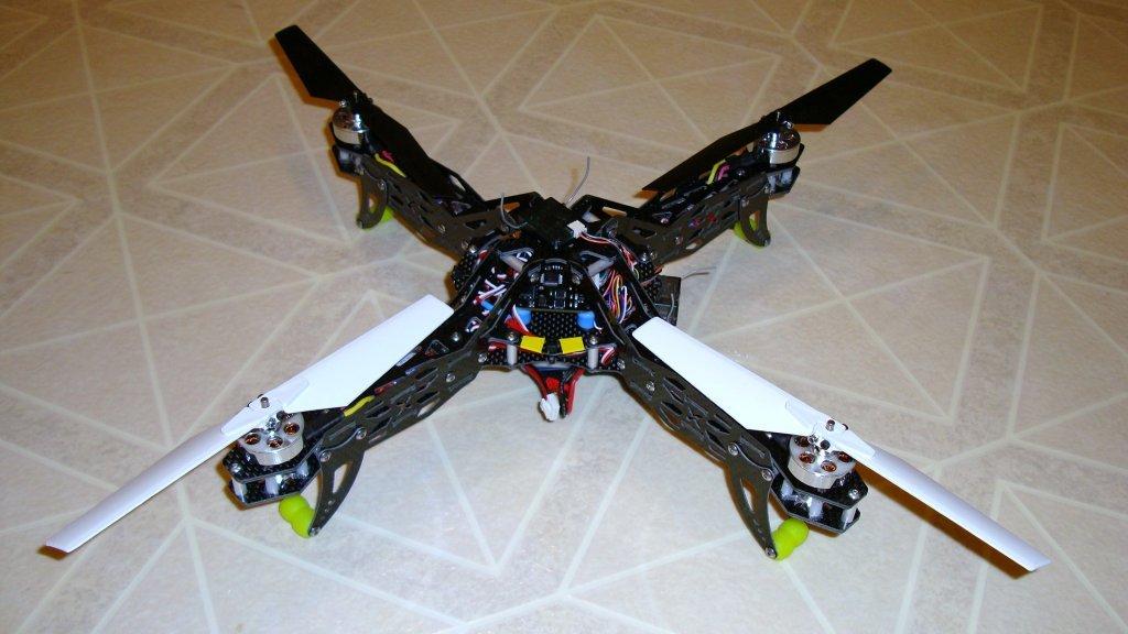

Tonkajeep.. that looks like one neat flyer.. guessing 500mm rotor centres..
There seems so many frames and combos out there its hard to keep up..
Nice
Thanks, Yes it's very close to that. I think i originally cut the arms to be 26 or 24cm... Its very light and has me thinking i need to put my home built tri on a diet!

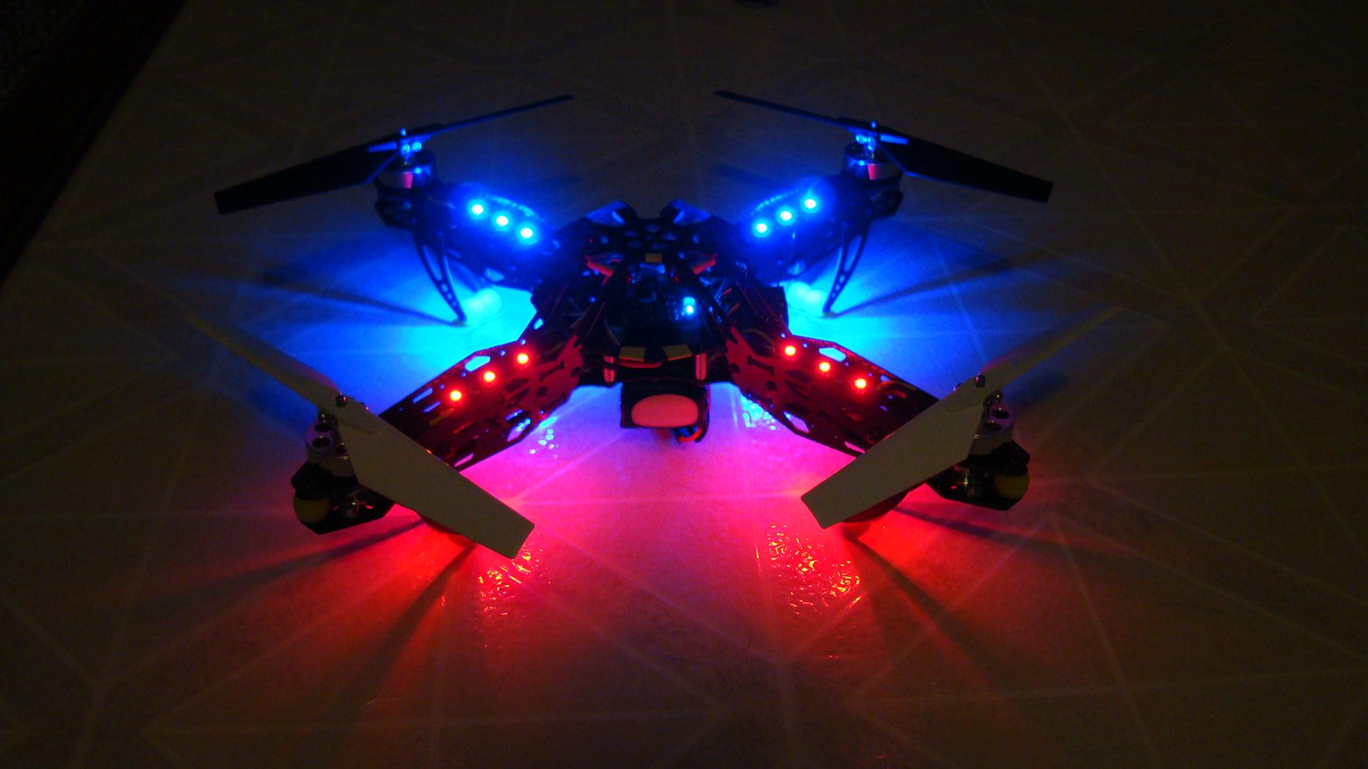

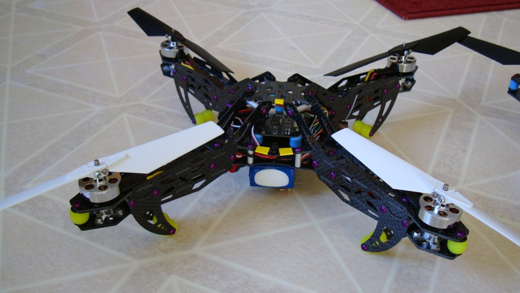

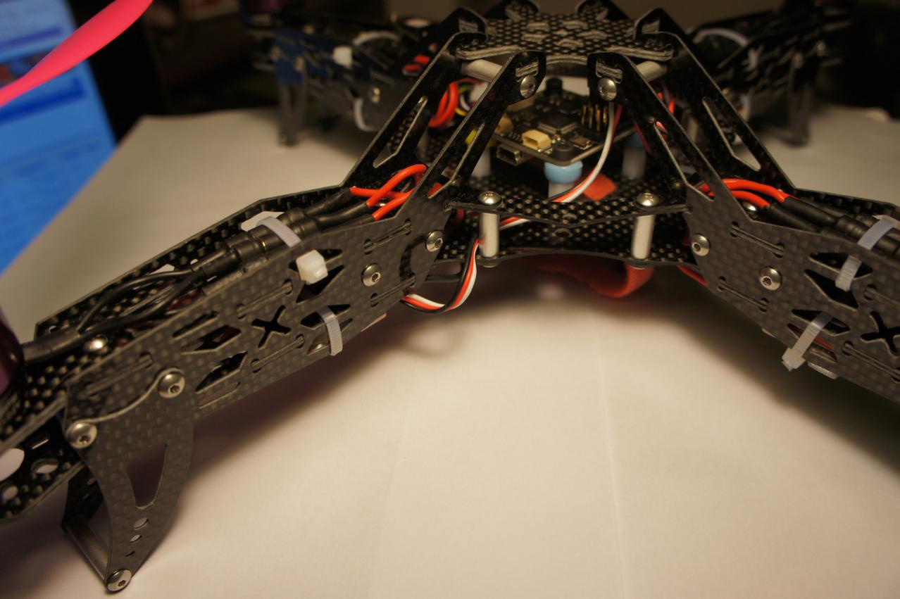

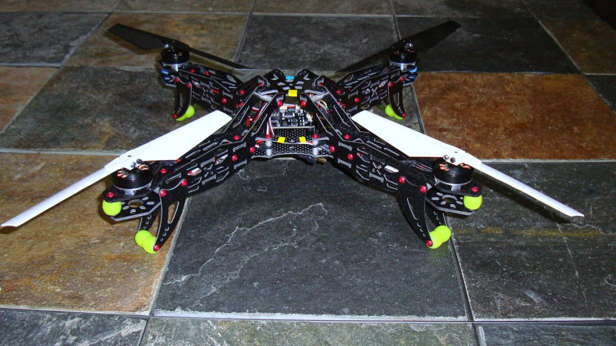

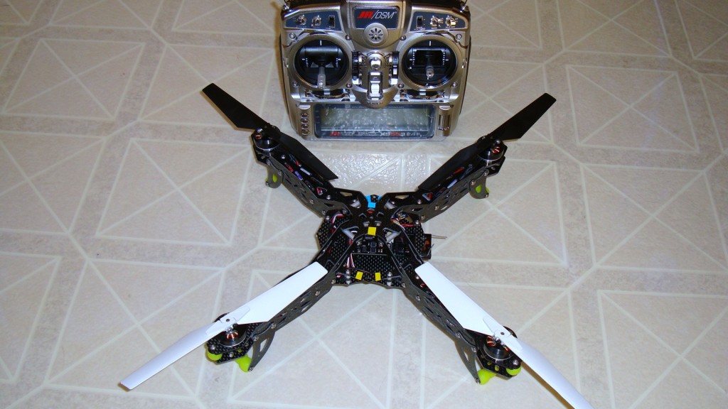

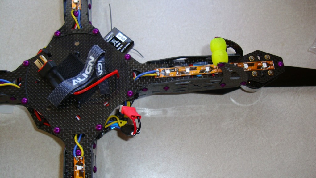

Thanks ! I love the compliments, makes the hard work worth it :)

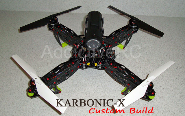

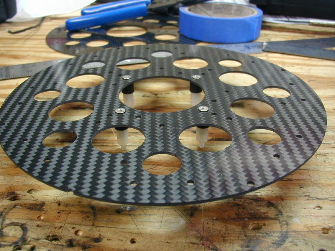

It's the Karbonic-X frame that I designed for AddictiveRC
John at rchobbyhelicopter.com has them in stock for sale now.
Thanks Dave :)

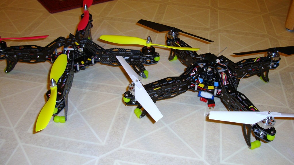

a few different configs are shown.
they all have the Coptercontrol FC from the Open Pilot team
one of them has custom Cobra motors 1088KV
one of them has Hextronic 1300KV motors
the colored props are the Gaui 8x4 for the 330X
the black and white props are from L.A Heli and are for the YUFO they are about 7.75" total and are undercambered. I like these the best on the Karbonic so far.
using Plush-10 ESC's set to 400Hz update from the CopterControl
I use a Spektrum AR6115e RX but I plan to go to the Spektrum SAT option soon.
here is a video of the Karbonic-X carrying a Contour HD cam custom build by john at AddictiveRC
Karbonic-X Custom builds , RTF/ARF by John at AddictiveRC
John at Addictive is currently doing custom full builds of the Karbonic-X using Coptercontrol FC's
if anyone is interested in a RTF or ARF build of the Karbonic-X or other Karbonic-Series drones, contact him at EMAIL JOHN
It's a quick and hassle free to get one in the air

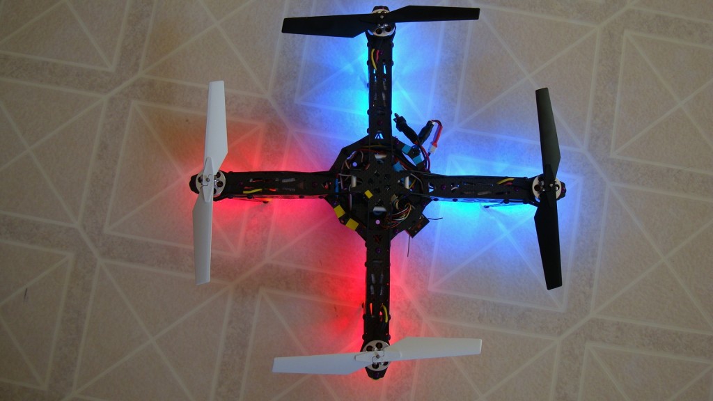

Hey Guys Just Thought I'd Chime in here.
Dave and I have Been having a Blast Building the Karbonic-X and Flying them.
The Custom built Karbonic-X with Custom Cobra Motors has over 4 Pounds of Max Thrust.
AUW is only 500grams. So the Power to Weight Ratio is off the Charts.

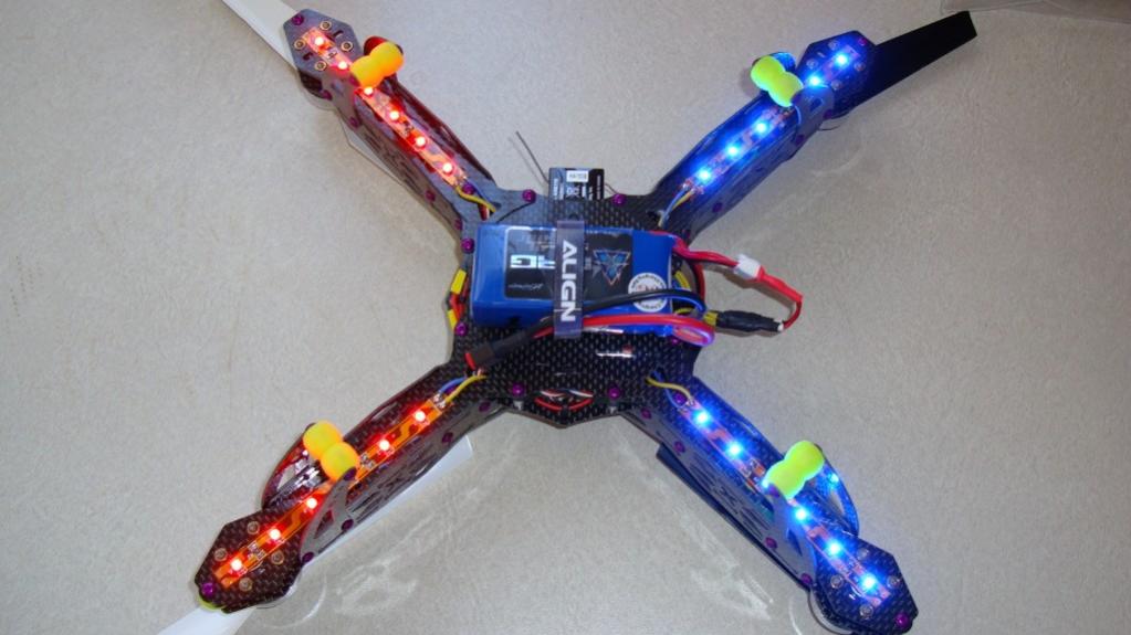

Here is a Night Flyer Karbonic-X I built.
Cheers, John W.

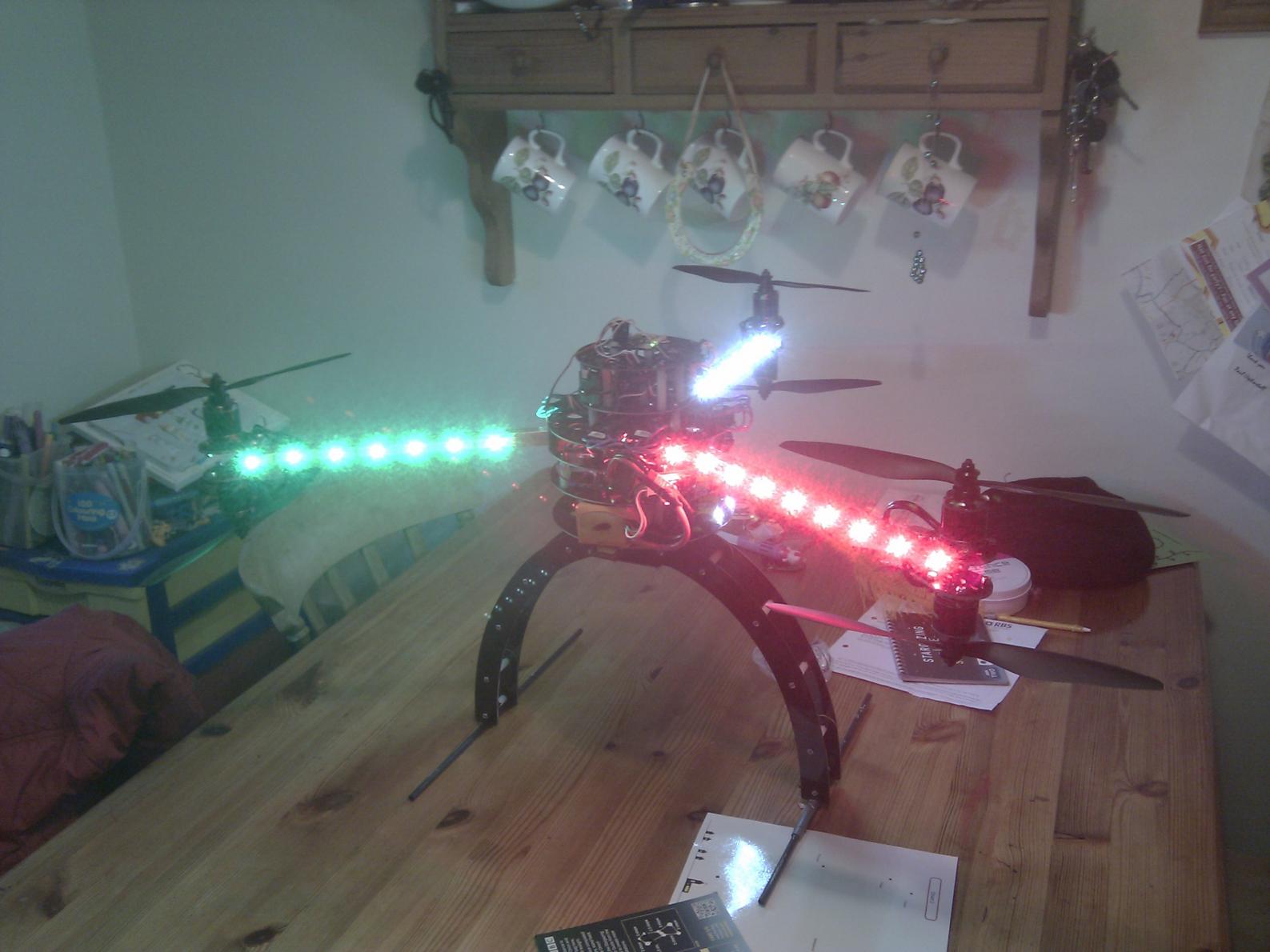

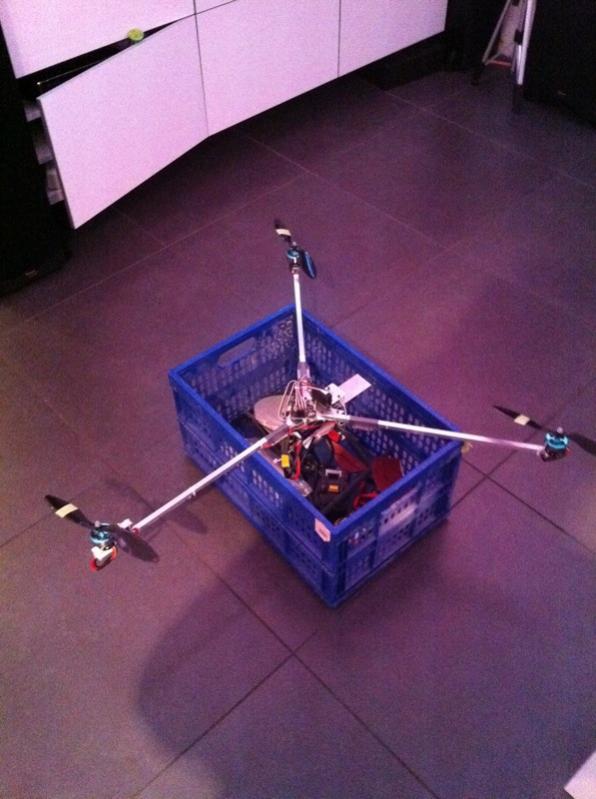

My Y6.
CopterControl
Rusty UAP-1 frame
CM-2 landing gear
Torxpower 2216
Hobbywing Pentium 18amp Brushless Motor esc speed controller
5C Charge Loong Max Tipple 4000mAh 20C 4S Lipo Battery
1/2" SQ.ali tube(simmal)
