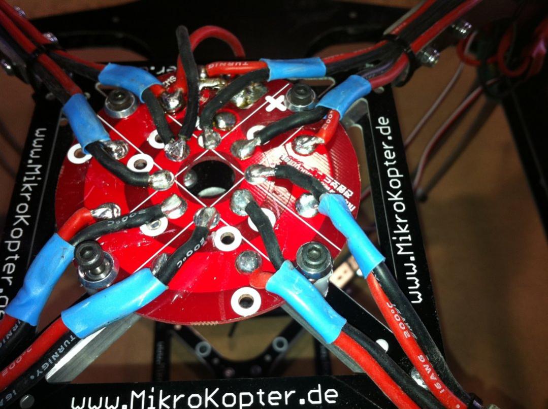

I also got a power distribution board so I can supply power to the ESC's..No way I was gonna sit there and solder a harness to
connect all 8 ESC's together.

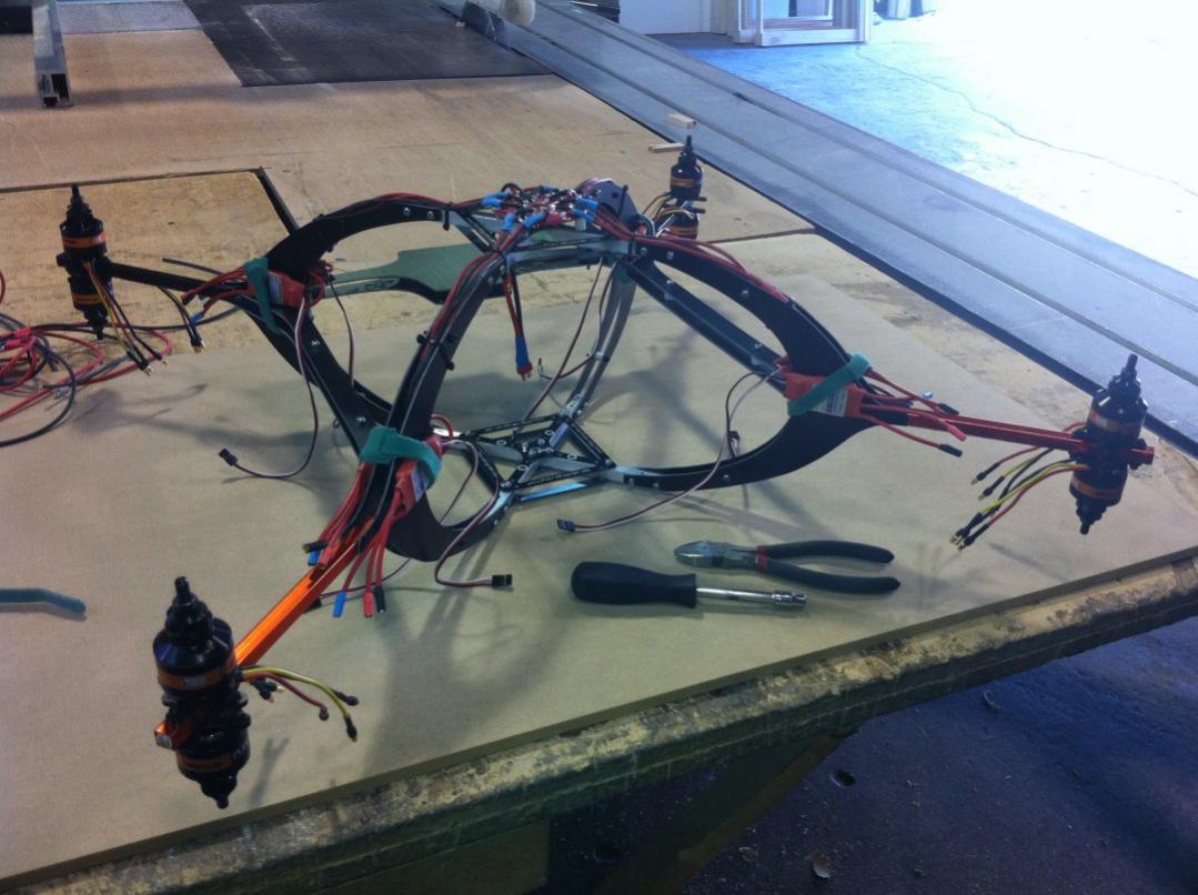

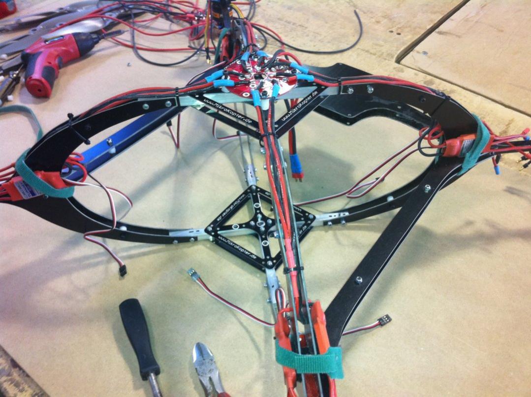

So, I tore it down and transfered most of the stuff to another frame waiting to be born.
This one is made out of 1.57mm G-10 and 10x10x1mm square allu tubing.
I used the arms from my old octo red and black since the led's were already on them.
Much, much lighter she weighs in at 1956gr with out the cam and mount, Almost half the weight.
She is almost put together but the wires from the ESC's are too short to reach the flyboard, I ordered some extensions from Servocity.
Here are a couple of pics of the NEW design. Is the same diameter as the original one but much slimmer. I like it..

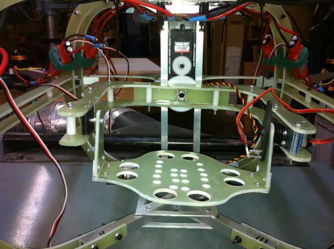

Thanks Sid, It took a while to get it done. First the prototype and now the final version.
The camera will be mounted inside the cage. See picture of the prototype. I cut a new mount and waiting for gears from Servocity.
I still have to adjust the PID settings to fly smoother.
