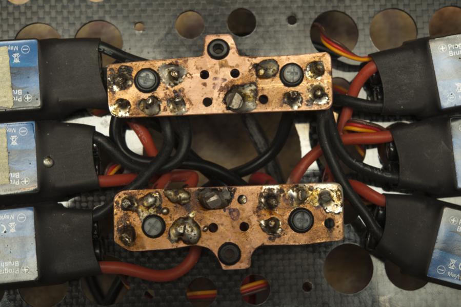

I calibrated them with a snake I made so all the ESCs can be calibrated at the same time. However I am not sure what signals I am supposed to get if calibration is successful. I am using a Spektrum DX8.I am learning from others that on larger props this happens occasionally and does not effect actual operation, only start up. The ESC wires are soldered to a copper bus bar and I inspected them carefully before assembling everything. I did take a good photo and you can see the nice solder flow. View attachment 11975

Hmm Giovanni I would`t go by the statement only occasionally and does not effect the actual operation ! You wouldn't drive you car if the one of the brakes don't work when you start it, but once you get the brake running which happens occasionally than its safe to drive off.
I would do the following steps.
1. Check the soldering not only the part were the ESC are connected to the distribution but the part were the three phases of the motors are connected.
2. Change components around like lanzar already suggested ! See if you can find the component that caused the late startup or the not starting at all problem.
3. Recalibrate your ESCs. if you are not sure what feedback you should get to indicate that the calibration was successful it could be that one didnt join the calibration routine with the others !I would suggest not to try any epxeriments and do every ESC by itself and calibrate it with the receiver and throttle on your TX !
You know how much time and money went in it. This could be the beginning of a faulty esc, thus the end of your copter if you fly it ! One component badly soldered for example on the specific ESC and thats it !
