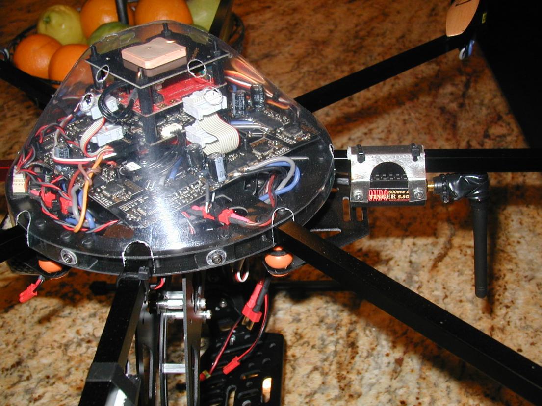

Well, it appears my problems were related to the proximity of my video tx to the motor controllers (aka ESC's or BL's in MK-speak). I was able to get in two flights this morning and both had stable, clear video from the camera. I.....am.....so.....freakin'.......happy.....!!!
The pics show the change and I'll take it all apart again later tonight and remove some material from the mount to make it a bit lighter but it works so I'm off for a fresh cup of coffee to celebrate. Thanks so much for all the input. Thanks also to Ira from Iftron Tech for exchanging emails with me late into the night last night. All the little clues led down the path to try relocating the video tx on the frame away from the ESC's and that seems to have fixed it. I really hope the problem is solved once and for all.
