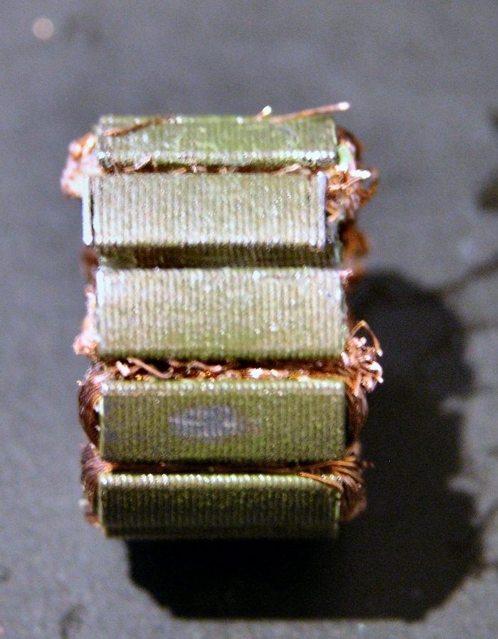

OK since we're talking bout motors it looks like in the process of attempting to remove the stator on one of my Roxxy motors it was deformed. Guess I used too much force with the mounting screws. Before I waste a lot of time taking all the original wire off the stator can the stator be straightened in a vise or did I screw the pooch here?
Buzzed,
I'm not an expert but the tolerances in these things are pretty tight. On top of alignment of the shaft through the bearings and case, there is hardly any clearance between the stators and magnets. A very tiny shard of metal got into a motor of mine and jammed it up! I'd suspect it's done unless you can straighten it out and mic it to see how straight it is.
Good luck,
Bart
