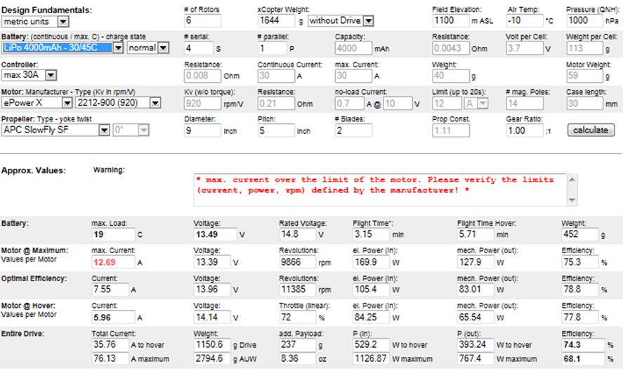

Hi helloman, if you are looking for a good calc program try this one:-
http://www.ecalc.ch/xcoptercalc_e.asp
Regards - bruce
Thanks Bruce, I've used that thing a dozen times and it always says "no enough power to hover" no matter what I put in there. Even if I put the weight of my Multi at 0 it still says it won't fly and I'm using only built in options. Doesn't matter what I put in, even if I look it all up manually so I wouldn't trust that thing as far as it works :)

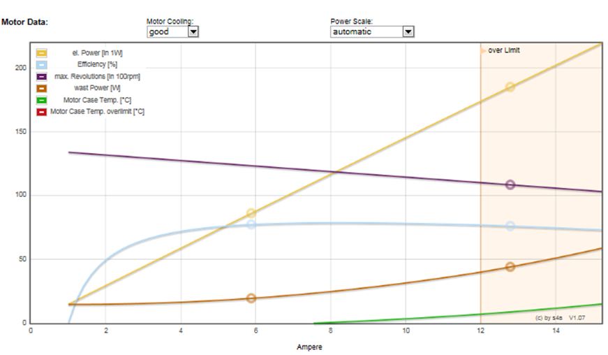

gtranquilla
RadioActive
Granted there several counter-intuitive aspects of ECalc for Multicopter such as:
a) xcopter weight with and without "drive"..... (doublecheck with the bottom reported AUW - all up weight to gain perspective and lot this data correctly at the get go)!!!
b) erroneous data presented as fact when you don't put in all the date required for it to do proper calculations
d) confusing Motor manufacturer/type KV in rpm/volt.... etc/.....work thru it carefully!!!
e) Inability to load some new motor data no available torque curves or data from new manufacturers.
f) calculate button may or may not do anything whatsoever!!!!
But if you fight your way through these issues you gain tremendous insight into which way to go..... Here is a good example:

I'll give it another shot and when I do I'll post like you did. Maybe you can spot what I'm doing wrong.

Hi helloman, the F550 from DJI comes with stock 920kv motors at about 120 watts each motor. My virgin F550 flew best with 8 inch graupner props (smoother than with 10") and 4s battery (5amp). When I added weight, landing and gimbal, telemetry, gopr2, FPV gear I had to go to 10 inch graupner props to carry the extra weight (2.5kg).
DJI obviously had done their research and decided a 920kv motor was best for the rated weight and prop size. What made you therefore decide to use a 1350kv motor with 10" props?
Ecalc works well if you feed it with appropriate numbers.
Regards - bruce
