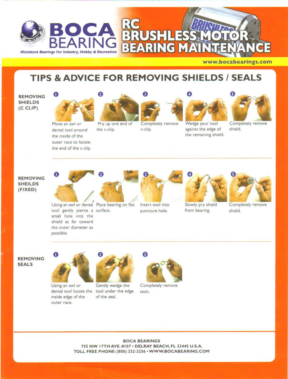

most of the bearings we use come pre-lubed with grease. if you research the applications that our bearings can be used for you'll see we actually fall into the low-rpm category and that calls for grease. if your bearings come pre-lubed with grease then oil will break down the grease, displace it, or be chemically incompatible with it making the bearings fail more quickly.
I've attached an info sheet from Boca Bearings that goes over bearing maintenance.
