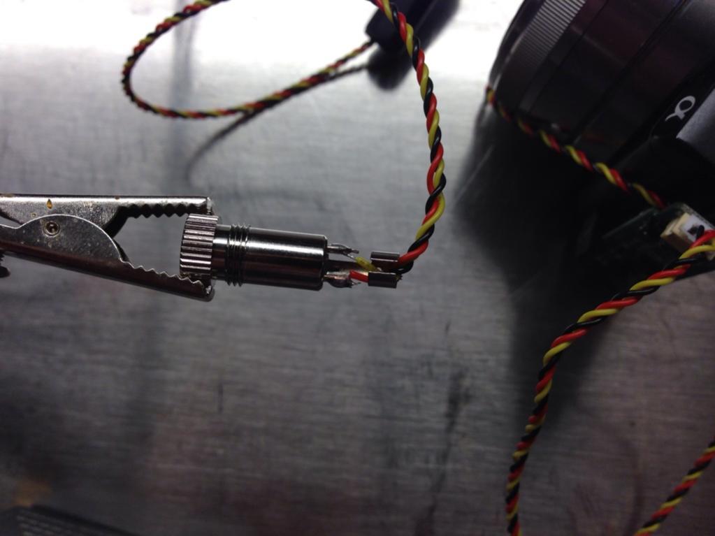

Went to radio shack and got a 1/8" phone jack. Soldered the yellow to the small silver tab, red to the copper small tab and black to the larger ground connection. Plugs right into my dji downlink and works like a dream through my pirate eye. One thing I don't get though, if I remember correctly, one output was for audio, yet all three wires are needed to make it work.
It would work with just the yellow and red, but when I picked the camera up off the bench, it went blank...black obviously being the ground.
View attachment 16029View attachment 16030

Hey Bart - yeah mine is still working nice so far. One thing that was odd is that I had to hook up all three wires to get it to work, even though one wire was labeled for audio. I just kept trying different combinations until I got a signal. I soldered it up to a jack which plugs right into my dji downlink like this:

bartman - I don't speak the language, but looking at the first video here (http://www.rcdevice.com/en/page92.html#.UzrLkqhdWTO), @3:49 it appears audio is yellow, video is red, black is ground (unless they're trying to be even more confusing than their color choices...)
holy crap! are you kidding me?? was that an April Fool's joke from yesterday and I missed it?
edit: the labeling on my board appears to be Ground-Audio-Video but the video shows them as Ground-Video-Audio so I wonder if the board is mislabeled and the colors of the wires match the error displayed by the labels. i'll have to try the red wire as video to see if it works that way.
