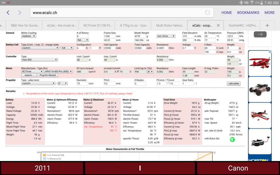

I'm running a Rctimer s1100 with the 4114 400kv pro motors swinging the foldable 15x5.2 probs. I am getting around 13 min run time with tattu 22000mah . granted I have a heavy gimbal but only using a Sony A6000 at the time. what can I do to get better lift or longer flight times? new props or do I just need to start looking at new motors as well?
also, my eCalc says I'm off. can someone take a look at this screenshot and tell me what I am putting in wrong. I don't seem to overheat the motors at any time.

It's either the props, the motors, or both. The RC Timer props are not noted for being all that well made and could be part of the problem. At the weight you might consider motors in the 300-380kV range. 13 minutes with an 1100mm bird isn't bad but I agree it could be better.

Just for the heck of it, you have verified all the motors are level, wiring is reasonable length, and power wires and connectors aren't undersized, right? What kind of flight time do you get without the camera and gimbal?

without gimbal/camera I was getting a full 18 min just driving around, nothing to hard. but that was the first 3 runs on that beast of a battery! I have to say that Tattu has got a life time customer with me.
I was having a problem with a yaw turn. come to find out one of the rctimer ESC's capacitor broke loose. I was about to go mad trying to find out why it was turning. I just happen to hear something bounce around when I lowered the arm. needless to say I about passed out knowing that I was flying the crap out of it trying to trouble shoot the yaw turn not knowing there was a piece of metal rolling around on top of the ESC board. I'm using the Rctimer 40A that screw on the bottom of the motor mount.
everything I have now is from the stock S1100 with pro motors. the gimbal is an Iflight G30 with my Sony A6000 mounted. I'm a bit to nervous to mount my 6D and test just yet. other than that, the build, wires and such are good. I do need to find some way for her to lose some weight. I need to find a way for my gimbal battery to run my gimbal reciever. that could cut some weight. I have a job that I wasn't able to do recently because even using a 16mm lens, I wasn't able to get everything in the pic. a straight down shot of 72 acres. a saw mill. the bad part is that is about 10 acres wide and the rest long. thing a 8mm fish eye and just correct that in photoshop. the fish eye lens itself is quite heavy alone.
the Rctimer frame seems well built/design. I just think that the motor/prop combo the the bottom end of what they say it will do with a 5D.
