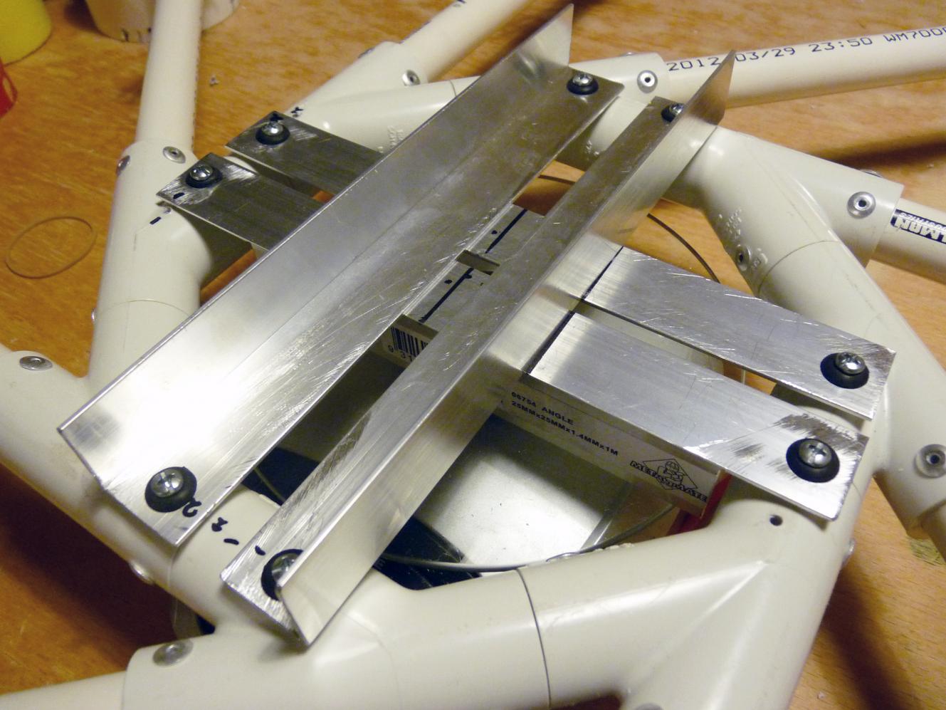

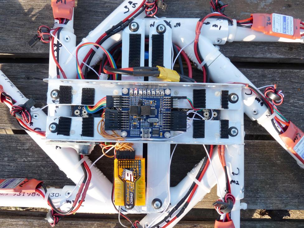

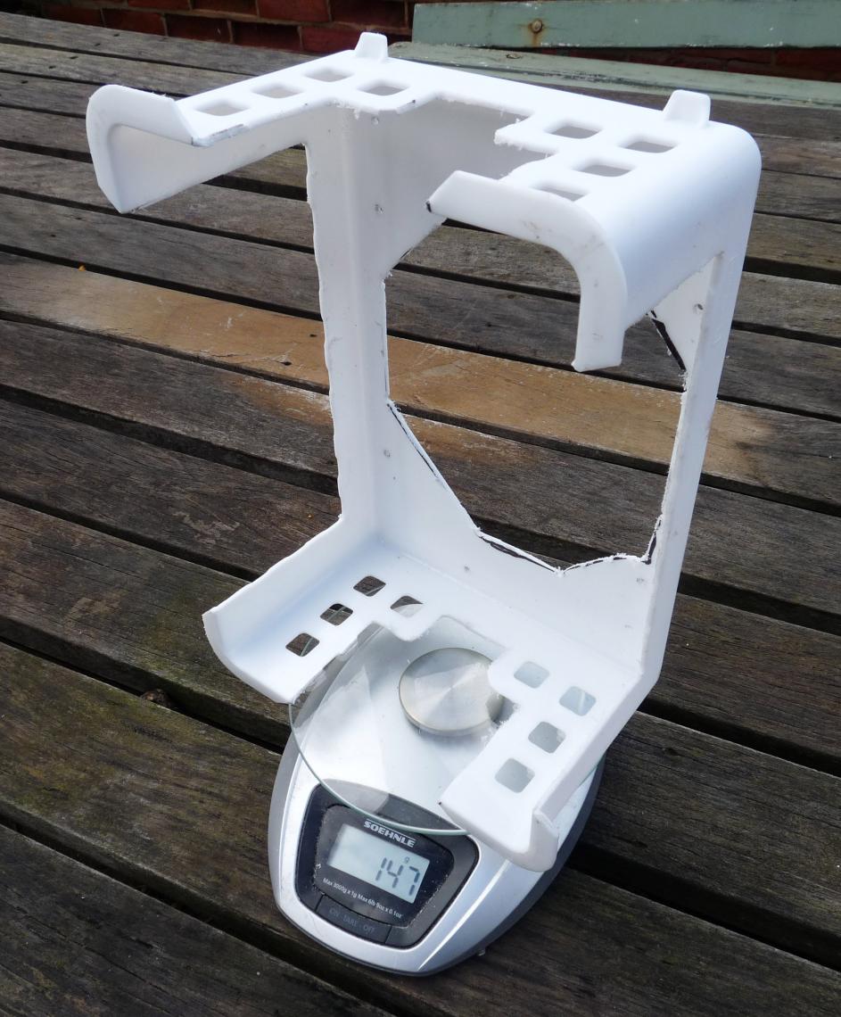

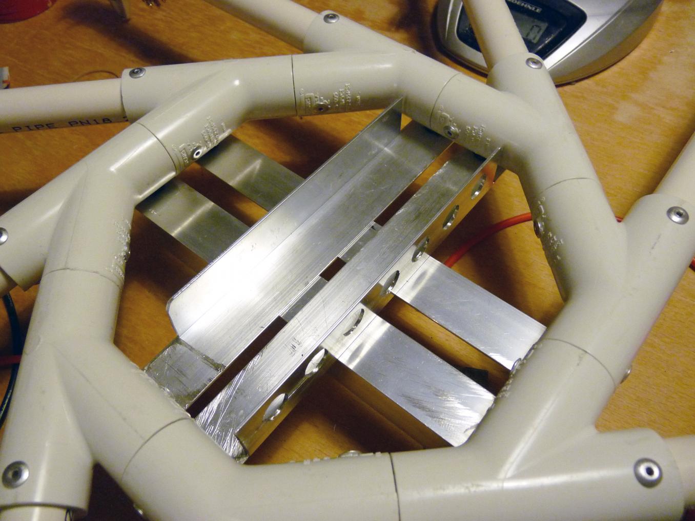

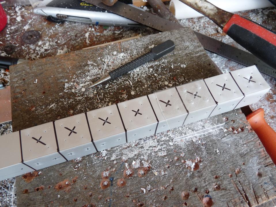

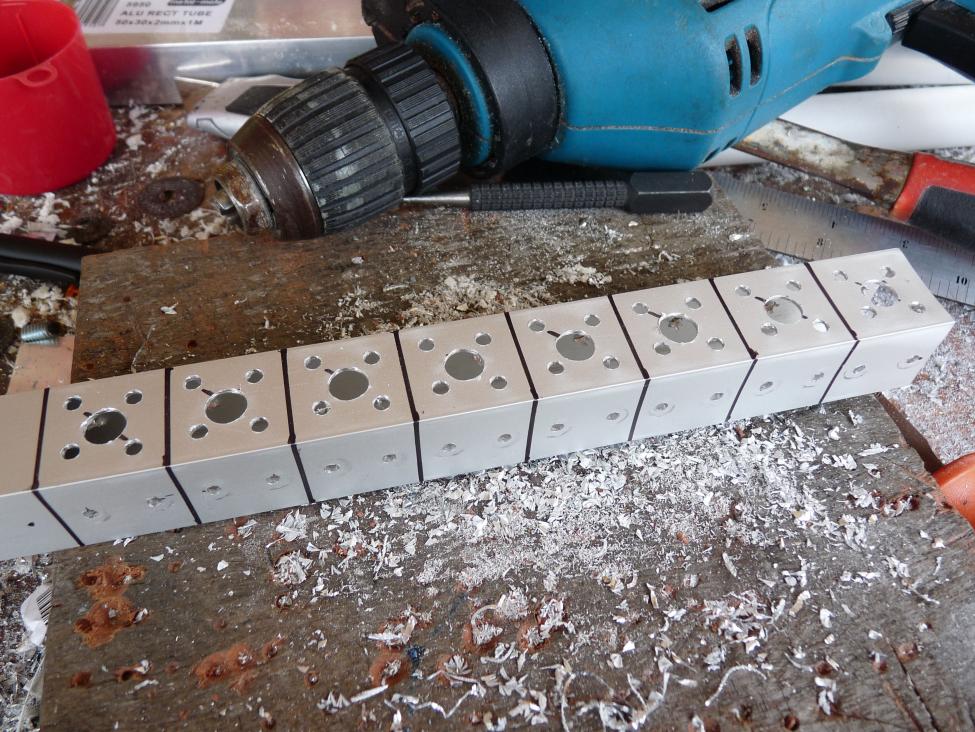

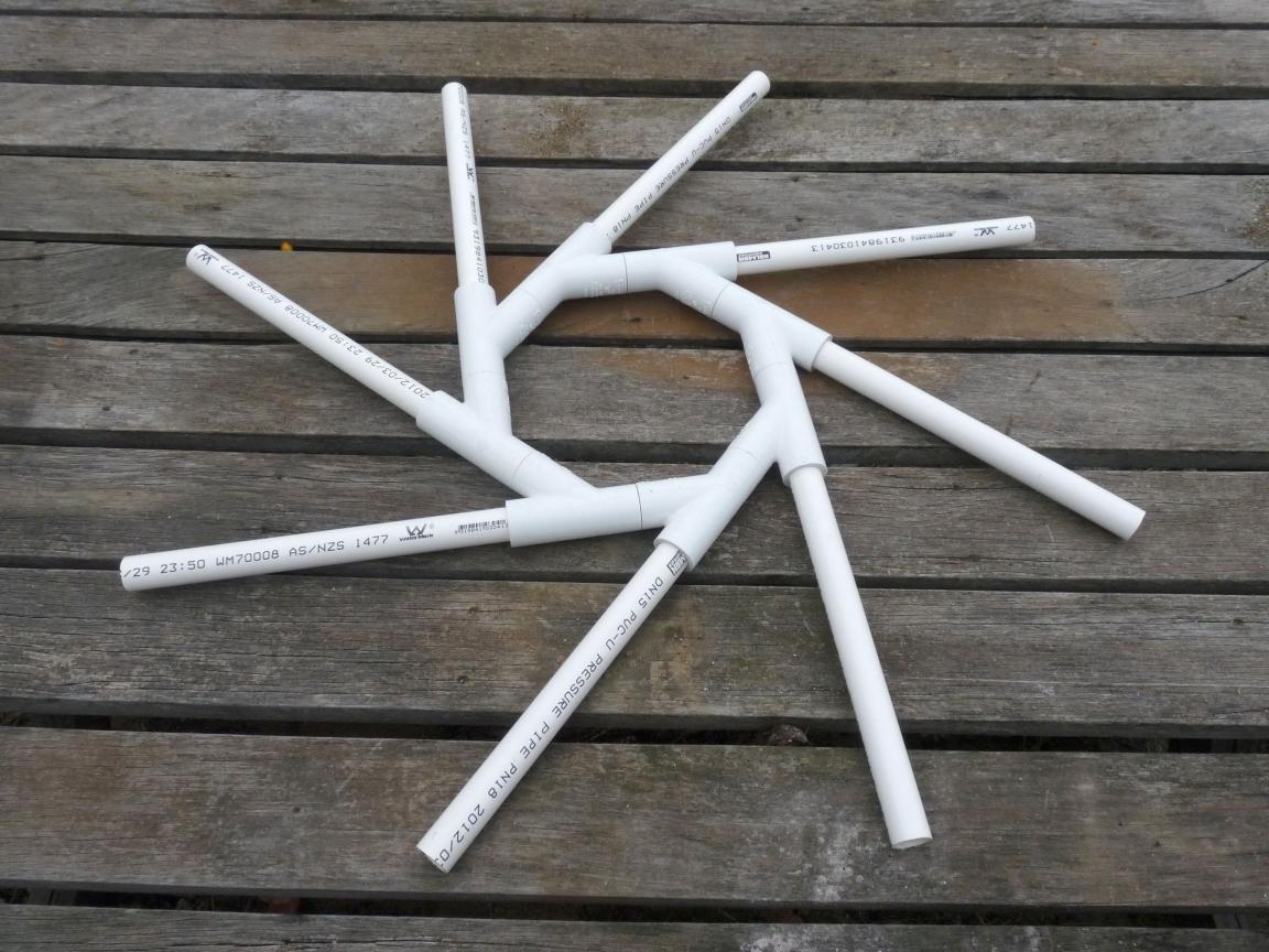

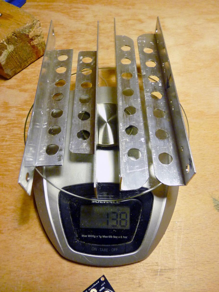

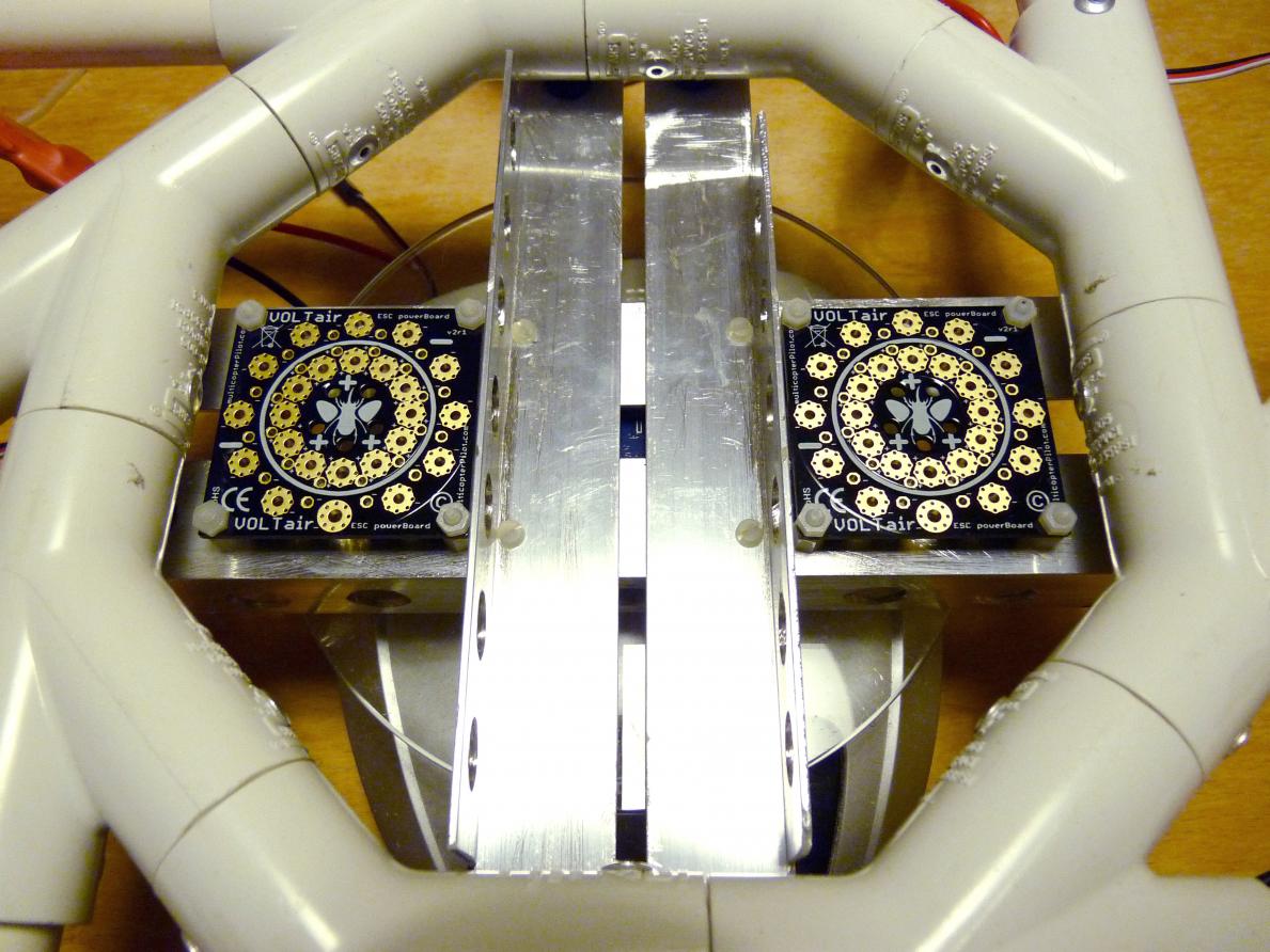

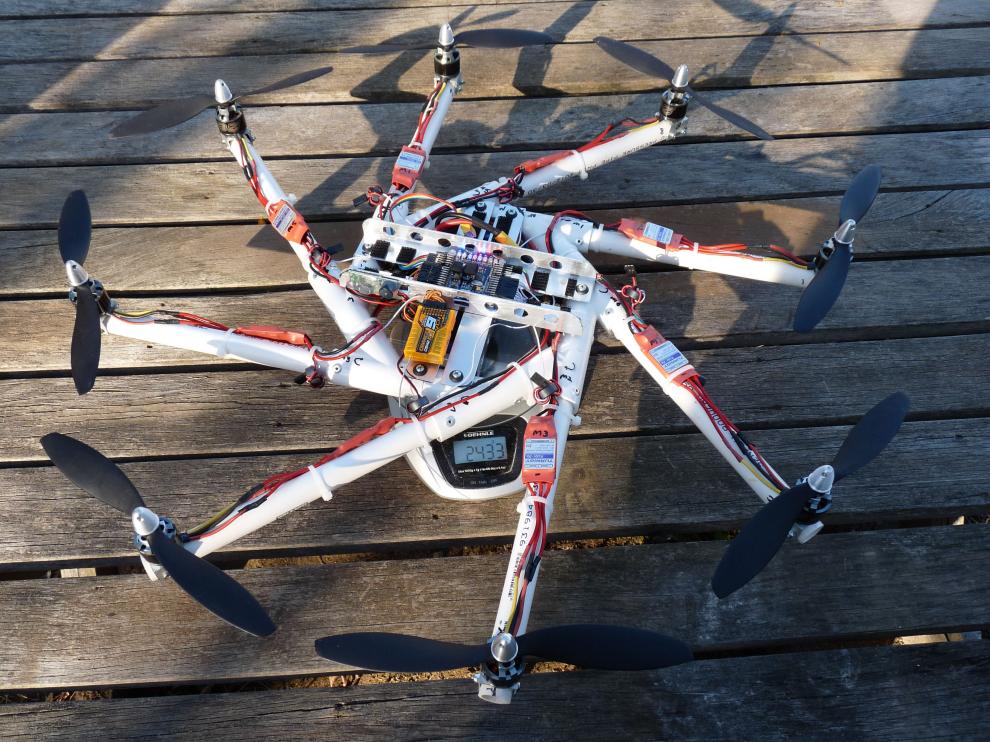

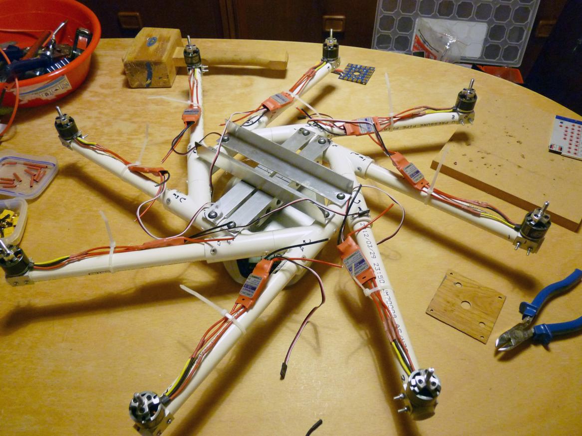

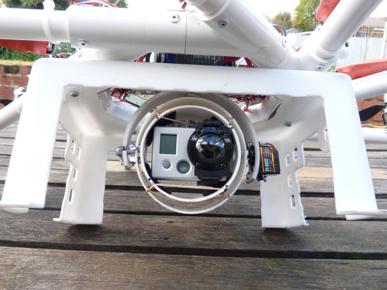

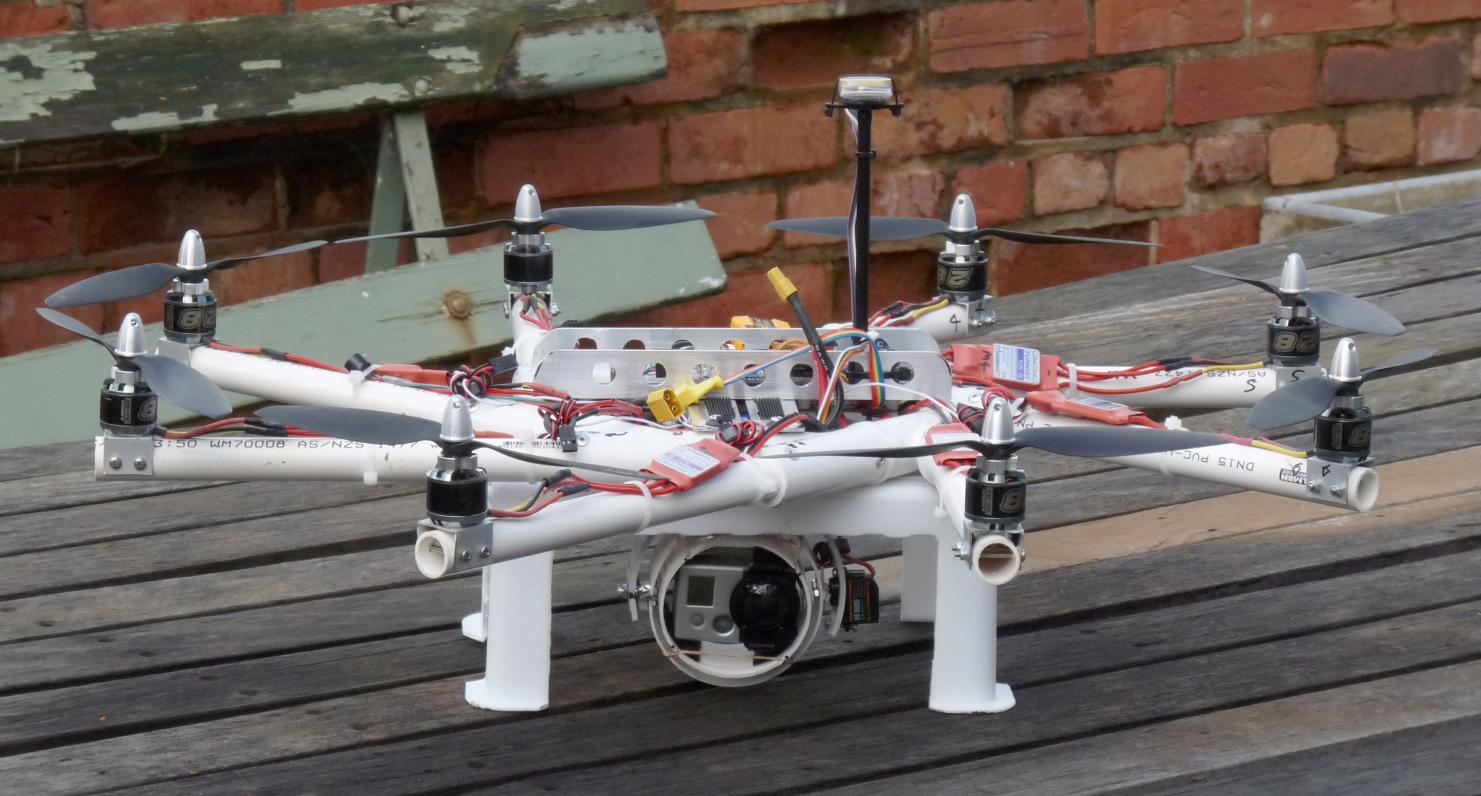

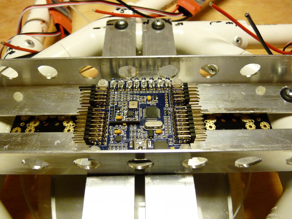

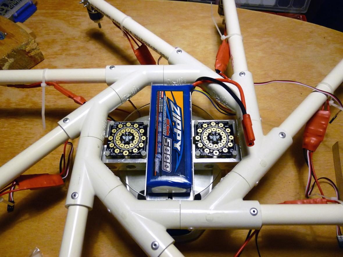

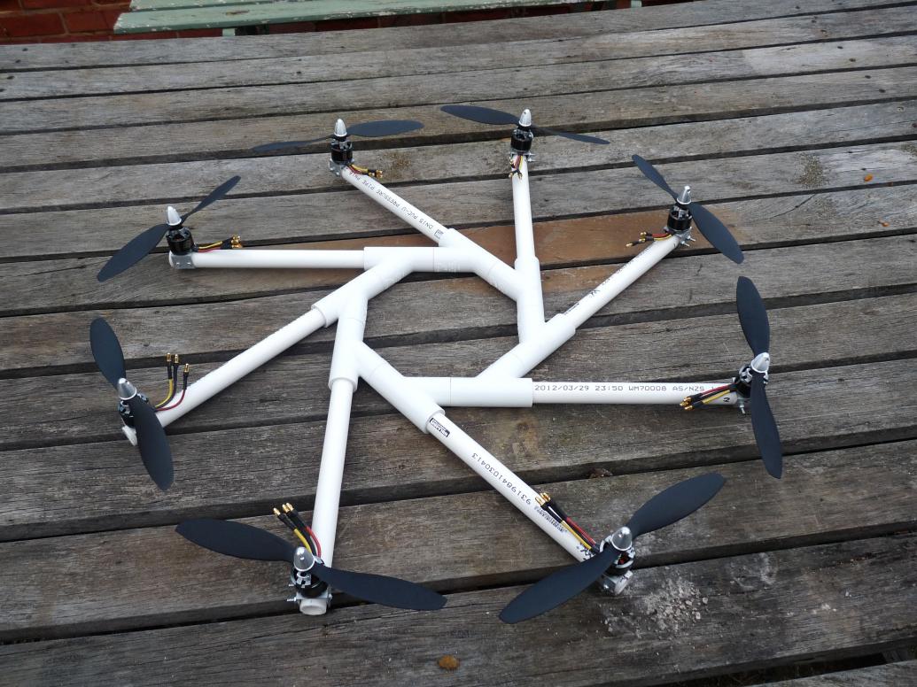

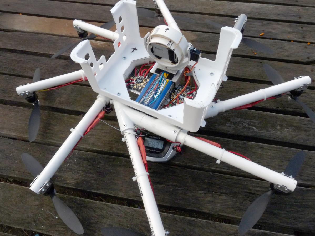

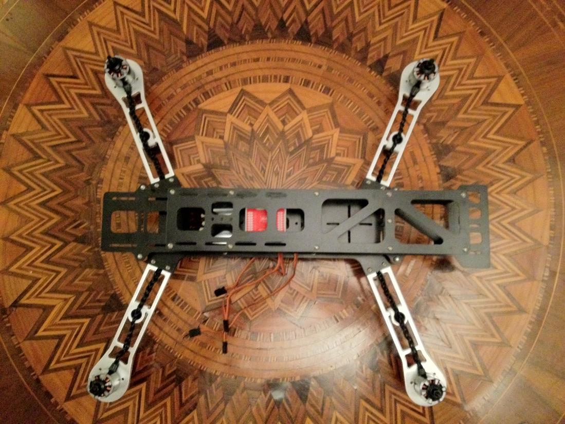

Another DIY project I have been working on.
Using:

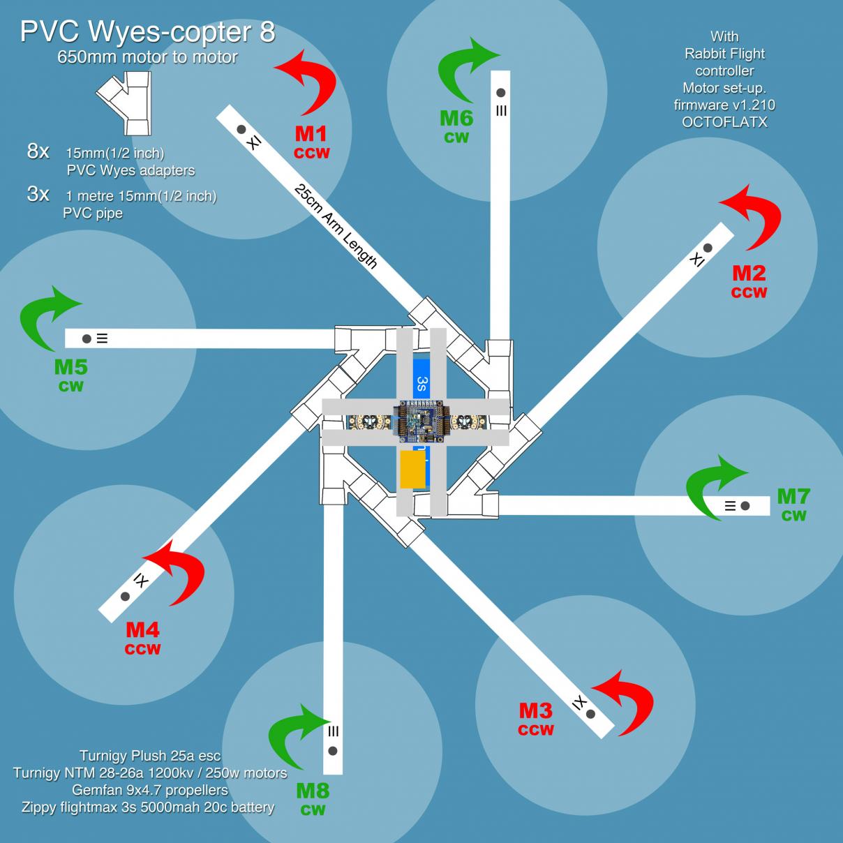

8x PVC Wyes 1/2 inch Adapters.
And PVC 1/2 inch Pipe for the Arms.

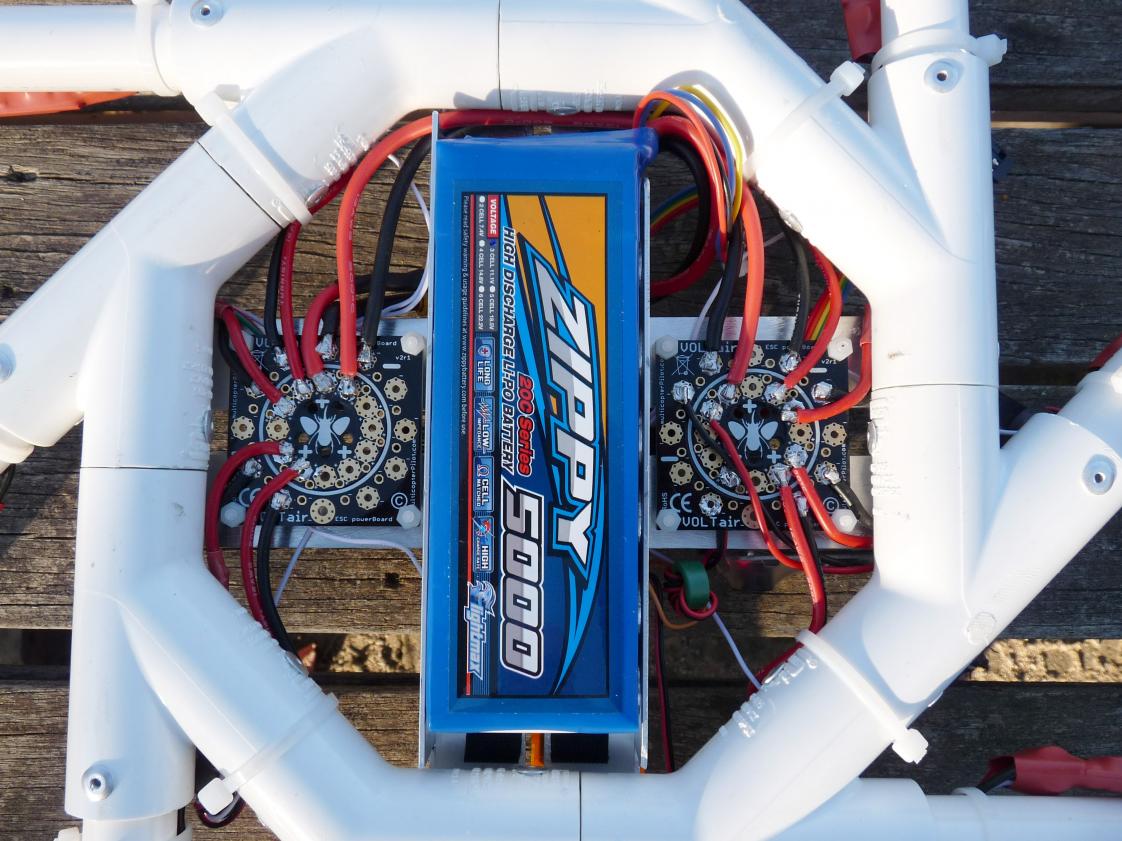

FCB: Rabbit Flight Controller
Motors: Turnigy NTM 28-26 1200kv
ESC: Turnigy Plush 25 Amp.
Propellers: Gemfan 9x4.7
Battery: Zippy Flightmax 3s 5000mah 20c

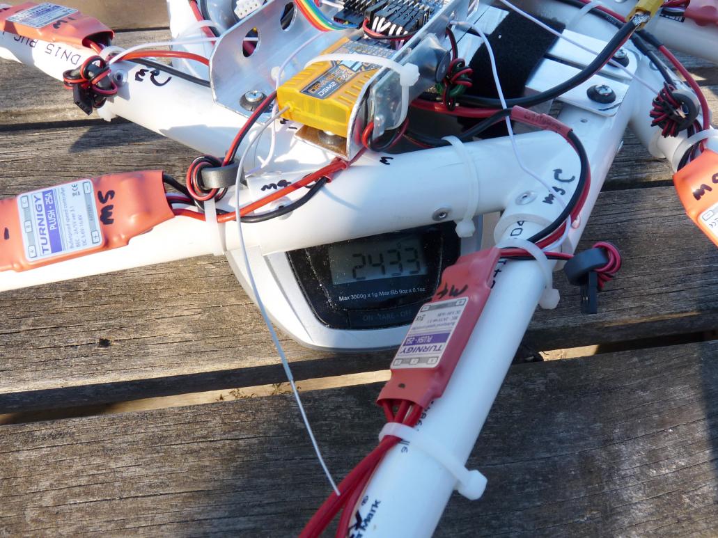

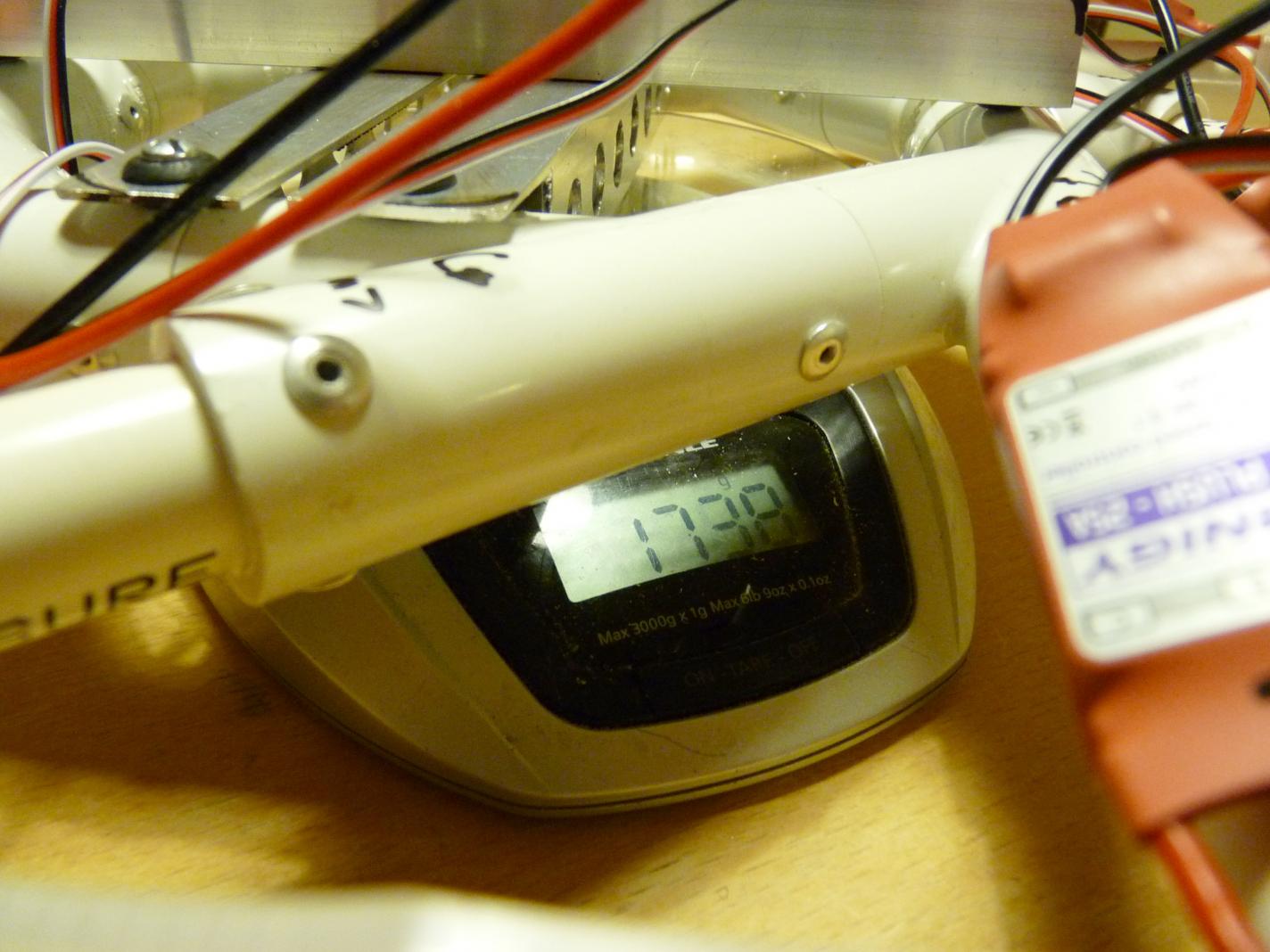

Total Flight Weight: 2433 grams
Flight Time: 9 minutes.
View attachment 5069View attachment 5070View attachment 5071View attachment 5072View attachment 5073View attachment 5074
View attachment 5075View attachment 5076View attachment 5077View attachment 5078View attachment 5079View attachment 5080View attachment 5081
View attachment 5082View attachment 5083View attachment 5084View attachment 5085View attachment 5086View attachment 5087
View attachment 5088View attachment 5089View attachment 5090View attachment 5091

I had no luck finding the 1/2inch Wyes in Australia. I end up getting them from the states.
From http://flexpvc.com/cart/agora.cgi?product=PVC-Wyes-45degree they only cost $1.20 each. (Though they hit me about $45 in freight.) So order plenty.
The PVC arms from Bunnings for about $8.
The aluminium I got from Bunnings for about $15.
The Rubber grommets from Bunnings for $10.
The Aluminium Rivets from Bunnings for $5
The Screws and Nuts From Ebay. For $10.
So all up it cost me about $55. If you don't include the freight content.
