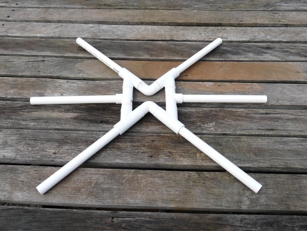

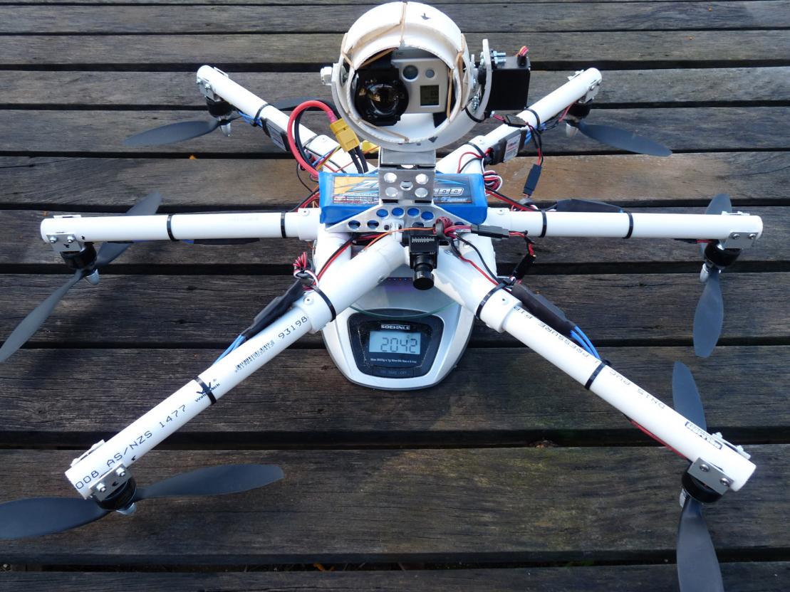

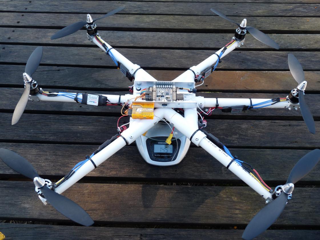

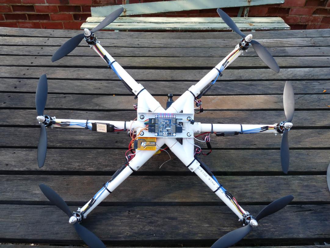

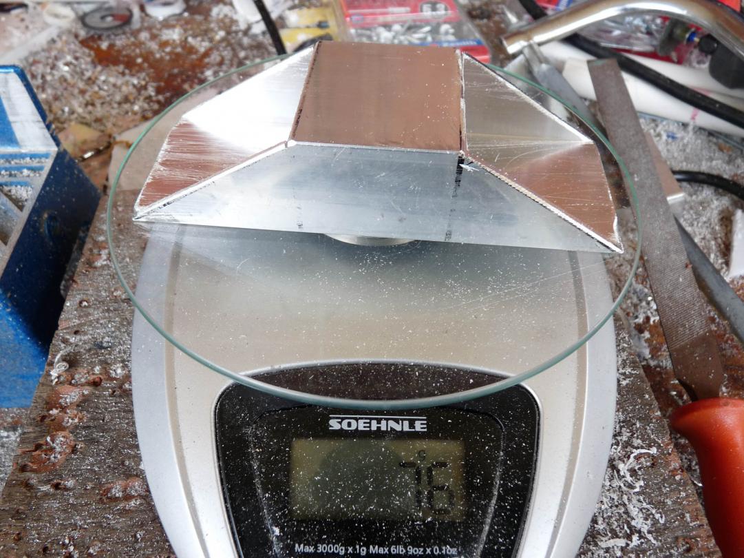

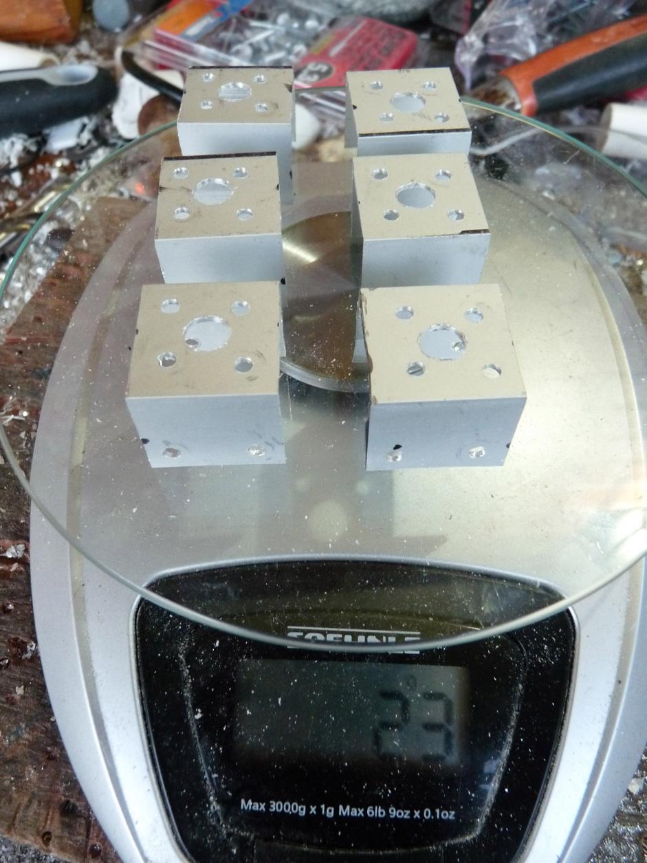

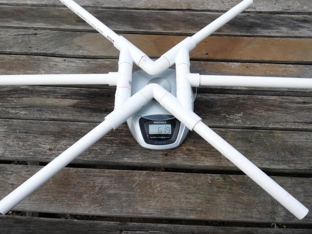

I given up on this frame for now. Didn't like its flight characteristics. wasn't symmetrical enough. Concentrating on this build.

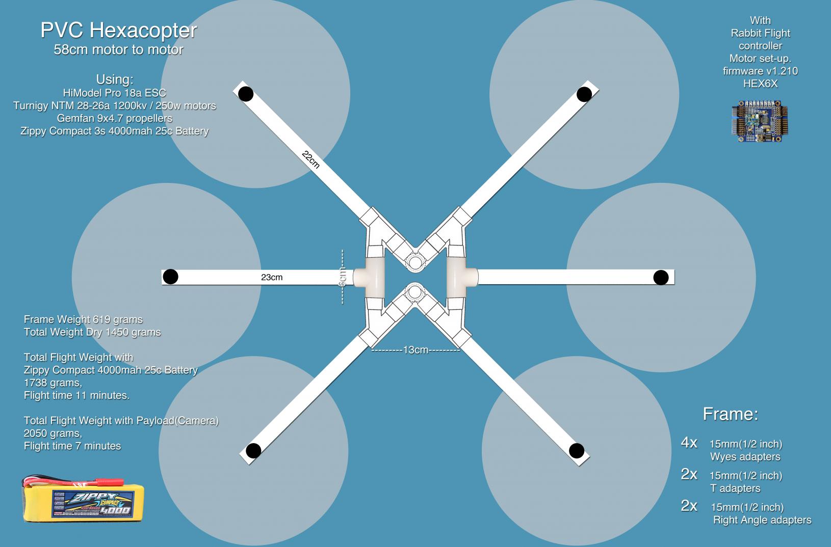

After making a PVC Quadcopter and a PVC Octocopter.
Now for a PVC Hexacopter.
Made from: (1/2inch) PVC adapters and pipe.
And Using:
Rabbit Flight Control Board.
NTM 28-26 1200kv Motors
Gemfan 9x4.7 propellers
HiModel Pro 18s ESC
Zippy Compact 3s 4000mah 25c Battery
Flight Weight 1738 grams. (No Payload)
Flight Time 11 minutes. (No Payload)

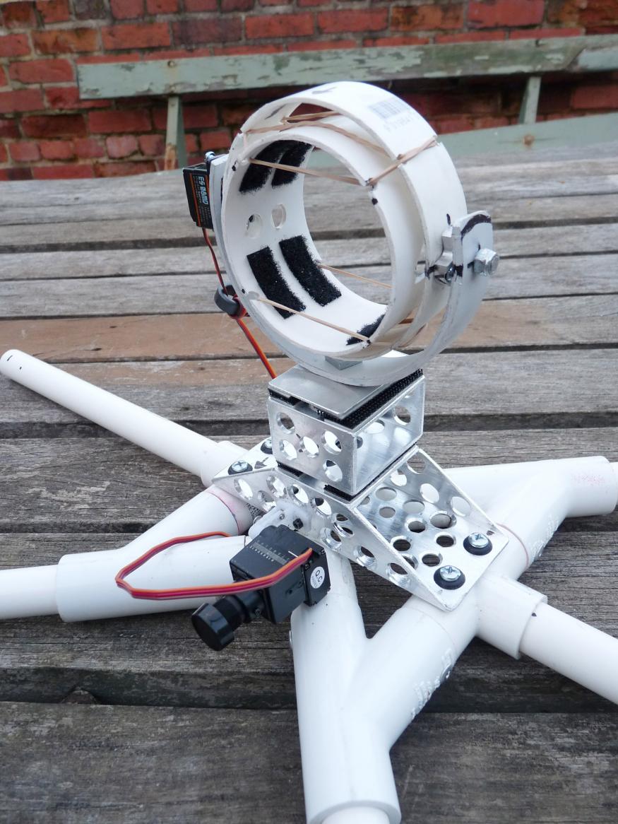

Flight Weight 2050 grams (With Gopro and Tilt Mount)
Flight time 8 minutes (With Gopro and Tilt Mount)
View attachment 5454View attachment 5455View attachment 5456View attachment 5457View attachment 5458
