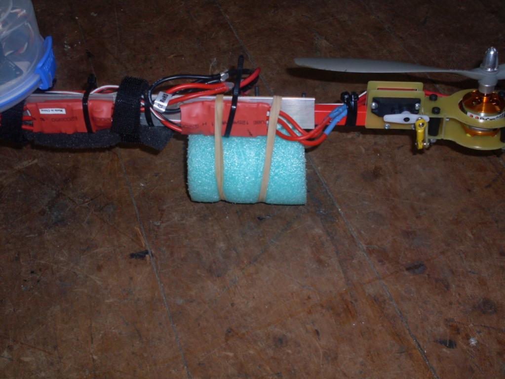

35mm by 1mm aluminium angle for the frame
Quadframe Yaw setup
2.2kg digital servo

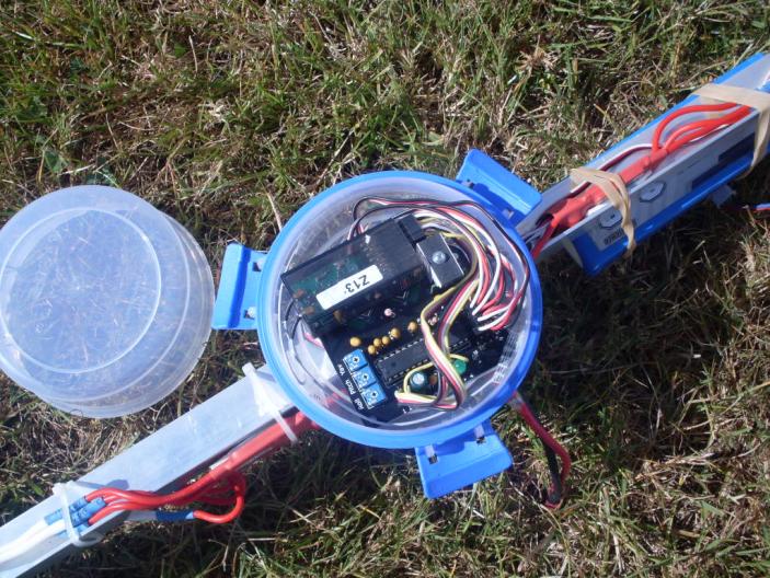

Running all three ESC BEC's linked together
control by FrSky 8 ch reciever and Turnigy 9x Transmitter
Stabilisation KKuk controller with 3 Gyros.

Tricopter uses the rear rotor for yaw control, does this by using a servo to vary the side thrust, not by differential prop speed.
Upside - in theory yaw control is fast and positive
Downside - moving part to break and when applying yaw control, pitch is affected due to the whole rotor

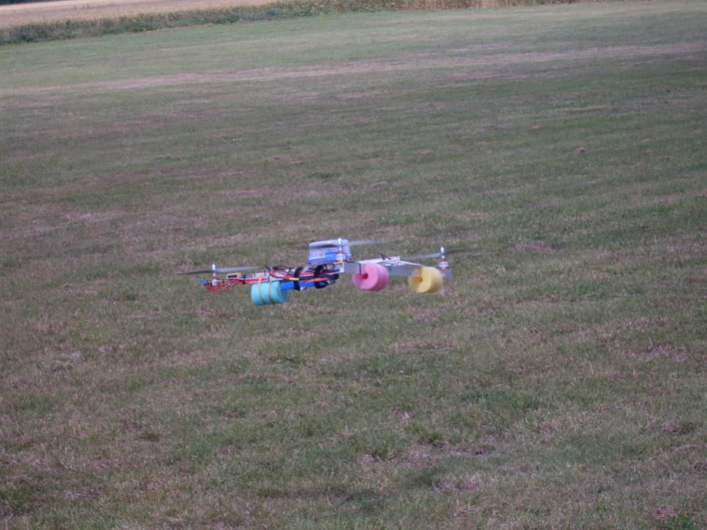

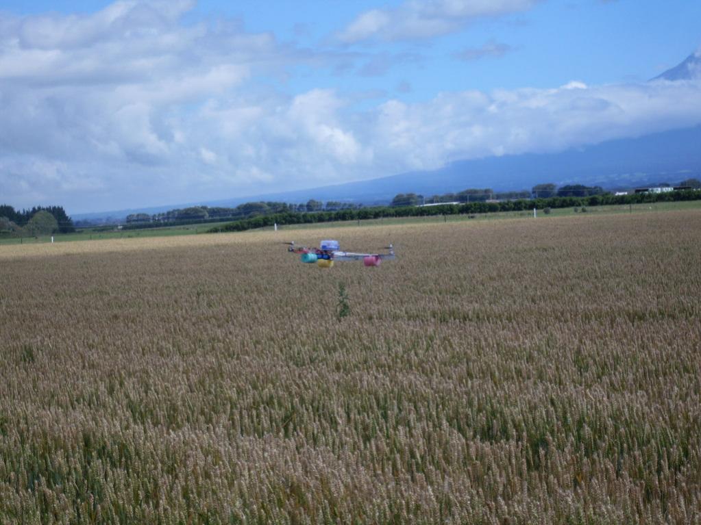

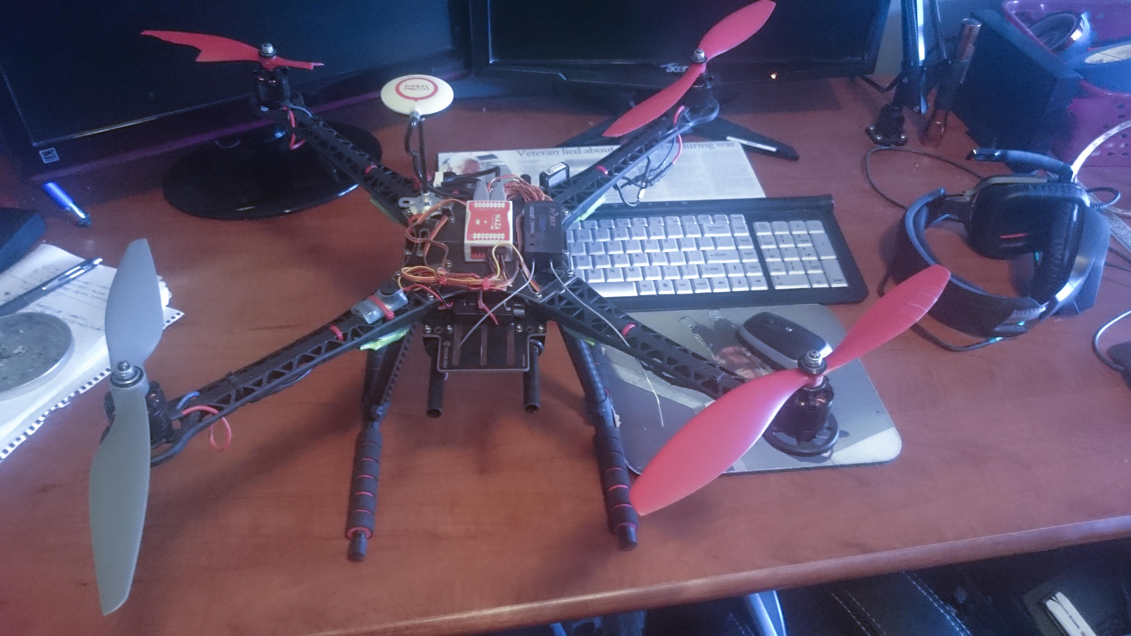

Rebuilt
Rebuilt and flying !
got 6 flights in today (and a total of 8 for me flying multirotors)
5 flights on 3S 2600 mah, but did the last flight on 4S
the flycam 925 motors and apc 10.3.8 props were sweet on 4S, the only diferences were - 45% throttle to hover as opposed to 60%, much quicker response - the gyro gains on roll and pitch need to be reduced, it oscilates when on 4S
all up weight is now 1130 grams, after reducing the overall size from 900mm to 660mm
I am still at the "oh look, i can hover" stage :)
