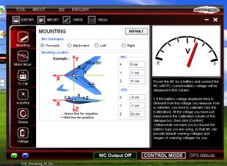

I think you have a problem wtih the voltage monitor, "disconnected" is not normal.
