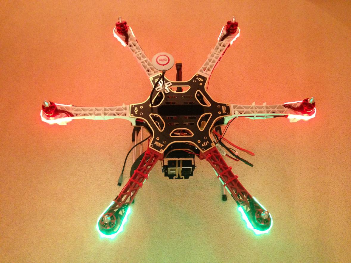

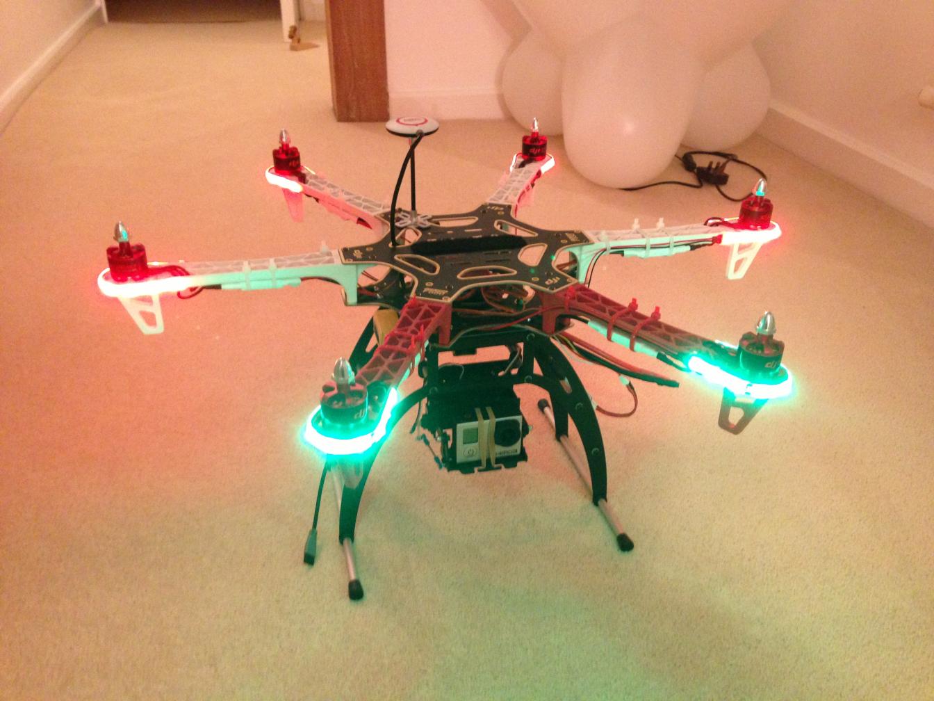

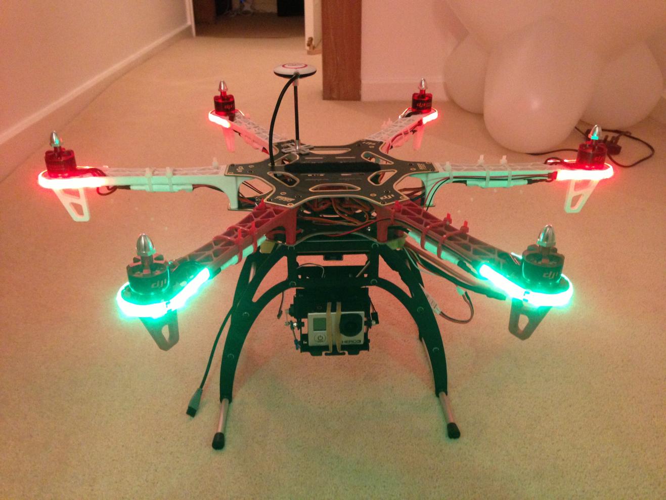

HobbyKing 12v LED strips, $5 per meter. VERY bright! I was flying last night, and had a car come from almost a mile away to find out what it was. ..hahhaaa
They run off 12v taken from the flight pack's balance tap.. SUPER bright. They light up the quad so nice. I am going to order more in different colors. You can cut them to length and just solder the strips to each other. Nice stuff.

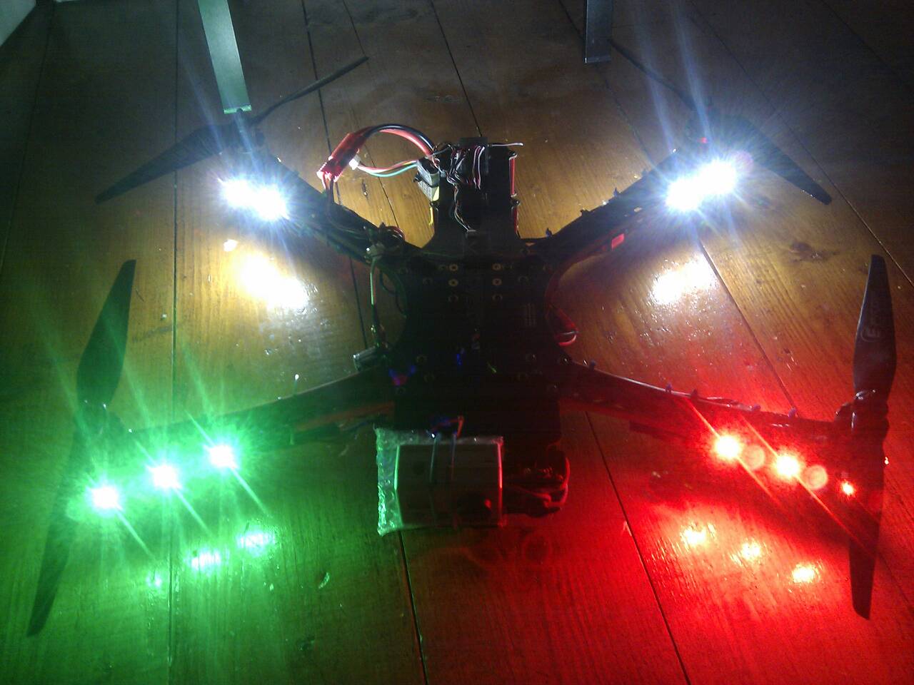

I'm using Turnigy LED strips that came from HobbyKing a year or so ago.

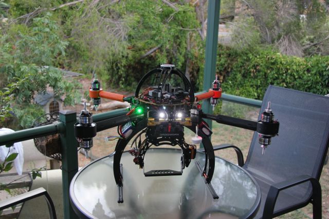

Hey fredor - Jaycar Electronics sell LED drivers that will run 4 x 1watt LED off 4/5s flight batteries - damn bright too!!
I bought 1 watt LEDs off e-bay for $4 per pack of 10!!! I used Jaycar mini heatsinks to mount them on as they do get hot.
Happy to provide links to suppliers (and part numbers) if you like :)
