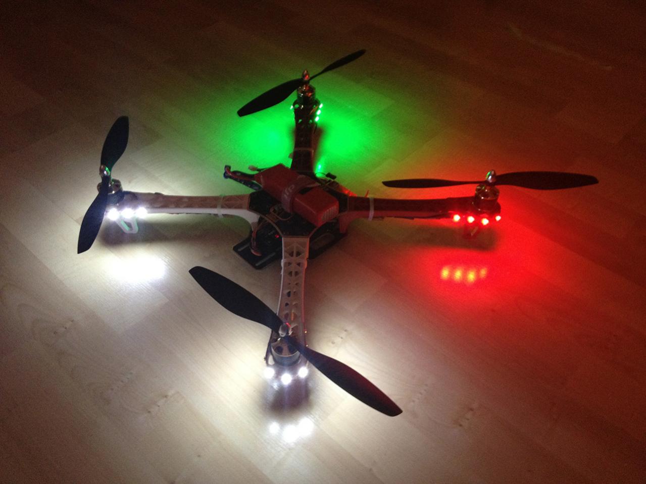

I have some led strips from hobbyking and made this. The leds are soldered straight on the power-board.
No channels or switches needed.

Fransvh
like to have super bright lights since my vision isn't that great.
My vision is also not so good. I have to look good at the craft and it's easy to loose orientation because the shape of the craft doesn't change in flight.
I put on lights to see the craft more clear. Also have white/red/green leds in FAA-style for better orientation.
The lights will also improve your flying.
