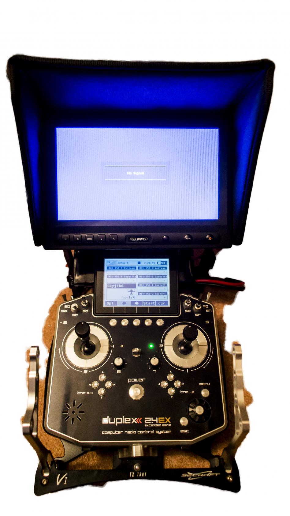

I've got a jeti DS16 the pots are a simple add on to the sticks just had to solder 3 wires onto the board on the gimbal, pretty much plug n play. With the jeti you can also have any type of switch in any position on the transmitter, I've added a safety locking switch for my fail safe switch.

Very clever (and simple)
Wish Futaba had something similar.
