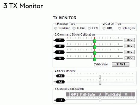

Now that is a good idea. I have an older 8-ch Tx that I converted two of the proportional pots ("knobs") to 3-position switches, and one concern was that I could accidently switch to Manual on the GPS/Atti/Man switch, and was looking at somehow disabling the "Man" setting with programming. So it looks like one can select the "intermediate failsafe" setting using the Tx "endpoint adjust" and have it "ignore" the Manual setting. Here is a clip from Page 15 of the Naza User's Manual, the Control Mode settings are at the bottom:
I was just reading this part today, and *bing*, your post made something click. This can be a complex first-time set-up and I'm taking it slowly.

And why is "failsafe" inserted between GPS and Atti, and between GPS and Manual in this screengrab from the Naza user manual (item #5)?
--Bill

Thank you sir, that Epiphany still stands. As I said, I have a concern about bumping the switch to Man and panicking as the plane goes bonkers in Manual.
Now to dig in an conquer the next issue. Never have had a failsafe function activated in my Tx before and that is new territory, expecially interfacing it with the Naza.
Yeah good question. I too was wondering about that. Any ideas ??
