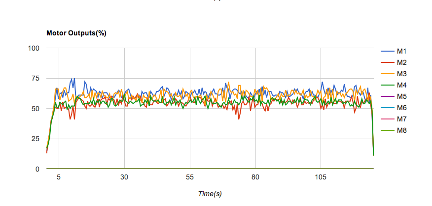

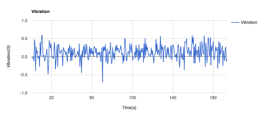

fltundra

I do know what you are talking about, that is why I am asking for some interpretation, I want mine to look like yours, by the way they look pretty nice, I want to tune mine to make them look better. I am not sure if the problem is from the gains or if I have a problem with an ESC or motor, I am not sure how to interpret a bad efficiency not necessary a full failure of an ESC or motor. I want to rule out that something is not working properly. If components look good, we can move on to the gains, any ideas on which gains to tune?

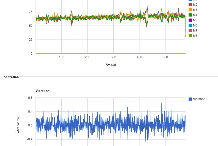

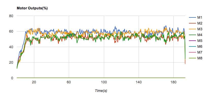

In case you can't see the logs, here are some pics…

fltundra
You need to get you center de-tent on the gain knob a 20% and work on getting those props better balanced after you realign the motors.:)
Your total throw should be +30 to -30 on the gain ch. Once you get them balanced, your going to want to raise the gains a little. Mainly roll and pitch.

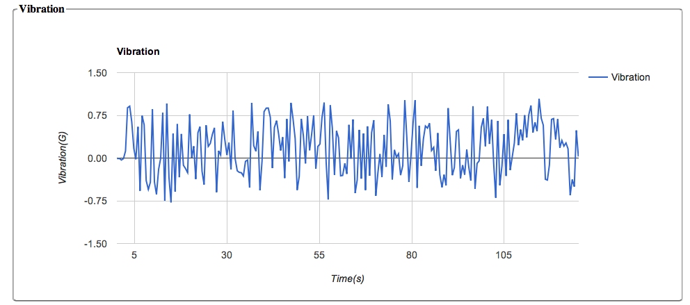

Hello Guys,
I did some new flights, here is the result…
I double checked props and they were very well balanced, then I checked motor alignment as Kloners video, at first site they all looked aligned, but for my frame I tough that it was not so precise, so I did a 4 point calibration using an inclinometer and I found out that I had one motor slightly bad aligned, about 2 to 2.5 degrees the problem was that this 2 degrees where to the opposite direction, like -2 degrees when other motors were like +0.5, I guess if the error was to the same direction like +2.5 degrees it would probably vibrate less… anyway, I re-aligned motors and also I reprogrammed the ESC to Dynamic Braking, and now vibration is under 0.5, so I guess that this is more reasonable, I know I can still fine tune the gains, but right now it feels a lot better. Also today was a bit windy so I didn't wanted to mess with the gains, I went with the rule (if it is working, don't touch it).
I believe that main problem was the motor alignment, but also updating the firmware and using a dynamic braking helped a lot to get a smoother feel of the flight. I didn't tough that the SuperX was this sensitive, now I know to consider motor alignment as a priority.
Here are a couple of logs from todays flight, please let me know what do you think I can fine tune. I am however pleased with the result and I really appreciate all your input and support. I hope I can help you guys as you helped me, thanks again!!
Todays logs:
http://log.xaircraft.com/report.htm#2015_09_01_165214.750_21.1.03.13
http://log.xaircraft.com/report.htm#2015_09_01_165214.750_20.1.05.58
If you want to compare with the flight before motor alignment and Dynamic braking, here is the log from before:
http://log.xaircraft.com/report.htm#2015_09_01_165214.750_19.4.02.05

Motor alignment still can be better. And when you say the props are balanced, what are you using to balance them?
Go4d
Hello Fltundra,
In regards of motor alignment, it only has an error of 0.4-0.2 degrees in just one of them (M2), other 3 motors (M1,M3 and M4) all have same degrees with an error of 0.1 to 0.2 degrees (1/10th of one degree),…. I don't think that I can get them closer to a zero, this because I use a very thin washer between motor and frame to adjust level, the washers are very thin but if I use another one it will overshoot the degrees, and there are no thinner washers for this, so for now I will have to leave it there, I think that it is very close.
In regards of the props, I use a Dubro prop balancer and a magnetic balancer to double check, in both cases balance shows perfect, I balanced all props in six points (tips and hubs), so props are perfectly balance.
I really don't think that the issue here are the props, or motor alignment anymore, if there is a problem of balance it would probably be motor balance (bad shaft,etc), which I have not checked. But these are new KDE motors, so I guess they are ok.
The other problem could be that the frame is not stiff enough, I am using a X650 frame, also new, but I insist that it is not a prop problem.
In your case how much vibration do you have on your drone? can you post a graph to check it out?…..thanks again!!
