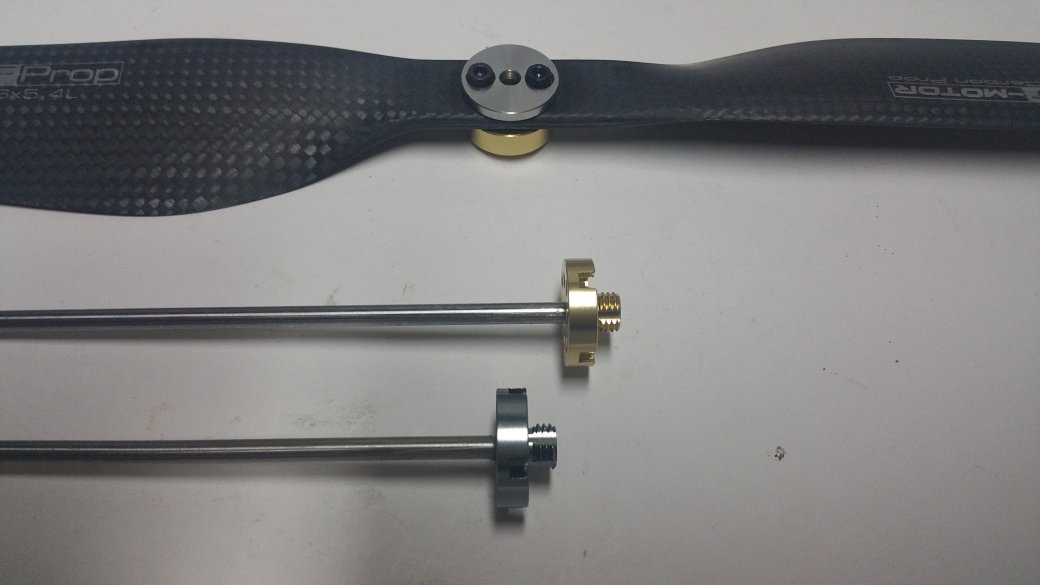

Here is my solution:
Mount the quick release prop adapters to the prop using 2 x m3x10 screws and a dab of blue loctite and tightened to 15 in/lbs.
I made these 2 adapters with the male portion (motor half) of the quick release prop adapters. One for LH and one for RH thread.

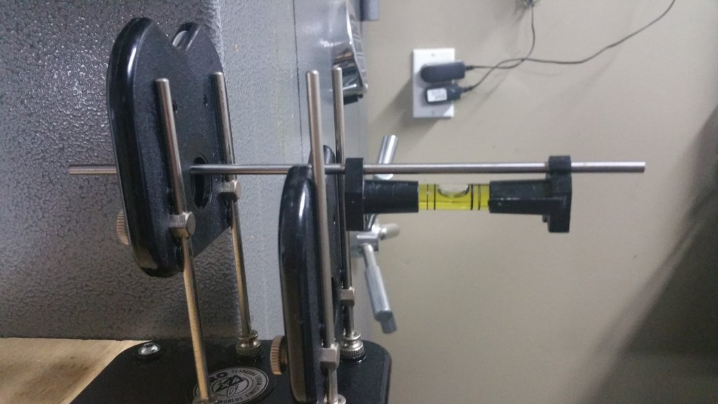

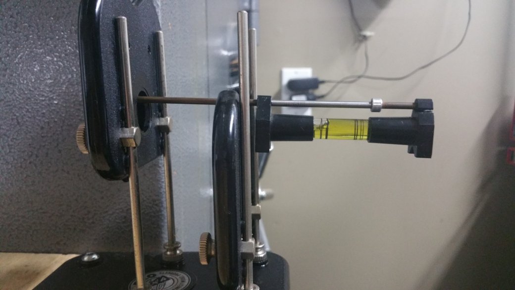

Now I toss her on the dubro. Please keep in mind always to check to make sure you have a level shaft and adjust the dubro if necessary.
This is a pretty important step to get a proper balance. This dubro rod is .025" smaller than the adapter rod I made and look at how much it throws the level off. Not being level can make your life hell.

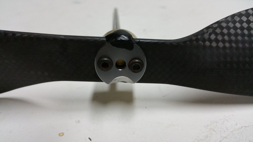

So at this point I balance side to side first. Then I find the heavy side of the hub. I use my dremil and put a small notch in the top washer on the heavy side. Less is best. Take a bit off and check on the dubro then take a little more until she is perfect.
Now, not only is the prop balanced but the assembly as a whole is.
