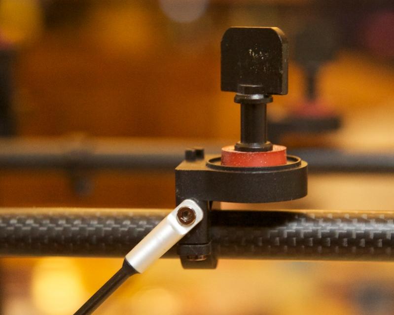

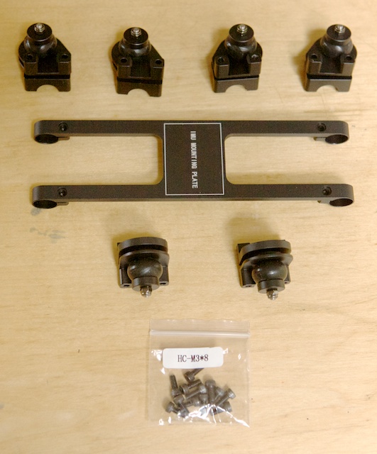

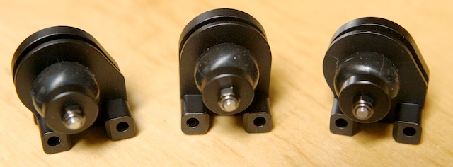

View attachment 11304View attachment 11305View attachment 11306View attachment 11307
I just got a package from China. I had not ordered anything so I was a bit surprised.
Well it was straight from DJI. And it contains the new vibe dampening system. I had replied to their request for testing the kit. And I had emailed them as well as talked to Patrick at ArealMediaPros about this kit.
It looks really nice it is very light and should not take long to mount. I will photograph assembly as I do it.

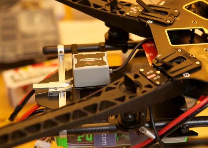

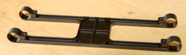

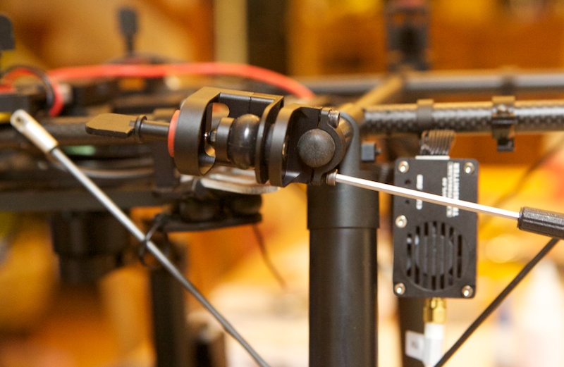

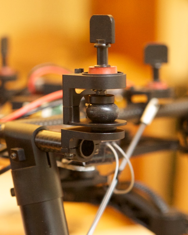

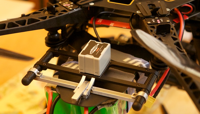

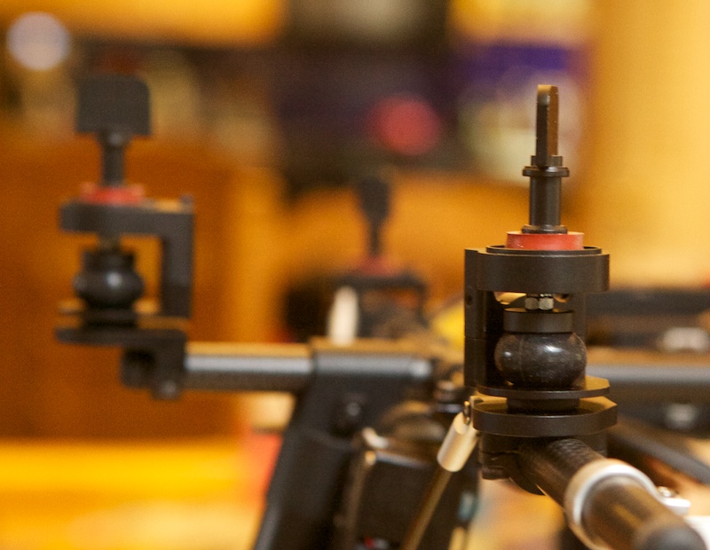

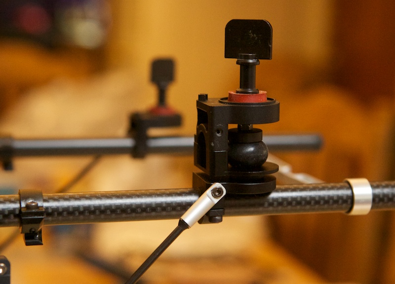

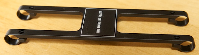

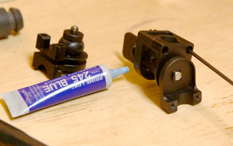

Assembled it last night, took about an hour, quite simple, just a lot of screws to be removed and re installed. Takes a lot of thread lock. I replaced any screw that was really tight to get out.
You have to spend some time figuring out what mount goes where, the easy way to do it with the solid legs is to use the braces to mark the position of the connectors. A pc of tape on the carbon rod will help as well. I use Gyro tape to fasten the IMU in the new position.
I had to move my battery plate back a bit, but the CG is still good, I moved my Lipos back on the plate, I just repositioned the velcro dots on the Lipos a bit.
Test flights this afternoon if all goes well. I will input the new location of the IMU in the Assistant first.
Here are photos of the installation process.
View attachment 11321View attachment 11322View attachment 11323View attachment 11324View attachment 11325View attachment 11326View attachment 11327View attachment 11328

Although I too am interested in these damped fasteners, in the interests of further isolating the camera mount from the airframe, there is one aspect that I am not happy about and which puts this modification into the 'Bandaid' category. With the standard method the booms are attached to the centre hub with the curved swivel clips and are then rigidly supported by the Bi-Pod fasteners. They are attached in two places. Very secure.
This secure fixing has now been reduced to only the centre hub swivel clips because the booms will now 'float' on the Bi-Pod fasteners, potentially allowing them to flap even more.
Unconvinced.

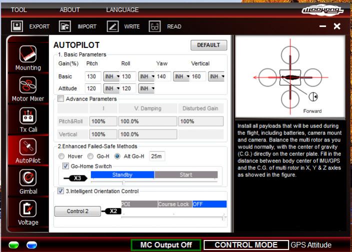

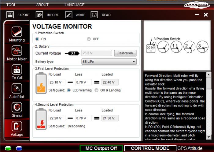

Had 2 great flights with the new anti vibe kit. They were perfect in every way. I am putting the video up on Vimeo as I write this (it is direct export from FCPX so it will take a while for Vimeo to convert).

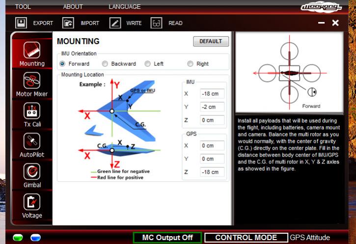

Here are the settings I use in assistant:
View attachment 11333View attachment 11334View attachment 11335
I am still on 5.20 it works great for me as did 5.16 and 5.18.

The Screen grabs from Windows got shrunken by multirotorforums somehow I will try to reupload.
View attachment 11339View attachment 11340View attachment 11341
