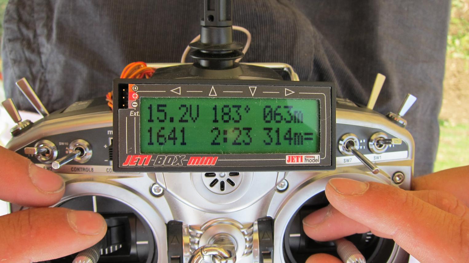

For taking photos, I can yaw as much as I want. I can barely see the craft at this altitude (300 meters). It's impossible to recgonise the nose of the craft. So, best way to understand which direction the craft is facing is to look at the compass values. If you noted the degree when you landed off, you just yaw until you reach your compass angel. Then you can maneuver in the direction you want.
If I want to descend, I just switch off AH and move my throttle stick just below the hover point. So it starts to descend slowly without loosing coordinate.
Or, I just trigger Come Home function when the AH is on. Copter just hovers on the taking off position. Then switch off AH and start to descend slowly.
I try to watch the altitude meter on the Jeti Box, I avoid descending very fast. Ot's hard to understand if it's falling down fast or slow. 1 meter per second is quite enough and efficient for descending.
