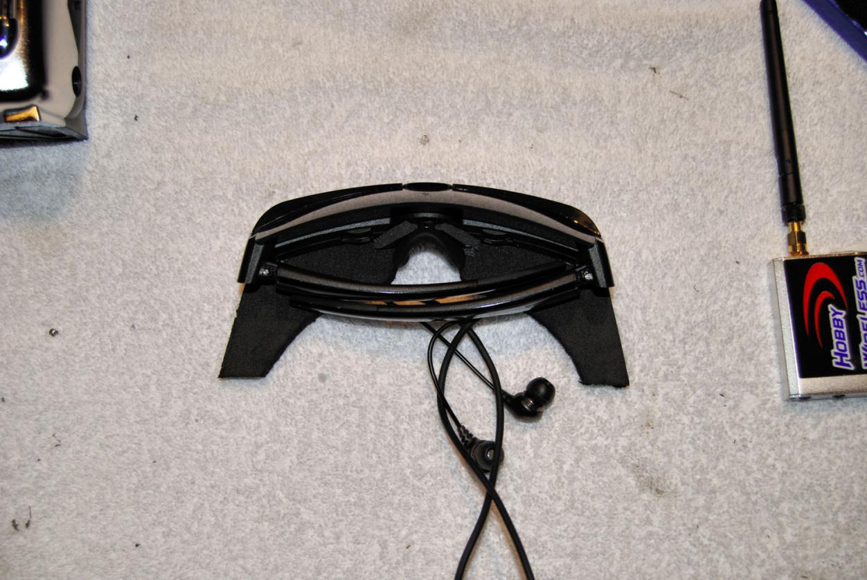

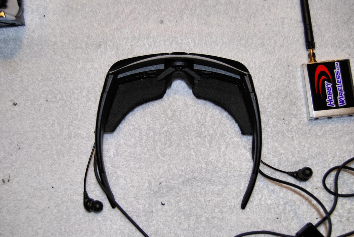

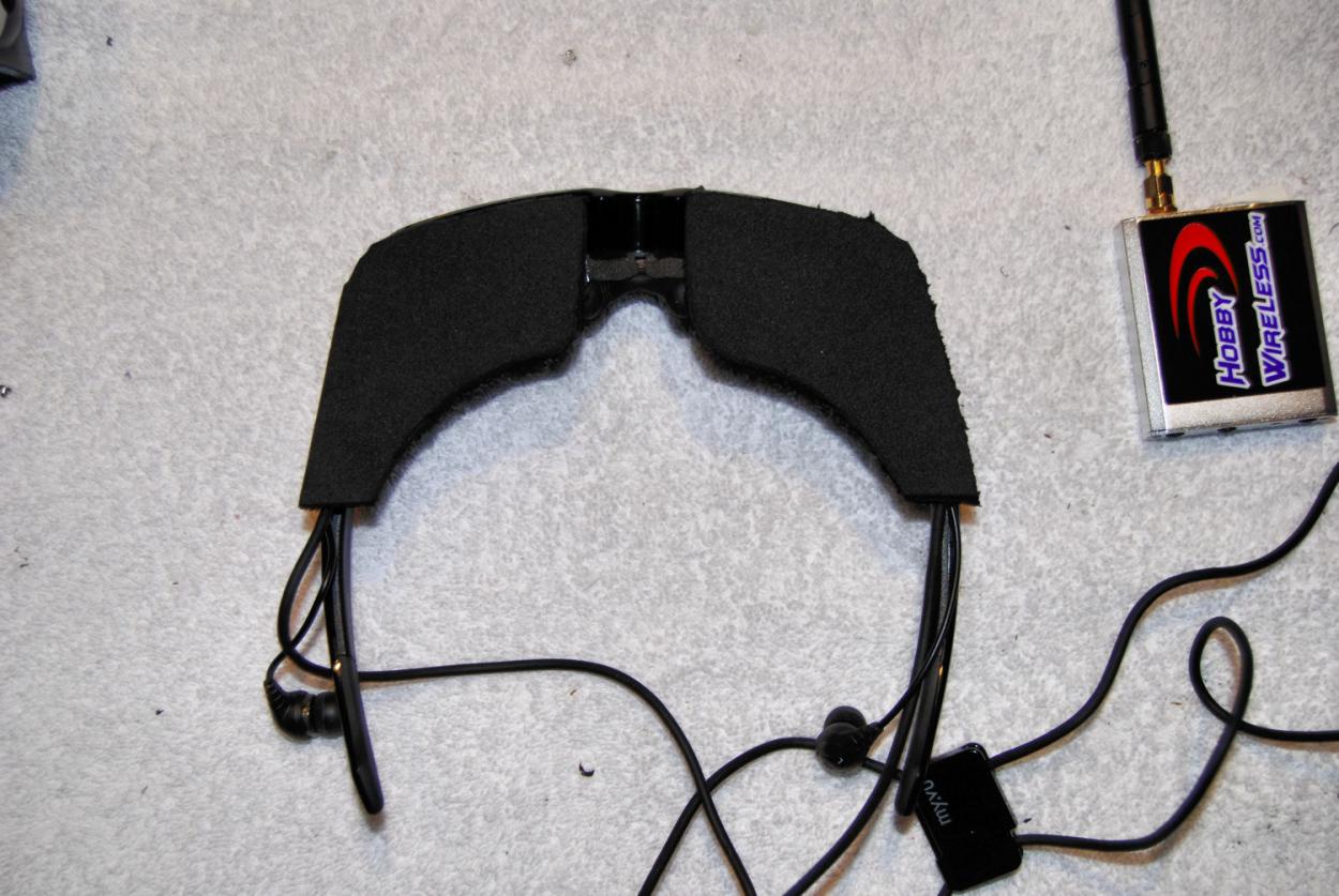

I fixed them...:)
Turned out to be a very simple thing to do, I took a fairly large piece of 3/8 inch thick antistatic foam I had hanging around, the closed cell kind that's fairly stiff when you try to bend it and usually comes in the packaging of new circuit boards like a video card for the desktop computer, and cut two pieces to make filler panels.
To make the fillers I laid the MYVU glasses on a pad of paper and traced the outside edge to get the general shape for the outer edge. From there I took the Fatshark goggles and put them over the tracing and used the inner edge to get a rough shape of what the inner edge needed to be. I then cut the paper template out and did a trial fit to the underside of the goggles and the curve of my face with the MYVU goggles sitting where I need them to be on my face, the template was very close and only needed minor trimming. Made a couple adjustments with the scissors and when I was happy with the shape I used the template to cut two pieces out of the foam.
Next I took some double sided servo tape and put a piece on the bottom of the goggles on either side of the nose piece and after trimming the tape to fit I stuck the foam filler panels to the bottom of the goggles. Just gave them a try outside and that seems to have done the job fairly well, I can clearly see the screens even when looking towards the sun and in every orientation I tried the view was pretty much the same. It's a bit late in the day now and the sun is a lot lower in the sky than it would be at midday so I'm not going to say it's 100% until tomorrow when I can get outside earlier to see if I get the same result.

Here's what the filler panels look like...
