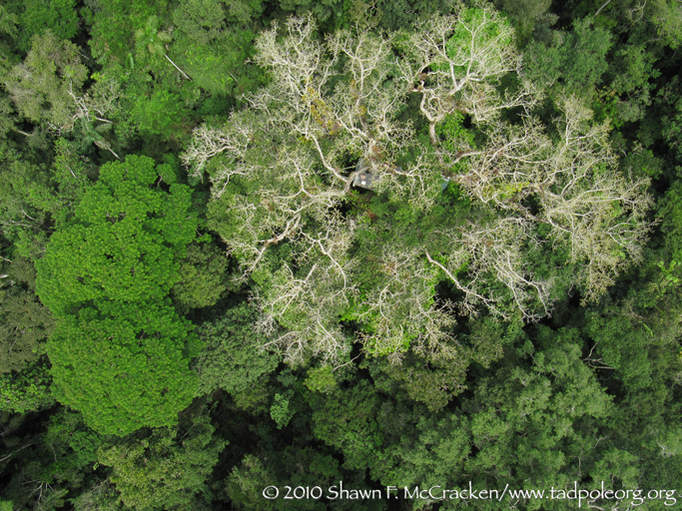

Here is an example of an image I took this past summer in Amazonian Ecuador flying my QP hexacopter from a canopy tower. Look near the upper center of the pic for a white square, that was my launch pad and I am standing just above it. This tower is 150' up in the tree.

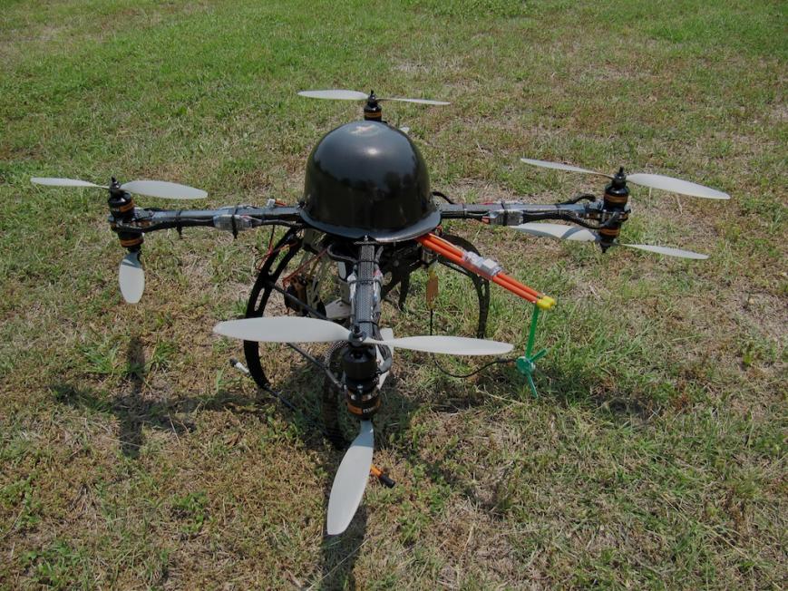

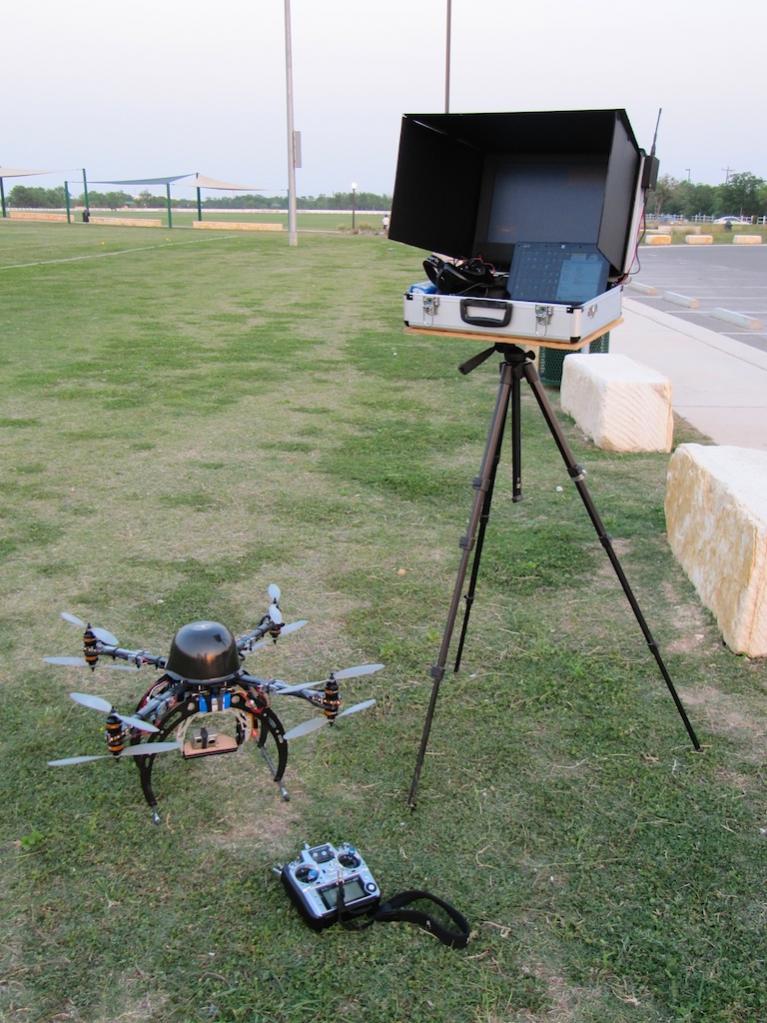

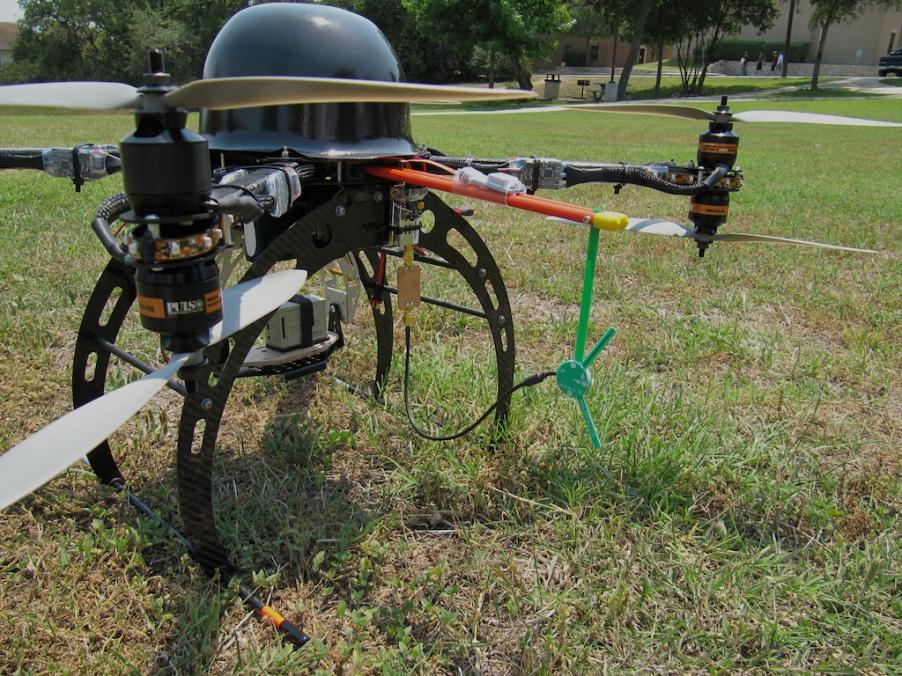

Here are some pics of my current X8. I have a build log over at RCG in the Hoverfly forum (hope you mods don't mind me linking to there): http://www.rcgroups.com/forums/showthread.php?t=1380528

Very interesting Shawn.
BTW, On your downlink, I can see a filter from OMM/Rusty and an inverted V antenna. The particular V antenna you have is poorly designed. Talk to the guy who brought those into the FPV world - IBCrazy on RCgroups. He's going to say that the antenna lead should come out the back of the V at an angle. Then he may tell you to get a circular polarized antenna.
Here's his new site: http://videoaerialsystems.com/products/transmitter-antennas/
Good luck and welcome to the site.
PS. Your hood looks just like an old helmet I use to wear. ;)

Hey Crash,
Ya, I am not happy with my video downlink performance at the moment. I am using an LM 1.3ghz 1000mW vtx with two LM vrx's (stock antenna's) through the Eagle Tree EagleEyes ground station with diversity and I have flown a max of ~500-700' away and it can get glitchy at times. I really want the BluBeam set from Alex's site but they are sold out right now. I have tried the stock LM vtx antenna too and it is worse. I think that might have to do with CF blockage.
That hood is from Hobby Lobby. It is a kid's army helmet that was camo when I got it. It's super light, tall, provides good protection, and I think looks pretty good. Glad you like it!

Welcome Mactadpole.. this site is getting as diverse as your studies.. Great to have you on board and I am sure there will be questions from members on here to you about your set up. As soon as I saw your ground station I thought of a few. I have to get off to work now.bummer! but will jump back on later as ask you a few..
PS as soon as I saw that dome I thought of Crash! strange that..

It's raining in VA so he's probably hard at work making new antennas. It looks like they are in stock now. He also makes them for ReadyMadeRC btw.
I ground tested my Skew-planar antennas to 1/2 mile in terrible conditions. Well outside of radio range for my Futaba 2.4Ghz.
In your case, you may want to consider an omni and a helix antenna on the diversity box. That way you get the best of both worlds. Omni coverage and directional range. Ask Alex though. He knows his stuff and does the real world testing (or playing depending on how you look at it). For longer range, two helix antennas on the ground station would be better. For short range, two omnis spaced apart at different heights would be better.
Either way, your Vee and panel antenna WILL collect dust. I don't think a panel antenna will work very well in a tree anyway. I think they need a ground plane to work well. I'm not sure about the helix antennas.
Oh, there seems to be some 'conflict' with the lawmate radios. OMM says they work with the Skew-planar wheels but Alex hasn't had much luck. I'm not sure if that was ever resolved.

I really want to get the Blubeam's because they are a little cheaper and I know someone who has them and they are really well built. These are the ones that are out of stock everywhere. Alex posted that the problem he found with Lawmate was his OSD and he fixed it with a resistor I believe. He posted that he thinks it should work fine for others and a couple people have posted that they work fine with their Lawmate's.
I am really interested in thoughts from others about what antennas they would use if they had my particular setup. As I said, I am using the Lawmate 1.3ghz 1000mW vtx with two Lawmate 1.3ghz vrx's hooked up to my ET EE ground station for diversity. Since this is a multirotor and for my work I don't see needing to go further than 1-1.5 kilometers. What I most concerned about is multipath resistance due to trees.
My current plan was to try the Blubeam cloverleaf on the copter, Blubeam skew-planar on one rx and a "virevent" or cloverleaf at different angle on the other rx. Any thoughts?

Fire away when you have a chance. I have made a few changes to it recently but still looks the same. I purchased one of these: http://www.geeks.com/details.asp?InvtId=BLK-VRD-MC6-FB-R
It's awesome! WAY better than the EasyCAP.
