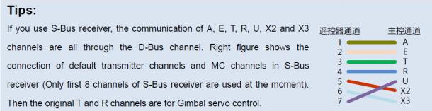

Not got around to re-doing my camera gimbal since swapping to
Futaba and S-Bus.
But when using S-Bus are the channels for gimbal control now
using the original ports T & R ?
Tomstoy2
Hmmm, I'll try that! Somewhere I read that, too, but also read that is was when using for octo use. Makes perfect sence now.
If all else fails, read the damn directions,,,,
Tomstoy2
Yep, wire traditional it worked fine. After s-bus, servos powered but no stabilization.
Tried all kinds of different settings.
Gimbal on.
DaveM
Sorry not sure then.
If I get time later, I will hook mine up and check to see if
it is as before.
DaveM
Just re-checked mine after transfering to Futaba and S-Bus
All working as before on ports F1 & F2 on a quad
