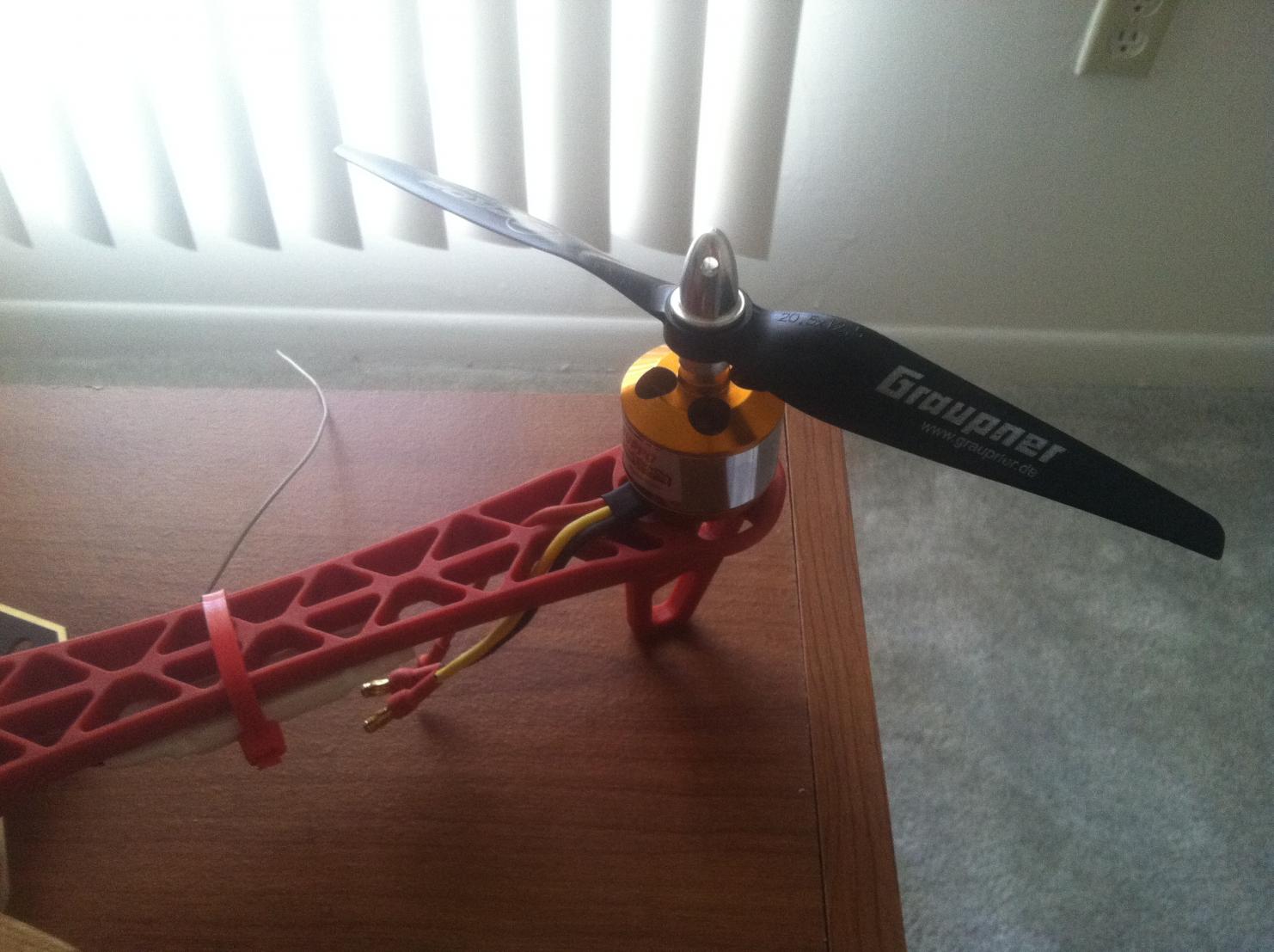

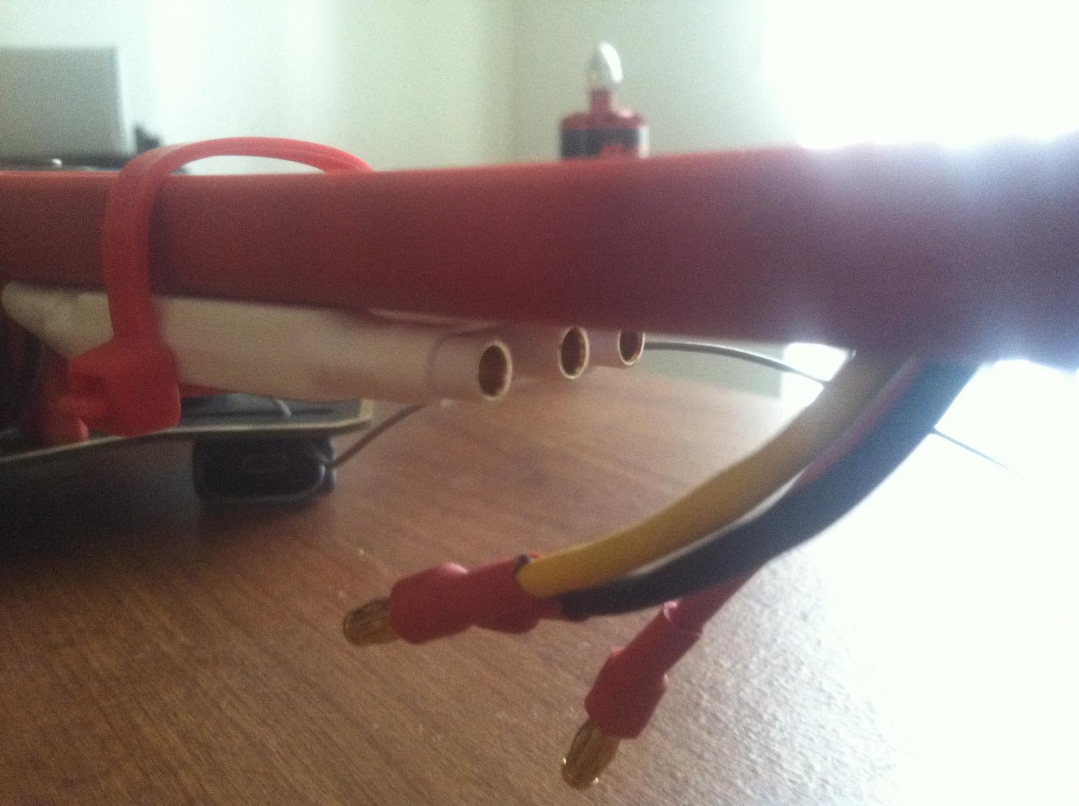

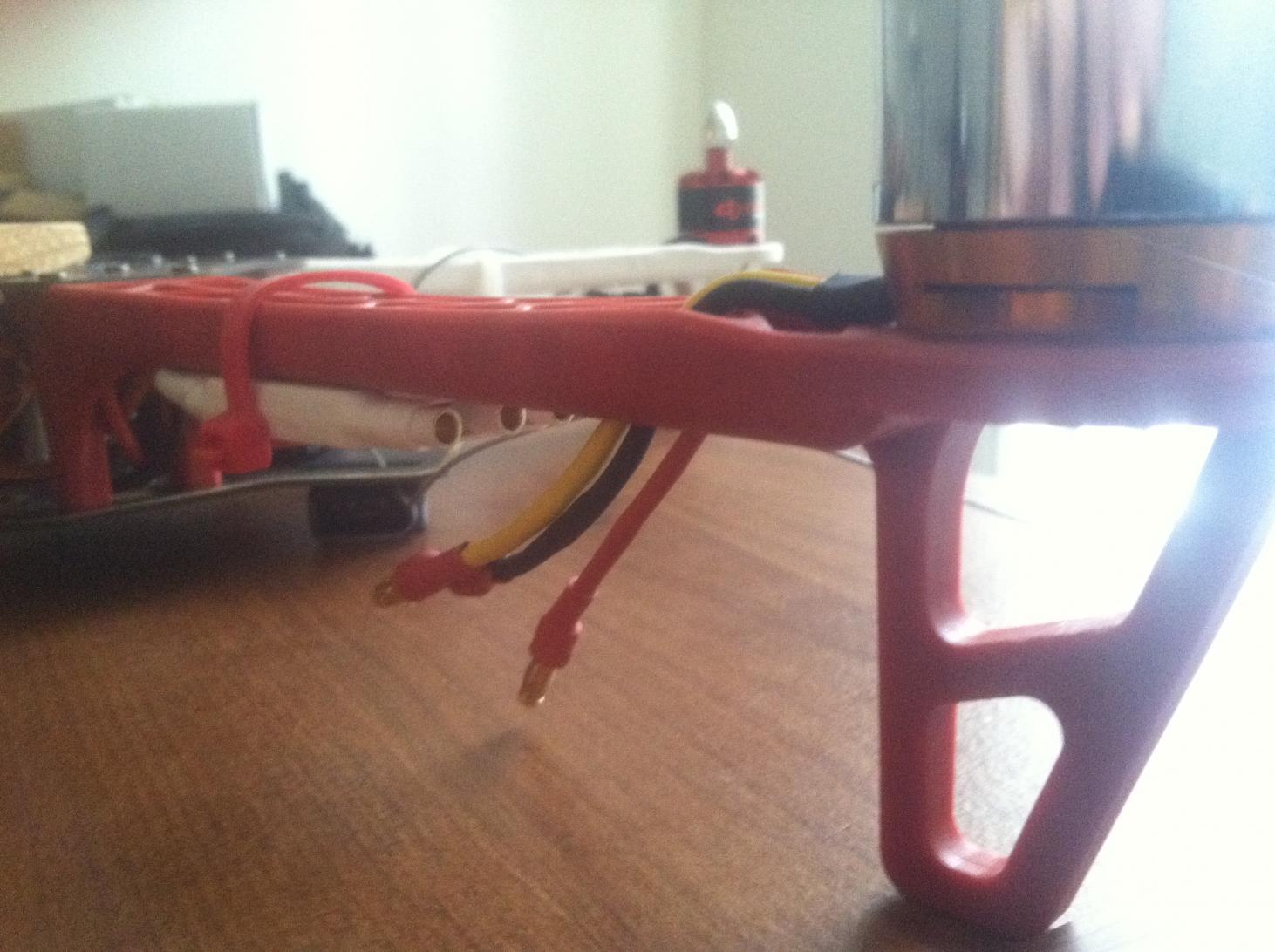

plug the bullets into your esc, when you get your motors (w/o props) spinning to change a motor direction, unplug any 2 and switch them around, can't help ya on the antennae.
this one shows it pretty good. there is a common link between the side the power goes in and the power goes out of them and the direction the motors spins. this is plugged in to spin right for a naza. note the color the reds line up and blacks line up versus the opposite two sides that have a black lined with a red and vice versa... i always put yellow int he middle so this works. I build a few of these and i always look up at the last ones orientation and it always works
Make sure to double check the motor rotation before you put the props on......
dont assume the decals are one side or the other, they were redone..... look at the red and black coming off the frame and which side they are lined up with the motors wires... i hope i said this clear enough, if not, i'll make you a vid.... lmk
Your looking at the bottom

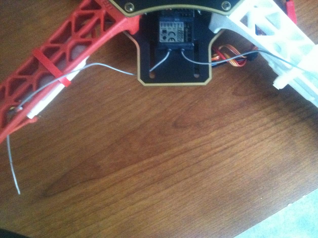

on the receiver wires you want to get something like gold n rod or antenna pvc from the hobby shop,,,,,, use a contact adhesive like goop and make something like this
i.php
that'll get you the best range and most diversity

View attachment 6512same motors different positions, same rotation, it really doesn't matter what color goes to what plug but if it bugs ya...

it doesn't matter what way the wires are in,,,, but it sure makes it easier. I've gotten where i don't even look at the motor spin direction till it's lifting off on maiden.... just know from the others i copied from that it's gonna spin right

What's the black stuff on your gold n rods? Is it just black tape or heat shrink tubing?
i.php
yes, just makes it nice, not really needed
you could do the rabbit ear look too like the ezuhf guys use
up 45 degrees each, 90 degree apart up towards #3 and 4 motors
