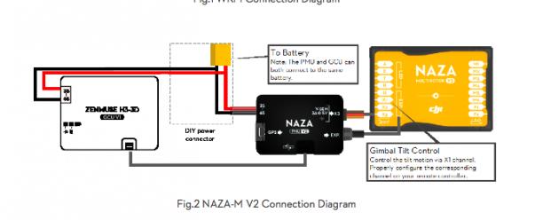

This is the wiring diagram on the Zenmuse manual. I see it has the PMU/GCU on the same power source. Does this mean the entire gimbal is powered through the same 4s battery as my motors/esc/etc?

Yes, it is.
So is this my only option for powering the unit? Seems like it will drain my flight times. I guess I need bigger LiPo's now!!

You can leave the zen plugged in for hours and it will hardly drain your lipos.

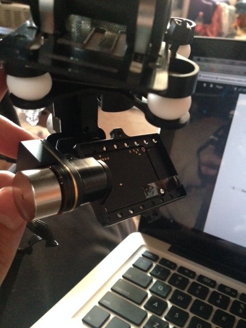

Well that's great to hear. Sadly after I ordered JST plugs with expedited shipping lol. But your info really saved my day. Now I'm at a bump in the road. Noticed I don't see any mounting dock connector on my zen to connect to the gopro? Seems like every other one I see has this installed

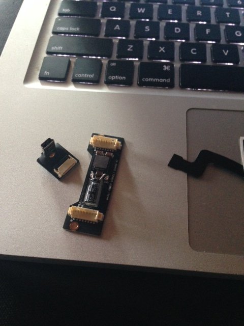

Just my luck. I'm scouring the packaging and I don't see that piece anywhere. I'm about to contact the seller but not even sure what that component is called. Here are the only other pieces in the package. Of course when it's something I need to work my Monday

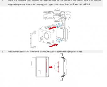

Maybe I've described the wrong piece. I have the metal bracket to secure the GoPro. BUT I don't have the input into the back of the camera.
attachment.php
The actual connector on the gimbal is not present. Therefore nothing can connect into the port on the back of the camera. Does this make sense at all? And I guess the bigger question is...can I function without it?
Here's what mine looks like. Notice no connector on the right side, yet on all DJI demo and installation videos I see a connection to the camera. Odd

Manual shows the connection going into the back of the GoPro. Now I do have the USB connection into the side, but no rear connection as shown.
I'm just wondering if it can function without the back connection for the time being. Currently I'm only flying line of sight and have a gig on the way. But I don't want to screw up my Zenmuse if it should be connected to the camera internally. Seems like it would hold the camera and I have to manually control rec/stop which would be no problem. Can't think of any other reason the gimbal connects to the camera besides for the video out/FPV signal

You need to connect the ribbon cable to the USB connector provided. That charges your camera battery. If you do not connect it you will go through the GP pattern very quickly. Look at this video. I know it is for the Phantom but what you are looking for is the ribbon cable install.
The small board you also showed is the anti-interference board. It is inserted between the gimbal and the GCU. The tilt control is the X1 channel.

Awesome! Got the ribbon cable connected to the GoPro USB. Got the GCU soldered and everything seems to power up. Now I'm trying to figure out how to make the x1 work for tilt. I'm not sure if the assistant software works on my mac though, so that may be a bump in the road. Unless I can activate this in the Naza assistant instead.
Also with the interference board should that be connected to the g8 cable instead?
