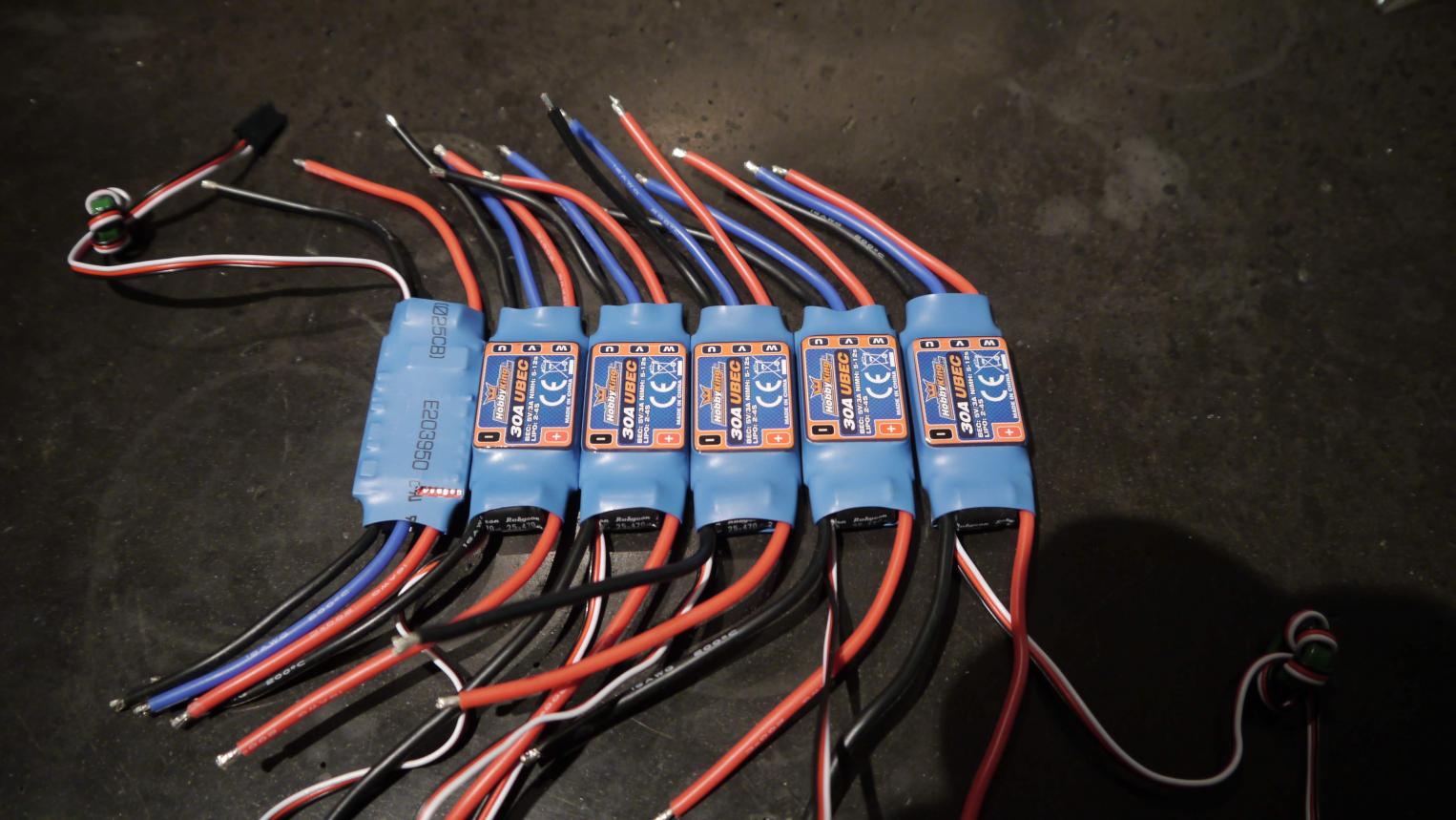

Ordered ESCs from Abusemark preflashed with simonks firmware:
http://abusemark.com/store/index.php?main_page=product_info&cPath=1&products_id=27
got the 30A right away although overkill but dimension are the same as 20A weight difference around 3 grams so no big difference.

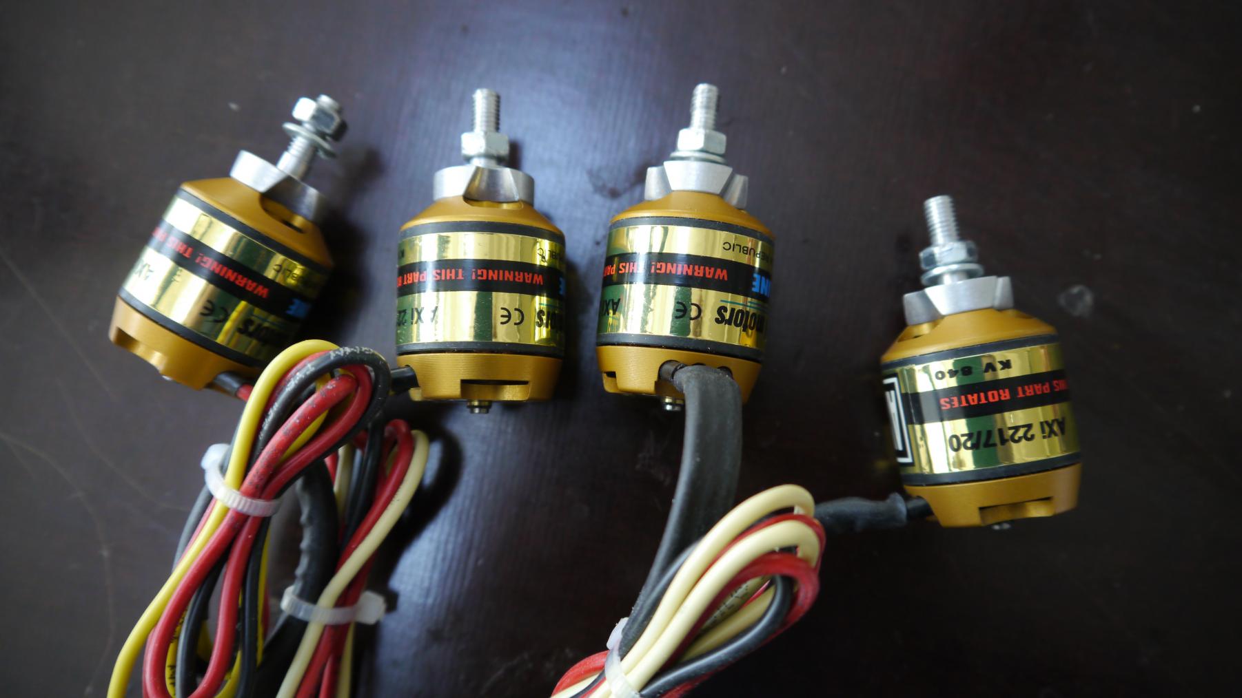

Gonna use AXi 2217/20 on the hoverthing frame props not sure yet.

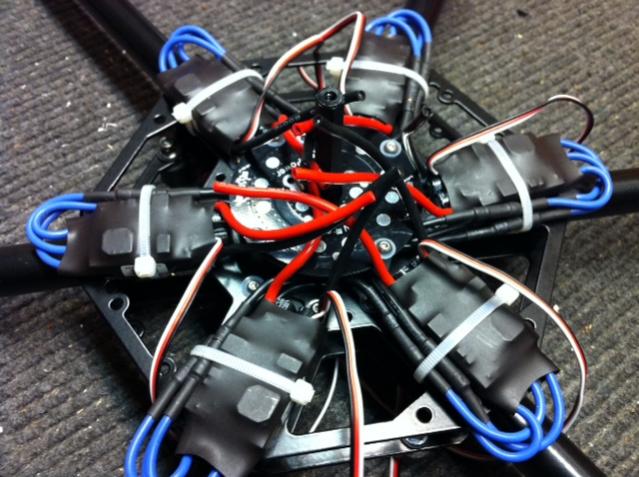

BorisS

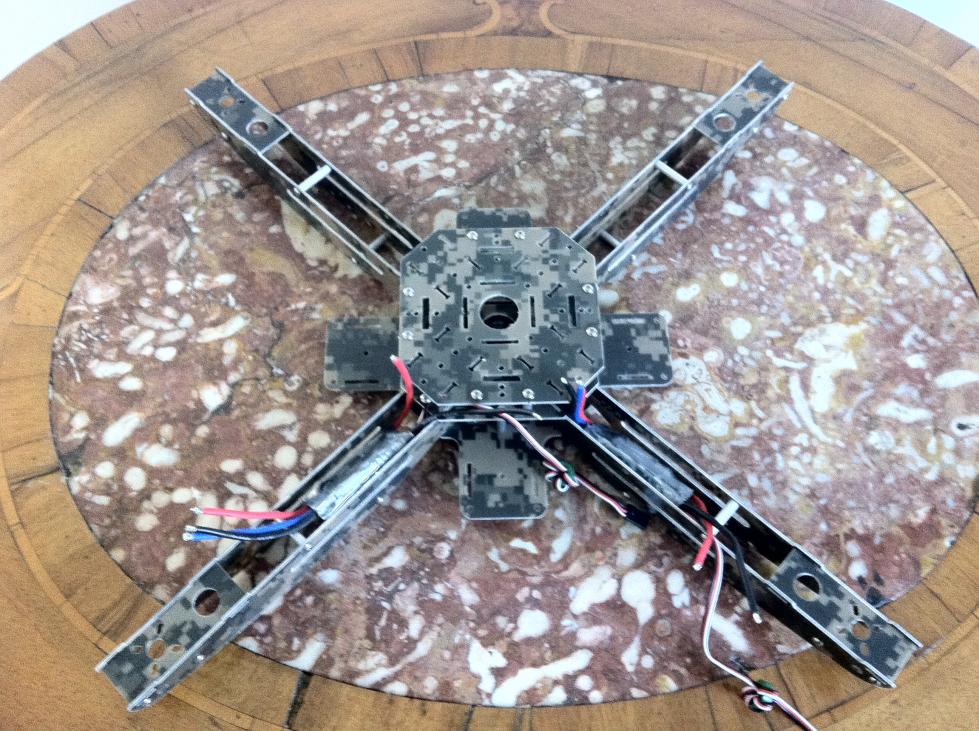

Okay made up my mind and building a second FPV bird for a friend right away !
Would have preferred the new FPV Hoverthings frame but since its still going to take some time until avaible i choose the classics first.
Frames:
Hoverthings VC450 Camo
Hoverthings VC450 Black

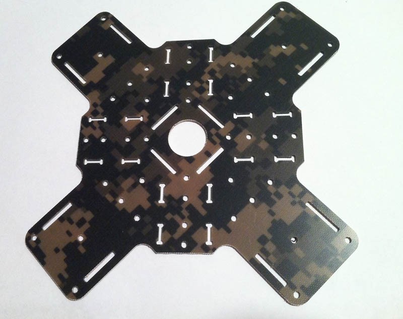

both frame get the 4 TAB x 2

Motors camo frame
AXI 2217/20 8-14A 840 Kv 70 g

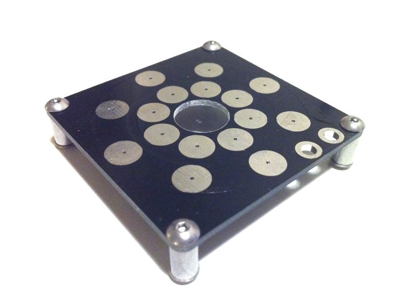

2x Hoverthings dist. board

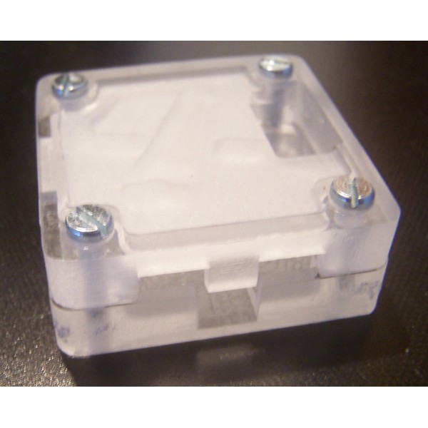

Protective Case
lets see how it works on the frame:

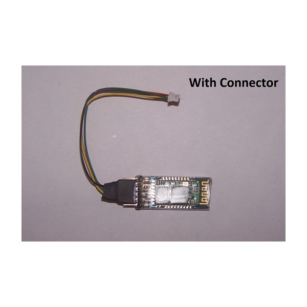

BT Module
maybe going to change to Xbee have to try out the range on these.

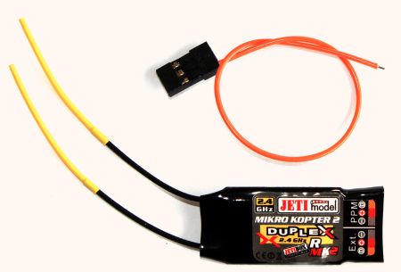

Finally back to Jeti again really happy about that.
in combo with a MX 22 Graupner, jeti module

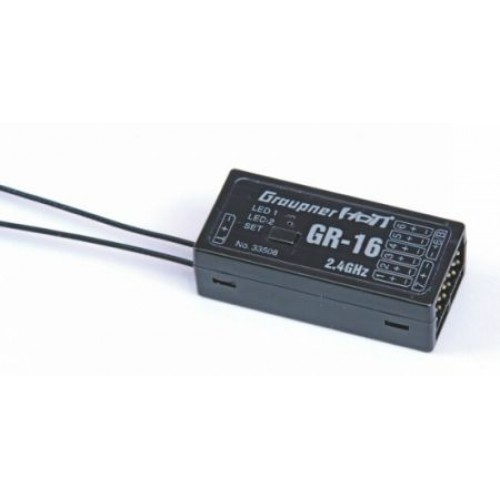

Graupner MX - 16 HOTT
GR-16 HOTT

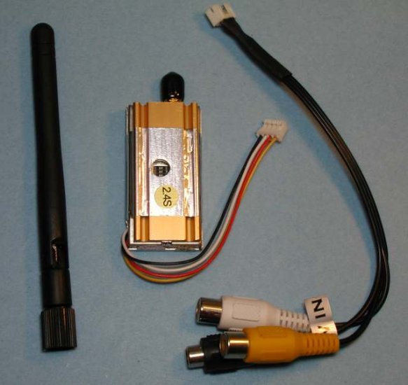

any recommendation for any good FPV gear or should i just use what every one else is using for these bird 1.2 1.3 lawmate 200 and receiver twice to it with eagle tree diversity ?

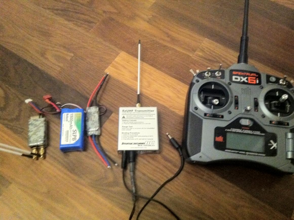

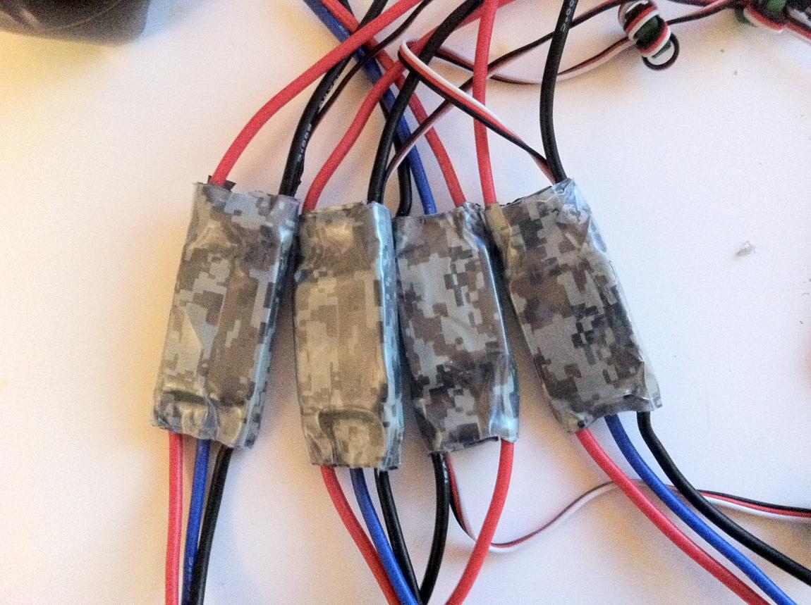

camo ESCs ready they are the RapidESCs from abusemark with a camo foil over them.
Just waiting for the Camo shrink tubing to arrive and the first frame should be here this week

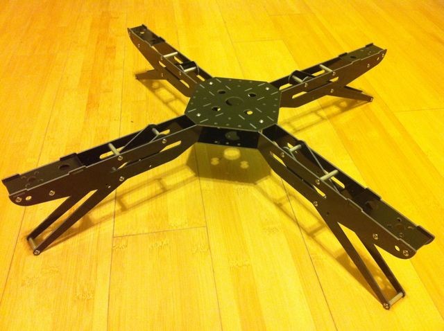

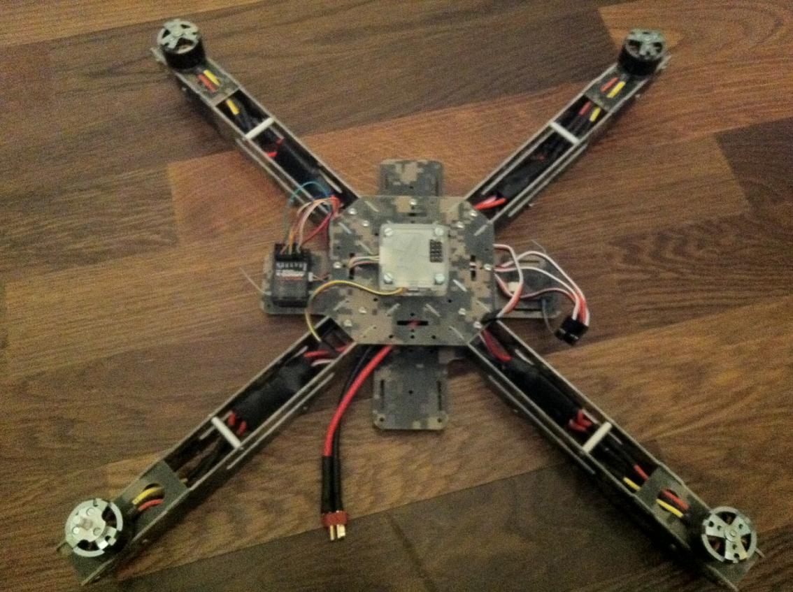

go one of the frames today just playing around with it and figuring were which components could go. Are there any rules for mounting an CC board, rubber dampners etc or just plain on the frame ?

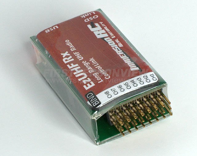

EZUHF Receiver 18g

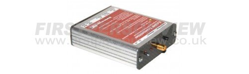

lawman 2.4ghz 1000 MW 20g

matwelli
i have always hard mounted mine, only had an issue with vibrations when i had a bent shaft or badly out of balance prop. That camo foil is cool :)
