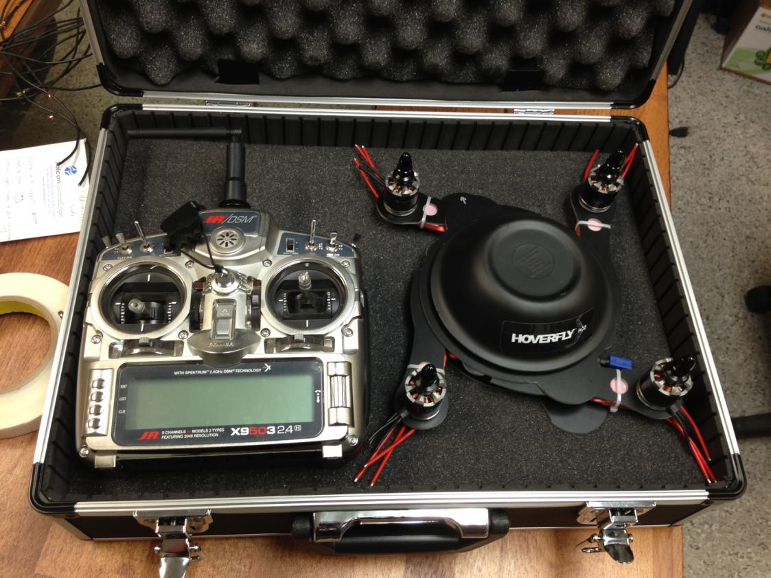

Here is my latest product. The Fold-N-fly. I'll have it up on my website early next year. I need to correct some small things in the wiring assembly. FYI, it will still fit in the case with the 9" props on it.

The quad looks like fun - well done.
