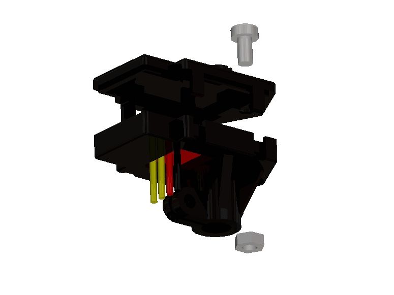

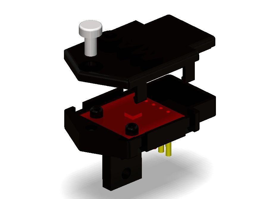

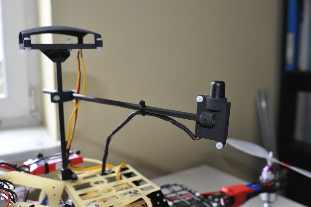

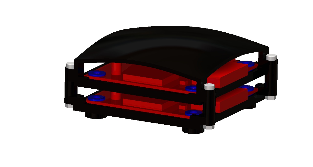

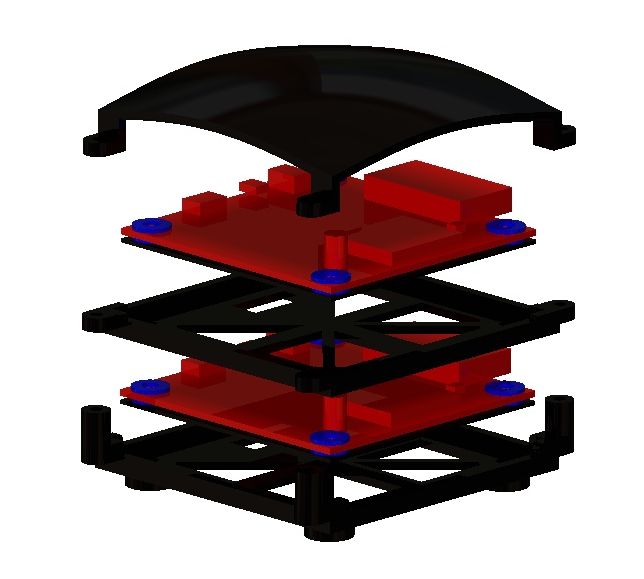

Krzysiek
If I knew that Hoverflytech would implement external magnetometer I would not create HF GPS unit cover. I just bought external mag. and I am about to create cover for it.
So I think It is bettter if you wait for ext. mag cover. I guess it would be cheaper solution and more neat.

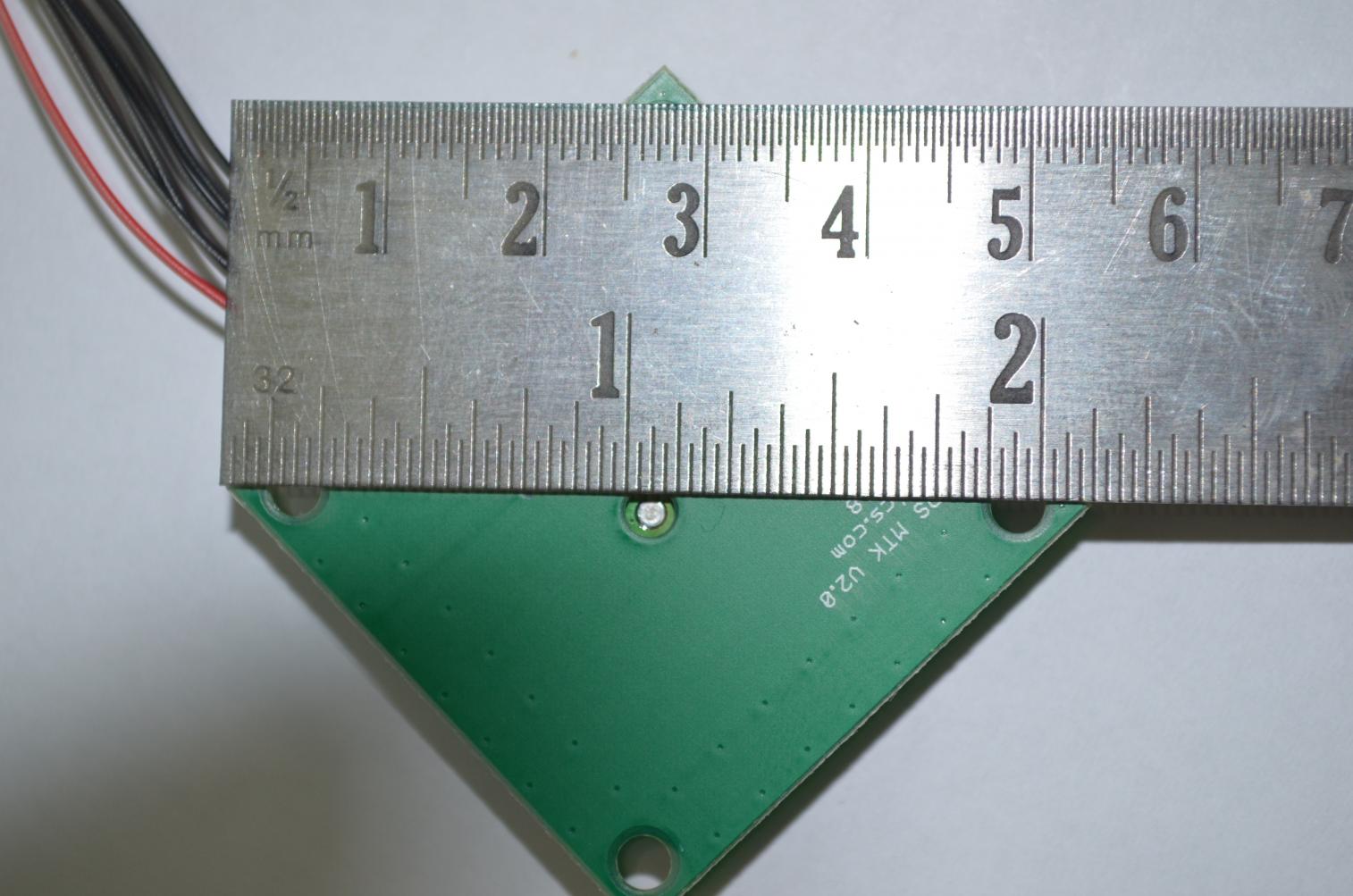

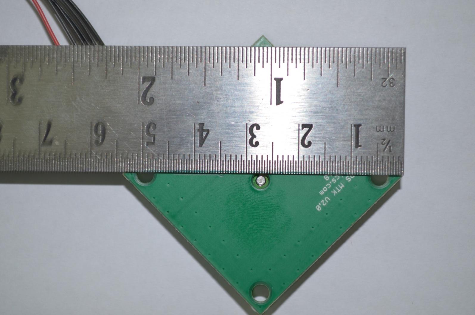

Razzil
Mediatek MT3329 GPS v2
37x37mm - length x width
32mm - center of hole-to-hole across
45mm - center of hole-to-hole diagonally
8mm (10mm to be safe) - height of center module
5mm (6mm to be safe) - length x width of center module
4mm (5mm to be safe) - height of connector

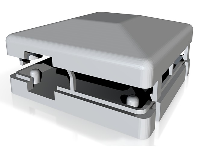

Razzil
Krzysiek, created these various items below for the HoverflyPro/GPS and Mediatek MT3329 GPS v2 module.
They look awesome, I have the stacked items ordered, and will let you know if they all fit perfectly once they arrive.
Same goes for the MediaTek module.
View attachment 8264View attachment 8265View attachment 8266
I wanted something to protect the Mediatek GPS module and be able to mount pretty much anywhere.
The stacked items, I was hoping to place a piece of carbon fiber between the Pro and GPS to hopefully ...
... cut down on the
on-board compass on the HoverflyGPS pickingup EMI from the on-board electronics of the Pro board.
... I placed an order today, will let you know how they all pan out
... Thanks Krzysiek
