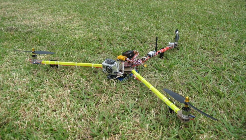

Hi Ross.
The mechanics of mine were based on the tricopter built by David Windestål at http://rcexplorer.se/. My build used Hobby King parts. The motors were 2213N 800Kv Brushless, ESCs were Turnigy Plush 18 Amp, Props were GWS 9x5 (2 standard and 1 counter rotating) and I used the BMS-385DMAX Digital Servo for the tail servo. All flew very well with plenty of power and good response on a 2200 mAh 3S Lipo. When I added the GoPro I changed to 10x6 props for more power but it was less responsive so I went back to the 9x5. I believe you can use 3 standard props in a tricopter but you dont get the same linear yaw response. I havent tried it but David Windestål only uses standard props and it doesnt seem to bother him.
Im in the process of updating the motors to HexTronic DT750 750kv motors which are more efficient and have more torque and power for a similar current. I should have it running in a few days (if I can get the time to complete the upgrade).
I added a Heli body to mine when Im not filming which helps with the orientation. I can fly the tricopter from the ground at much greater distances than I can fly the F450 because its much easier to orientate the Tricopter from the ground.
In the picture below you can see I added an FY-20 for extra stabilization. The combination gives stability close to the Naza system and I can change to manual mode at the flick of a switch. I've since changed the FPV antenna to a cloverleaf type for better performance.
