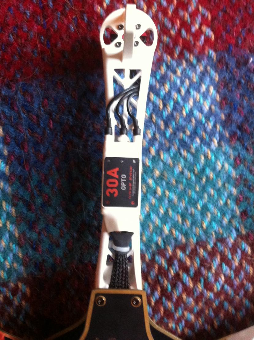

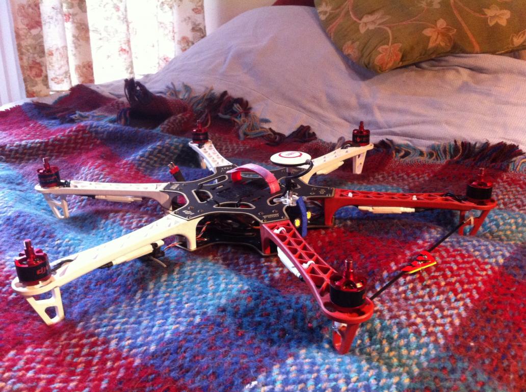

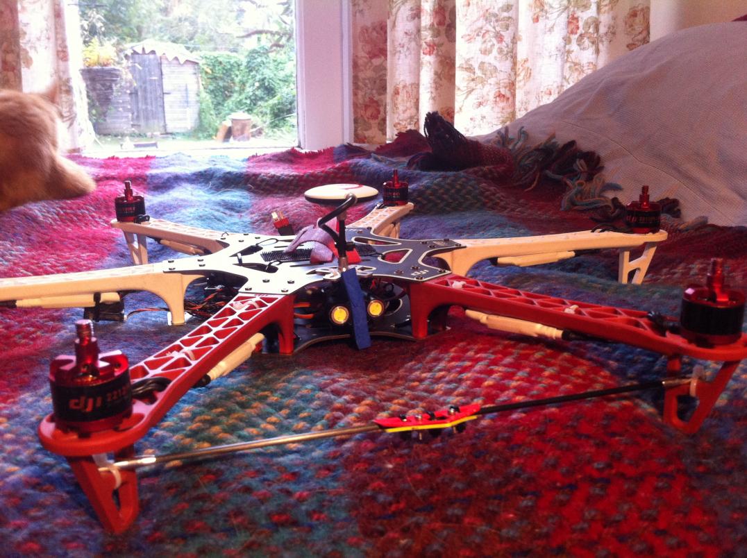

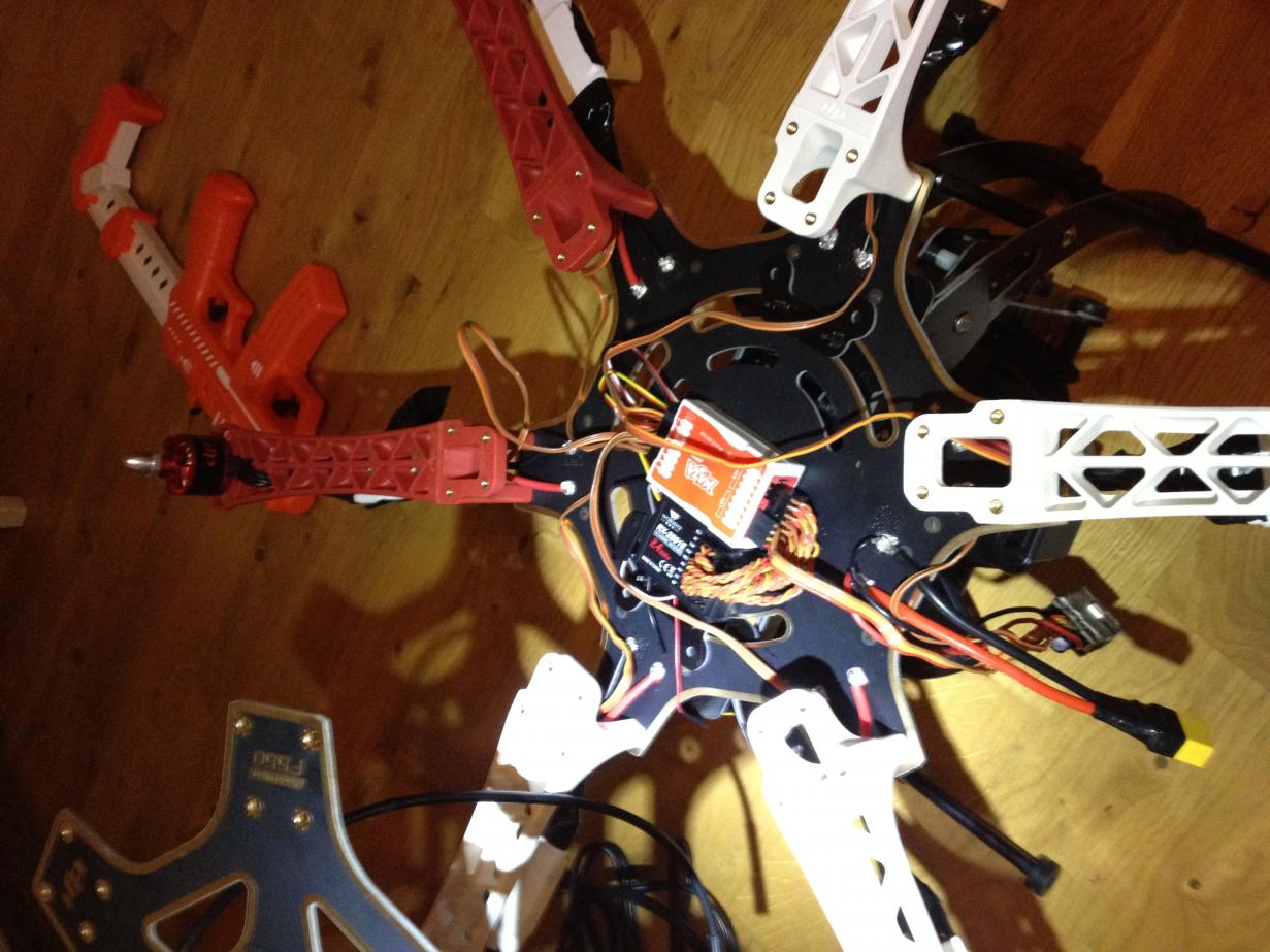

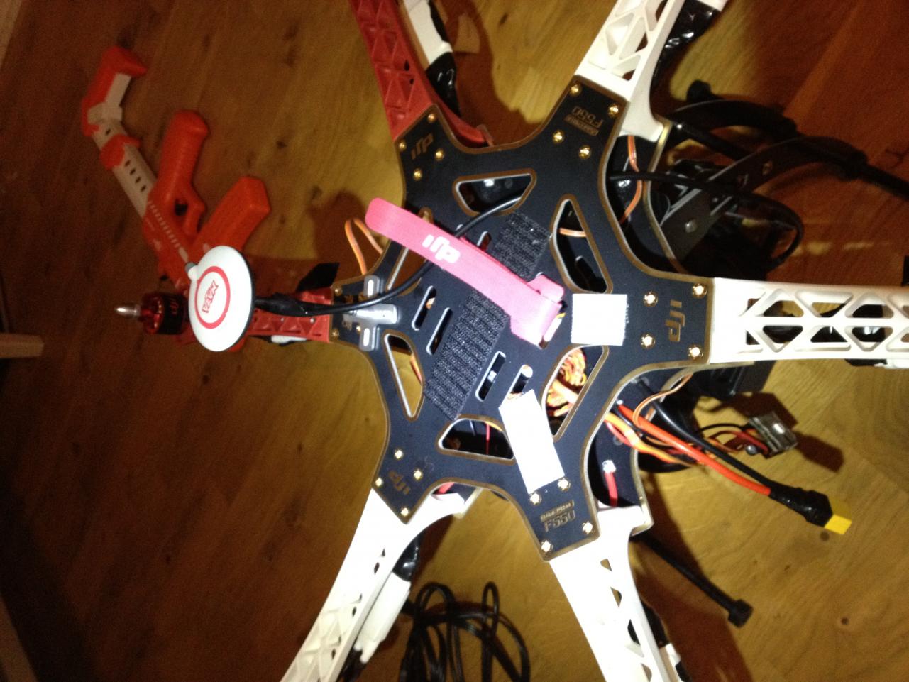

The build. The DJI F550 was a great build! Coming from helis the lack of any mechanical bits made the build a walk in the park (no copious amounts of thread-lock or checking tension and screw tightness). Just soldering! I have a butane adjustable 70W soldering iron which made it easy (got it for the build). It's light and I can take it with me in my flight bag in case of at the field repairs (haven't needed it yet though :loyal:). Apart from the Graupners the rest is all stock.
The Naza GPS...........Awesome!!! Easy to set-up and just sits there. Still get the wobbles on the way down in GPS mode. To be honest I only fly in GPS mode. I have everything else set-up except course lock (Spektrum DX7s, only one three position switch) and the fail-safe works on the assistant but I haven't tried it in real life :uncomfortableness:. I do live in the city so can't afford to have the rig too far away or out of my control, comes from helis I think. I just can't bring myself to hand complete control over to the craft, I need my finger on the kill switch if anything. I'm sure it would work as the GPS works and the magnetic declination is only about 1.25 degrees here so the offset is minor and easy. I occasionally get a very mild TBE (toilet bowl effect). I have found it to be caused by moving the craft slightly upon powering up (unstable surface) but reinitialising the Naza solves it.

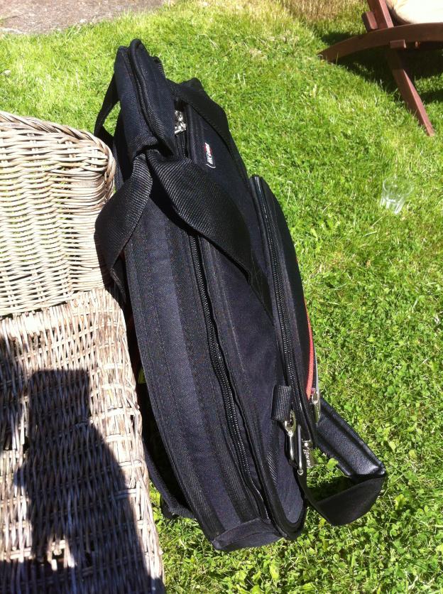

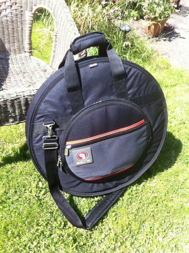

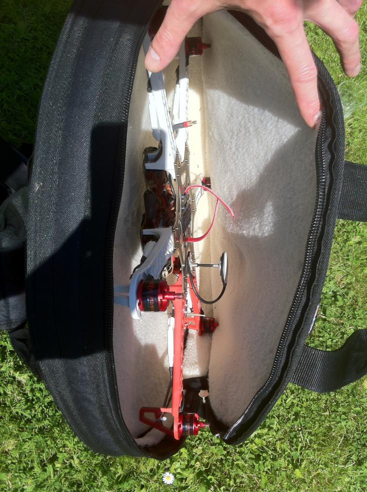

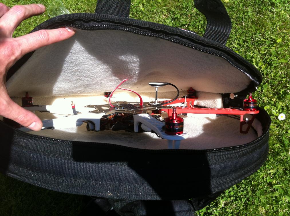

I need to be able to carry the F550 with me as I want to trek it up a mountain or some such thing so got a Cymbal case to carry it. It has built in rucksack straps and is padded with reinforced sides. I have to take the props off each time so can't use thread-lock but use Nyloc nuts and a washer (for the 10" Graupners, I hand filed the 9" which lock onto the motor shaft like the stock ones do). I use an old tail boom strut from a heli and some tail fins between the front two arms for orientation and have a couple of super bright lights in the frame.

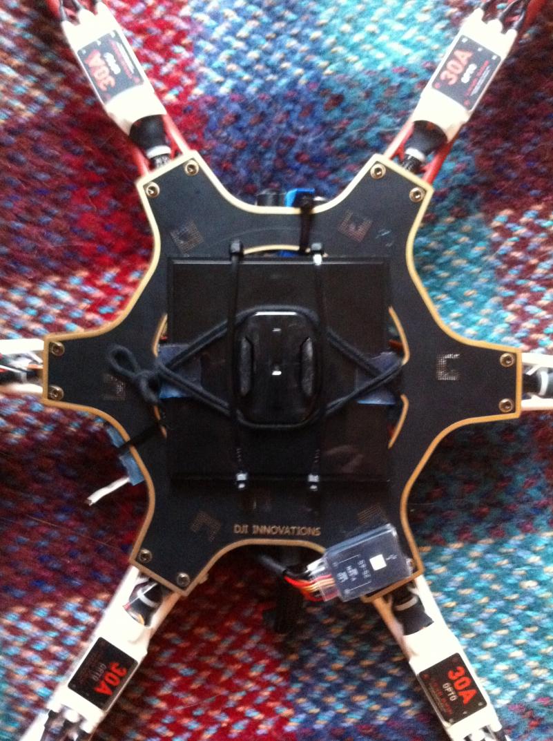

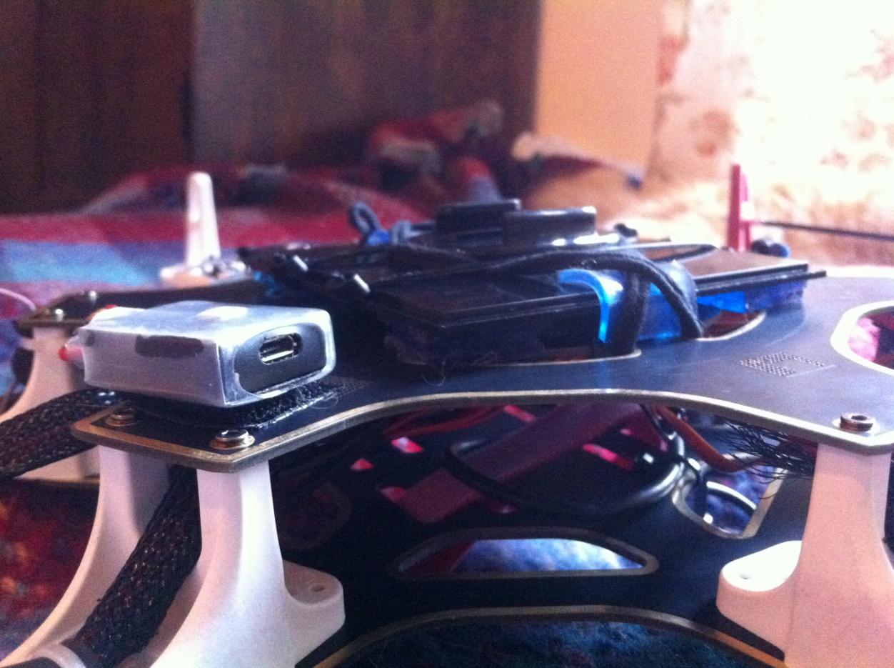

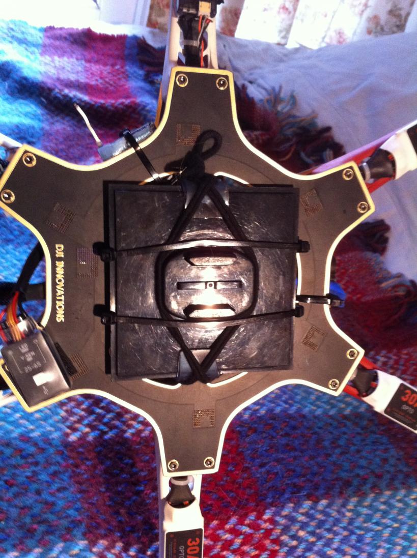

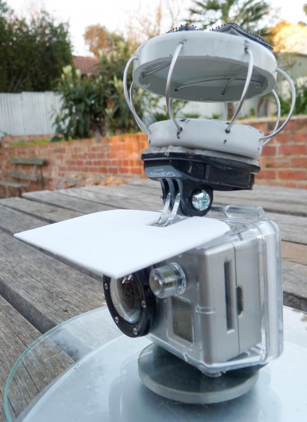

The Wifi BacPac works. It has a range of maybe 200ft with a clear line of sight. Don't know how the range will be with the iPhone though. I made a mount for the GoPro using the packaging it came in and some PU gel, and a shoelace...

The bag (it's an Ahead Amour Cymbal Silo 24"):
View attachment 6349View attachment 6350View attachment 6351View attachment 6352

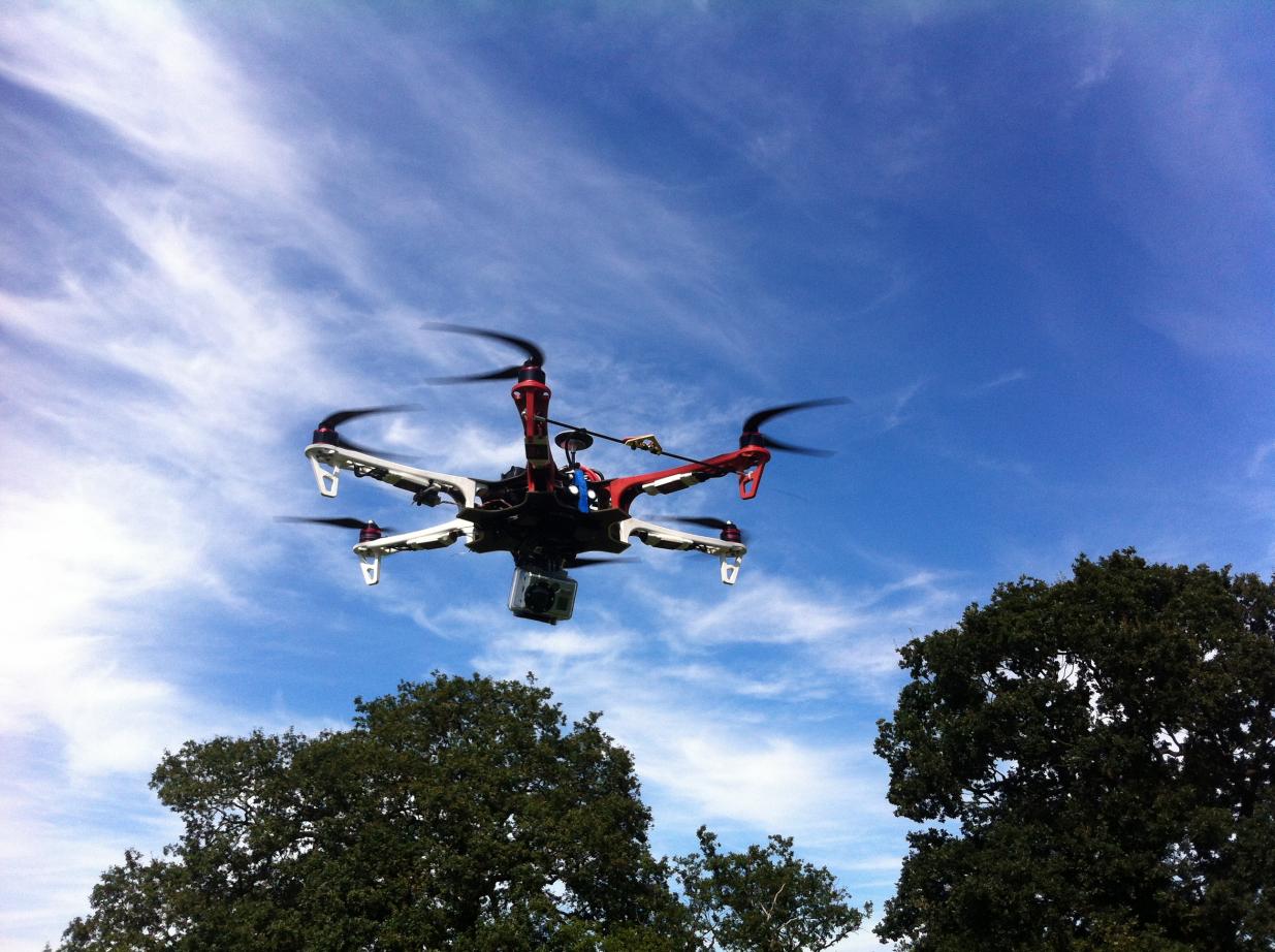

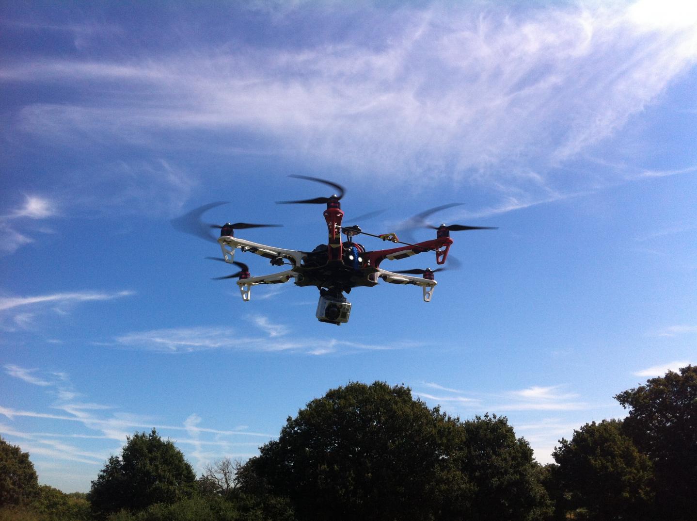

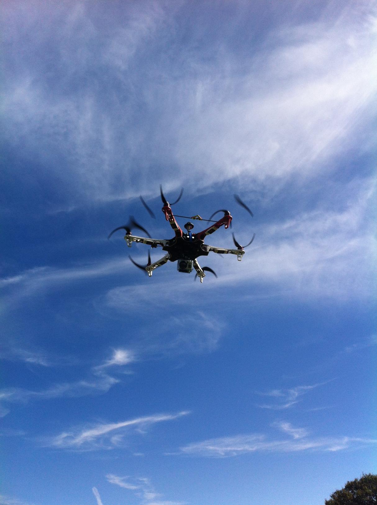

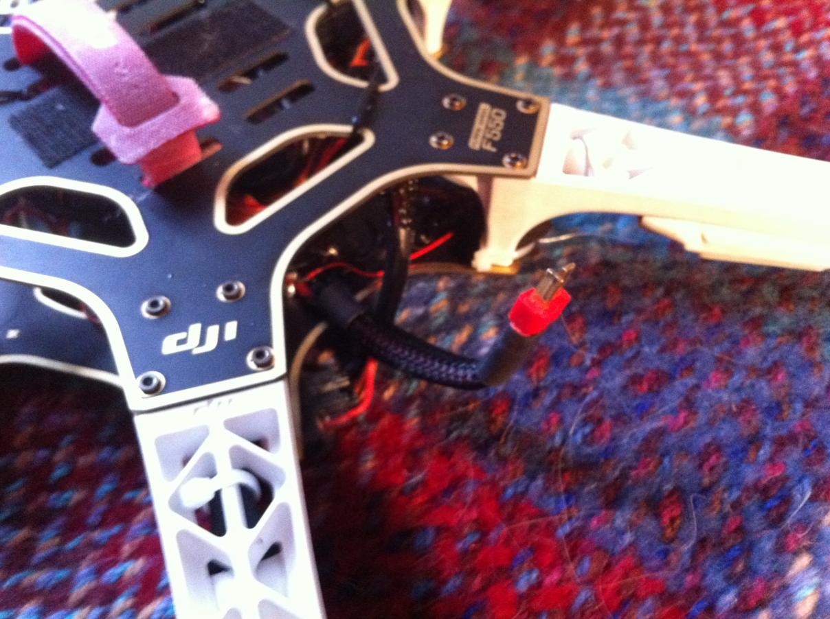

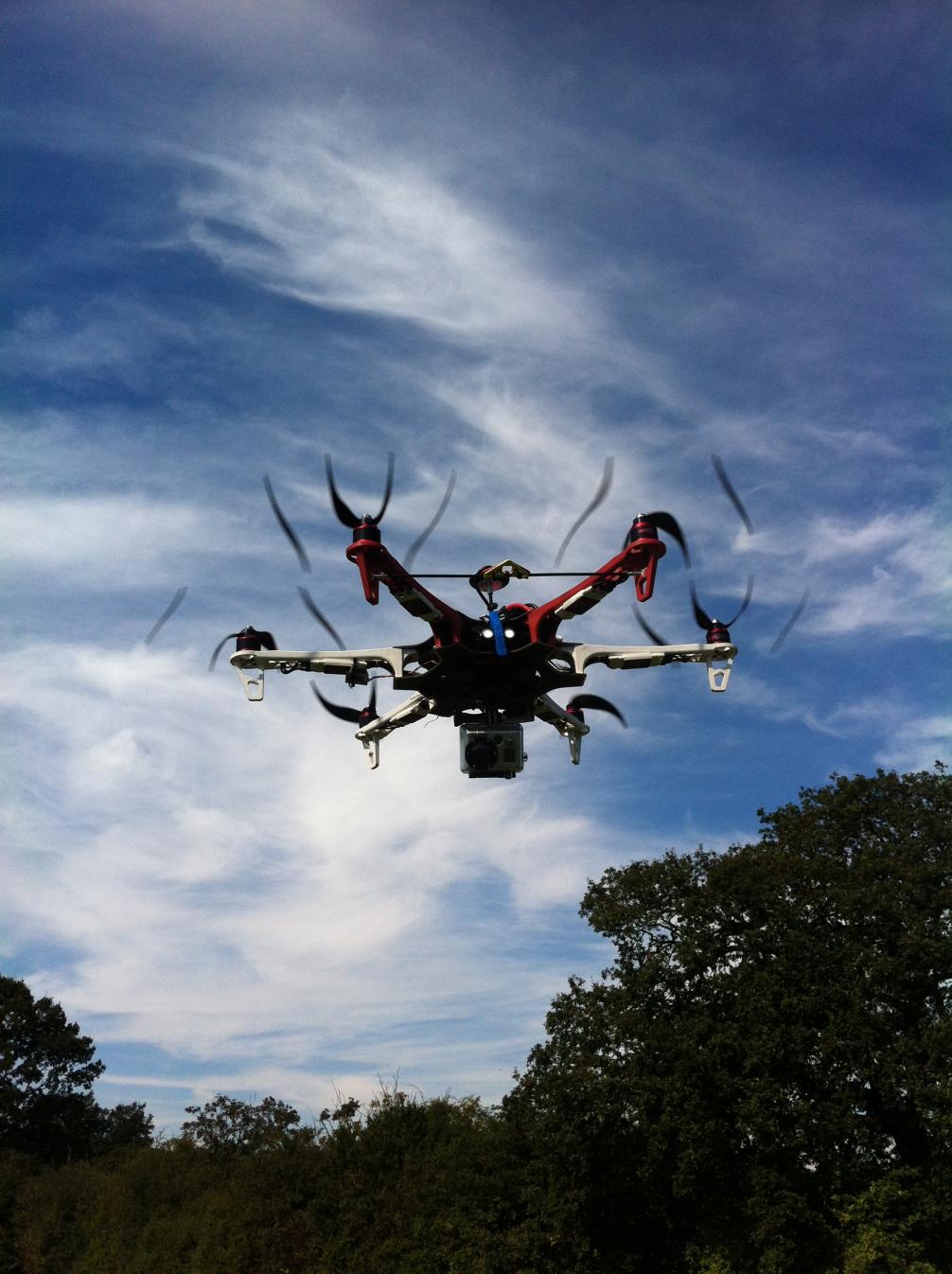

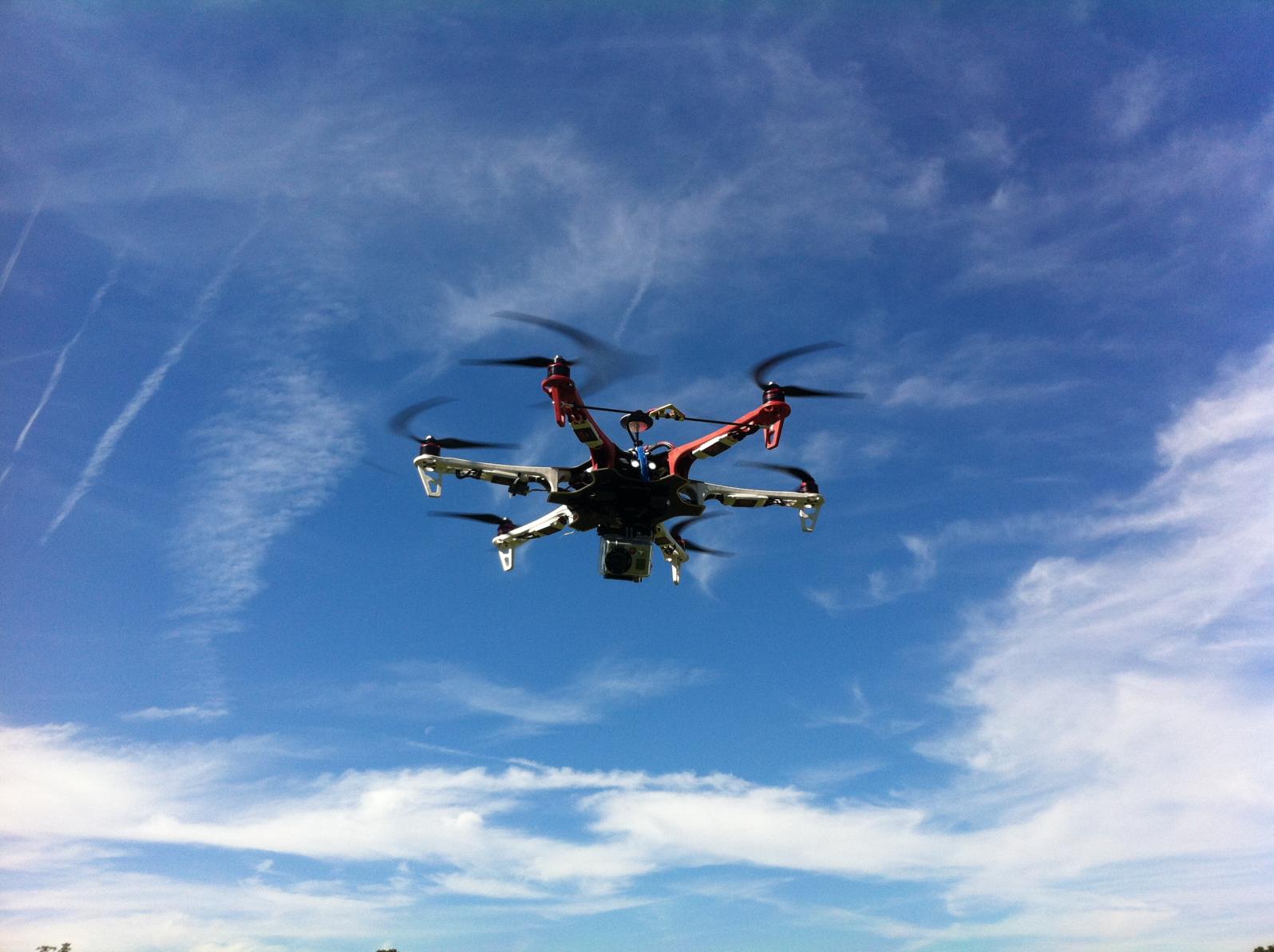

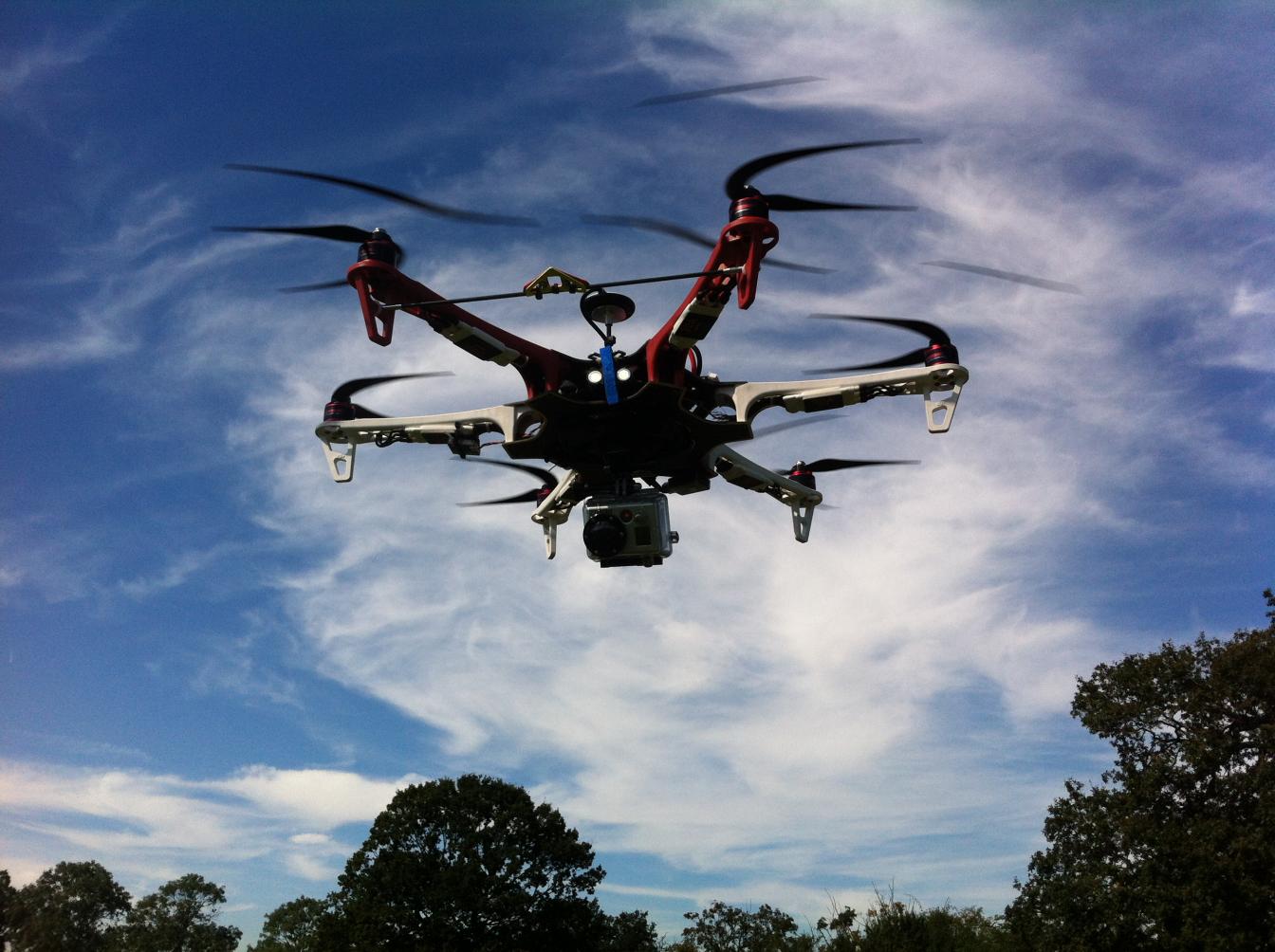

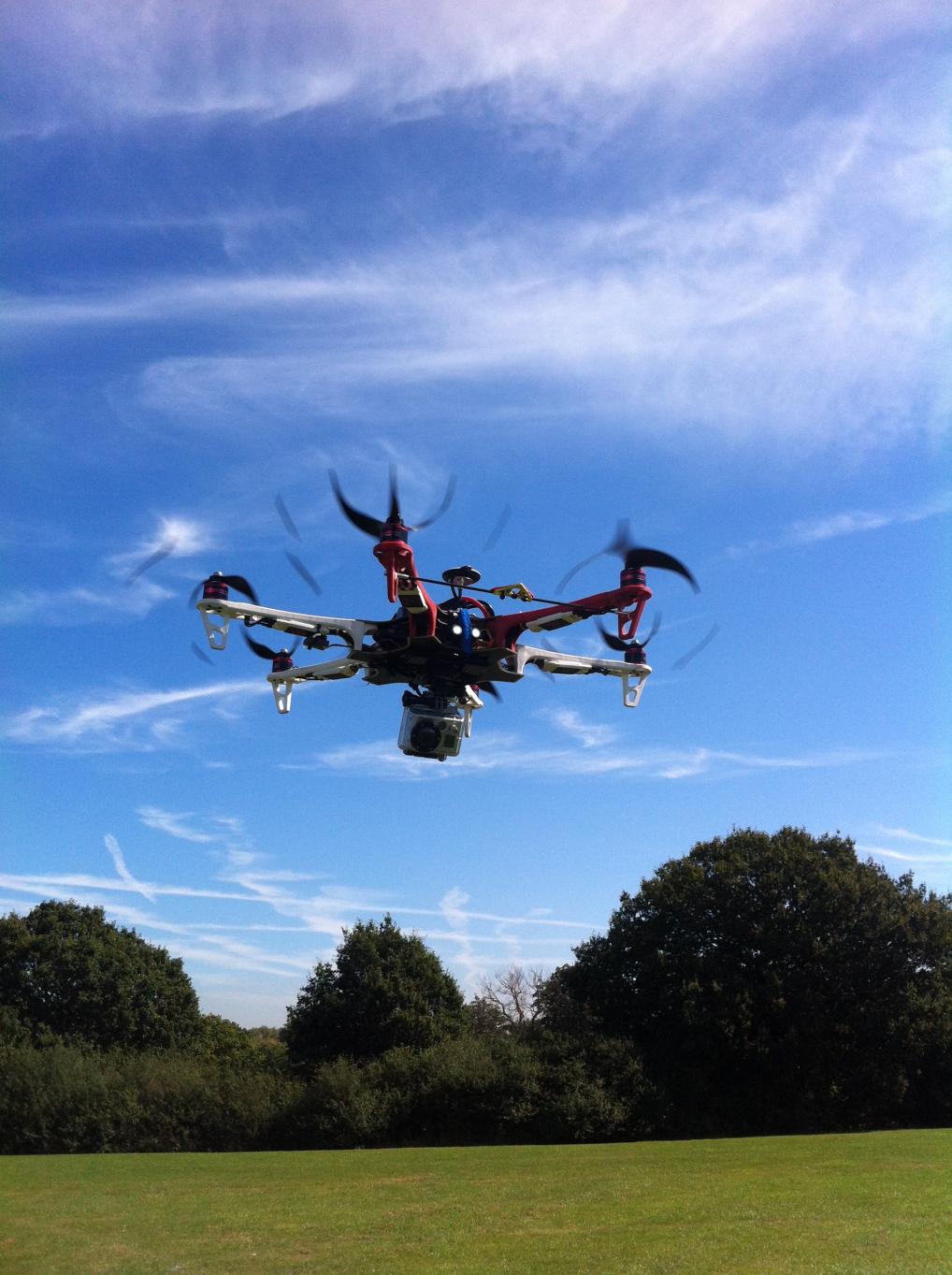

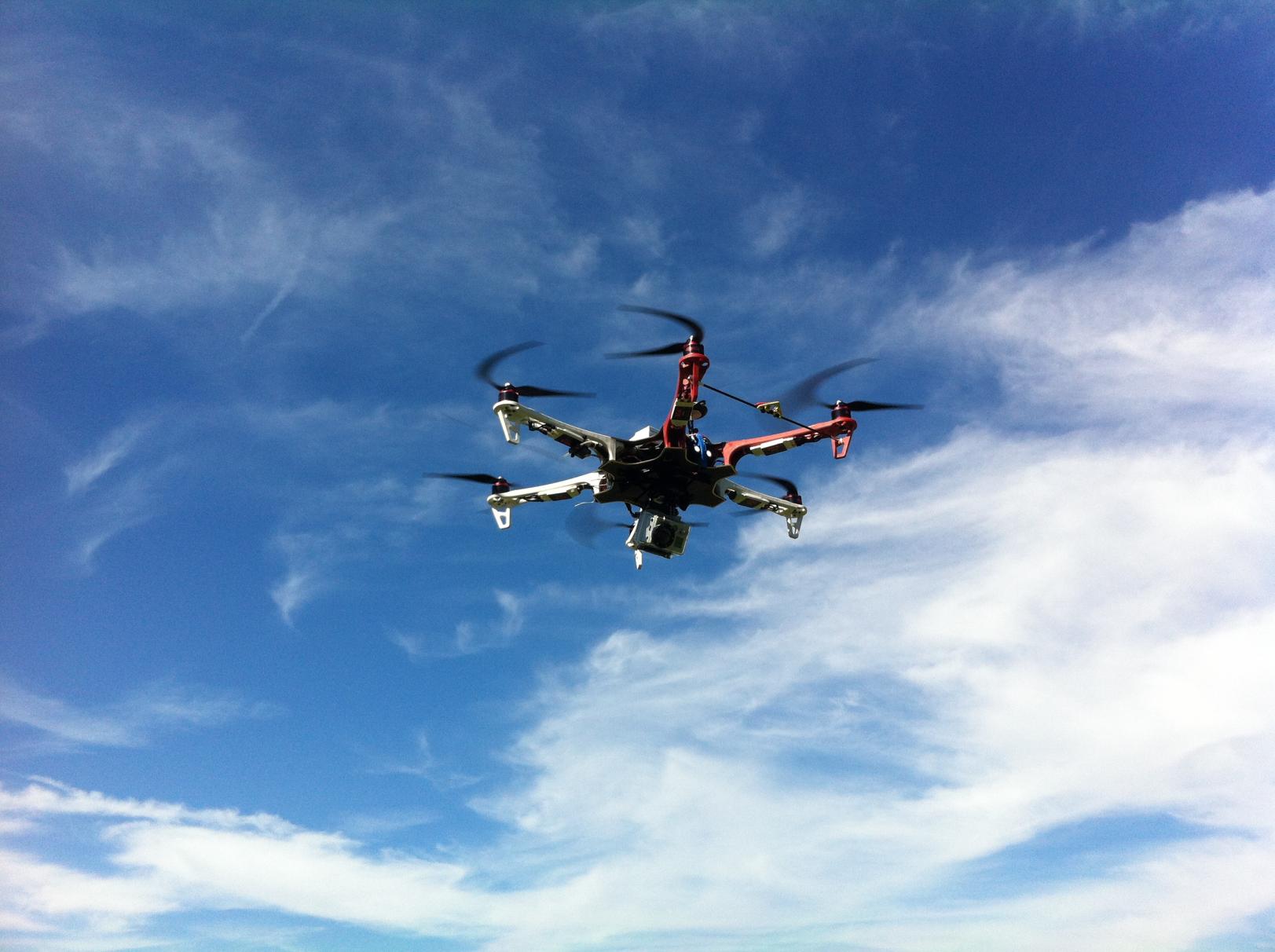

The F550 (the blades look awesome):
View attachment 6353View attachment 6354View attachment 6355View attachment 6356View attachment 6357View attachment 6358View attachment 6359View attachment 6360

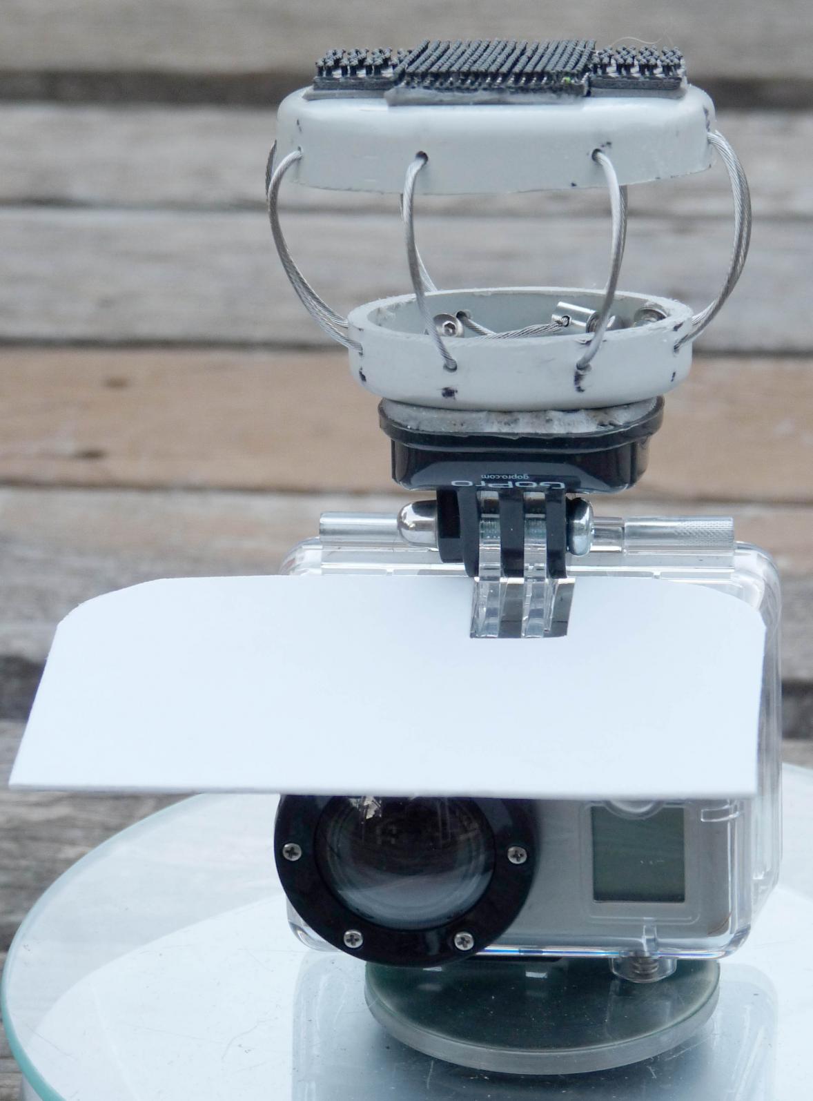

And the mount:
View attachment 6361View attachment 6362View attachment 6363View attachment 6364View attachment 6365View attachment 6366View attachment 6367View attachment 6368

Thanks Ben for posting the photo of how you used foam above the large black GoPro mount to isolate vibration. Do you find this set up gets you better better photos and videos?
Do you launch by hand or from a ring to accommodate the
GoPro?
Benjamin Kenobi
Easy? You call that easy?
Hi Jim! I find it gets rid of most of the vibes. Not perfect. My vids come out fine.
