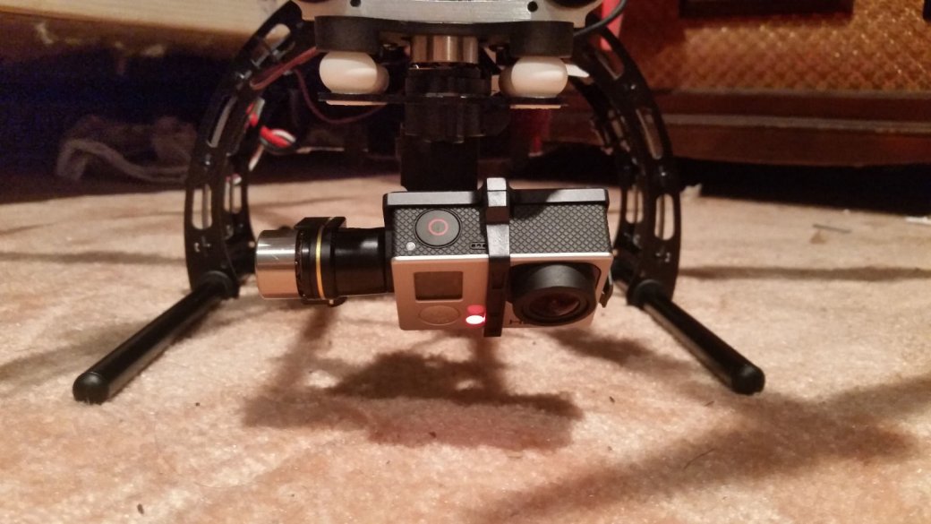

Do not use these to attach the tubes to the retracts. The tube will vibrate and the 2 screws holding the cup onto the retract will vibrate loose. Even when using blue loctice. Use a 35mm x 3mm screw and locknut to hold the tube in place and snug that nut down. Cheers.
Sleepy C let us know how the M5 likes it. I am looking to build a second ship and have been watching this forum. The worst on anything is attaching the gimble and seeing it shake horrible.
