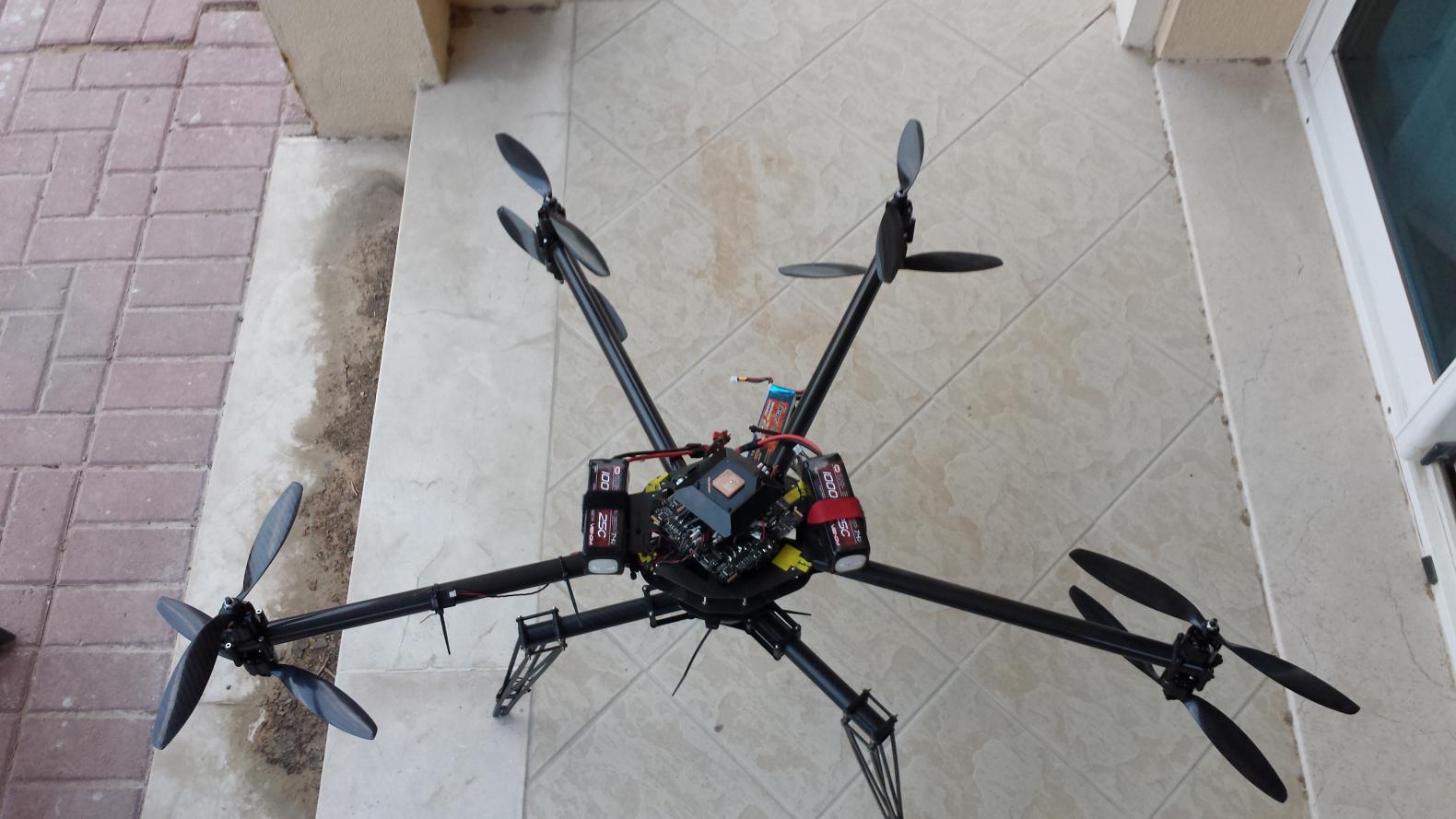

I'm proud to show you my last design : BlacK-SpY.
The dimension is 820mm of diameter and it can run 13" propellers
It's easy to mount a Zenmuse and the space for the LIPO can be adjusted easily.
Let's see pictures :

Frames (sup + inf + sup Lipo) = 140gr
6 arms = 235gr
6 feet = 61gr
6 motor mount = 17gr
small parts = 15gr
Global weight of the carbon parts = 468gr for an hexa of 820mm diameter

Cool design, looks a lot like the Sky-Hero Spyder...
But I actually like your front arm design better, easier to get the props out of the way.

I'd also be interested in what FC's you've tried with this design, I am testing a similar design (minus the two middle booms) and have nearly come to the conclusion that mikrokopter isn't capable of being programed to work with it. I really like the attention to detail and quality of the build here, nice work.

Thank you :)
This type of frame is easily controlled by Naza module in hexa mode
