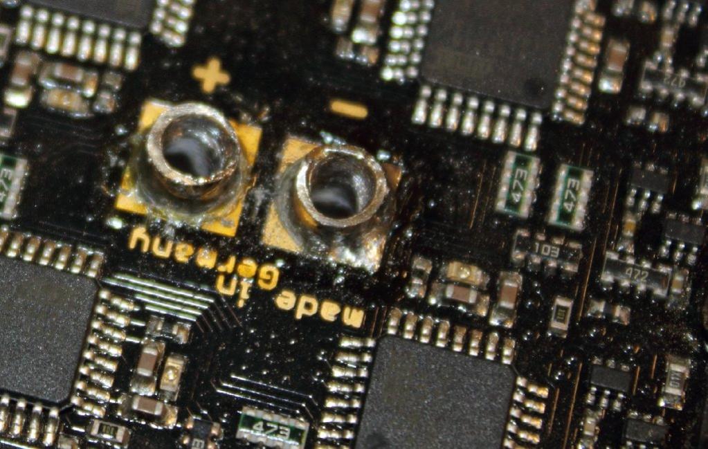

Victor emailed me that the board did not work , ok i can understand that , as you can see to all copied emails he put on ( thanks for doing that and filling my inbox with Spam) MODERATOR: please remove ANY post with my company details these are privat!.
now i got flamed and received a picture from mr beier and globeflight telling me basicly :what the hell?
i looked at the picture and i also went what the hell?
today i received back the board from Victor.

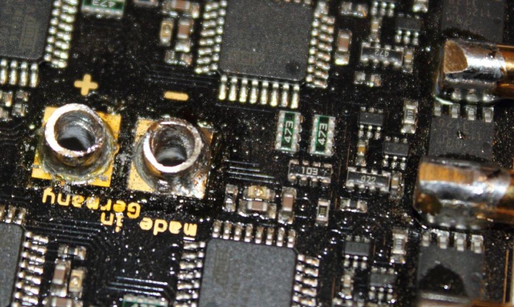

now if you look back to the picture victor has posted look very carefully to row A and C you can see clearly that the bullet connectors are damaged by a grind tool.
Victor has cut of with a dremel or some other tool the XT-60 connector (he has a counterpart with the package)
he has then drilled the remaining bits out of the power connector.
stuck in a couple of cables and soldered them cold.
you can image because of the drilling and all of the grinding , all the copper parts flew everywhere and embedded themselfes between the micro smd parts creating shortcuts
i measured up to now 12 of them , but that was just on the upper side..
i am sure as the messenger now , i will still look bad.

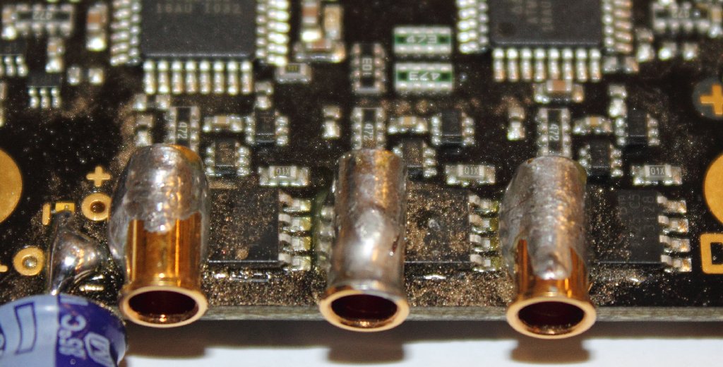

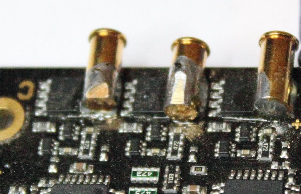

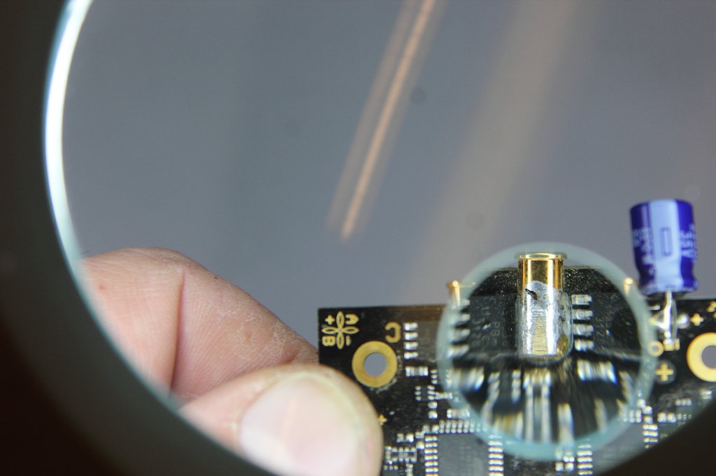

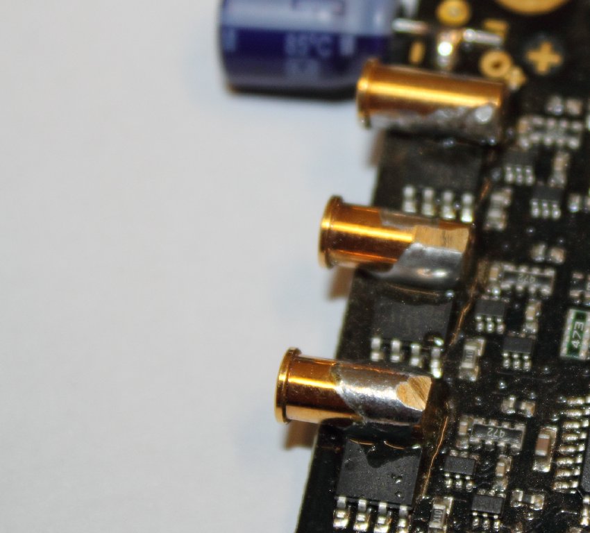

about the solderings , yes there seems a lot of solder on and by the bullet , this is why:
you cant solder a flat side to a Round bit , the contact it will make will be very thin.
that is why i used a bit more solder , try to run a 6S on a skyjib with a RED epic and minimal soldering , it pulled 81 amps runned at 85 degrees celcius , and started to smell.
now with the bit thicker solderings the smell is gone , so is the high temps..
all the contacts you see where working , i fly to heavy skyjibs and a CX 4 with the herkules boards .
to close this story once and for all here are the pictures i made , everything that is gray or gold is copper dust......

Sandor the board did not work ever since i got it with the original connector before i cut it off.
No throttle response from any of the motor outputs. LED's and beeps yes but no throttle.
After i chopped off the connector ( i think it may have been 1 or 2 days later) and soldered the wires inside the two bullet female like parts still soldered to the boards, same thing, LED's came on as before, beeps but no throttle response just as before.
So there was no difference in the behavior of the board.
I made a second mistake after desoldering to wires by cleaning the inside of the female bullet like connectors just prior tp packing it and shipping it which might account for the copper dust.
Anyway here and now i ask you to try the board.
Power it up and see if you get the blue LED's to come on and a beep or more from a motor connected to any of the outputs.
If there is than it is the same board that i received before i cut off anything.
If it goes up in smoke than it is my fault entirely, i screwed up the board and will apologise to you and everyone else i troubled here and elsewhere.
But if the board does respond by turning on the LED's and the outputs with a motor connected behave just as they did like they did the very same i unpacked it and tried it, then what?
I would not try to blame my mistakes on any one.
I take responsability for my deeds.
If i broke the board, i will send you the 450$ i still have to my name as reparations and i apologise to you.
But if i didn't break anything, except that i removed the original connector and in the process touched and put some marks on the bullet females on the sides will you fix it and show proof here on the forum that it works before you ship it back to me?

Remark 1: The sawing copper dust on the pictures are not good for the electronics. As sandor told, you make shorcuts on a lot of the fine-pitched pins. I will be difficult for us to clean it from all that dangerous dust...
