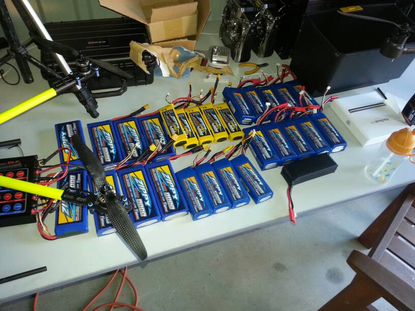

Excellent. What motors did you get?
I'm running a few 3s and a 4s machine. I'm thinking next build will be a 6s and low kV rig.
