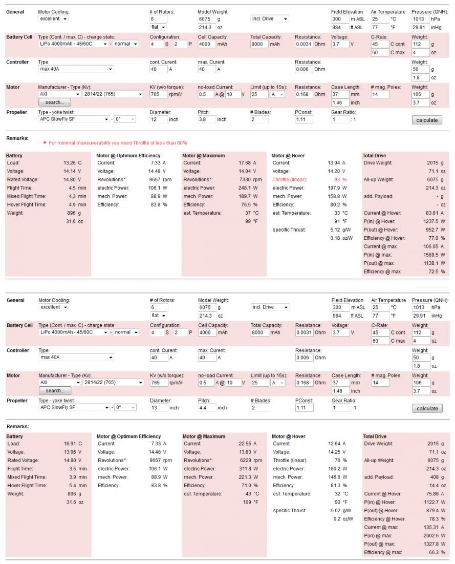

1) Invest some time and energy into eCalc for Multirotors to gain valuable insight in to the consequences of under or oversized motors and/or props etc.

what was your final conclusion on your endeavor with the F550? I definitly do not want to spend $$$$ just to build something in the end will not ever meet my expectations. I have expiermented with the eCalc website but I am not up to par with all the motor spec out there. I am good at building electronics and understanding how one piece effects the other. But I am not good at the down and dirty book related aspect of it. (terminologies, accronyms, or pin point schematics on this stuff) I am very much a visual learner.

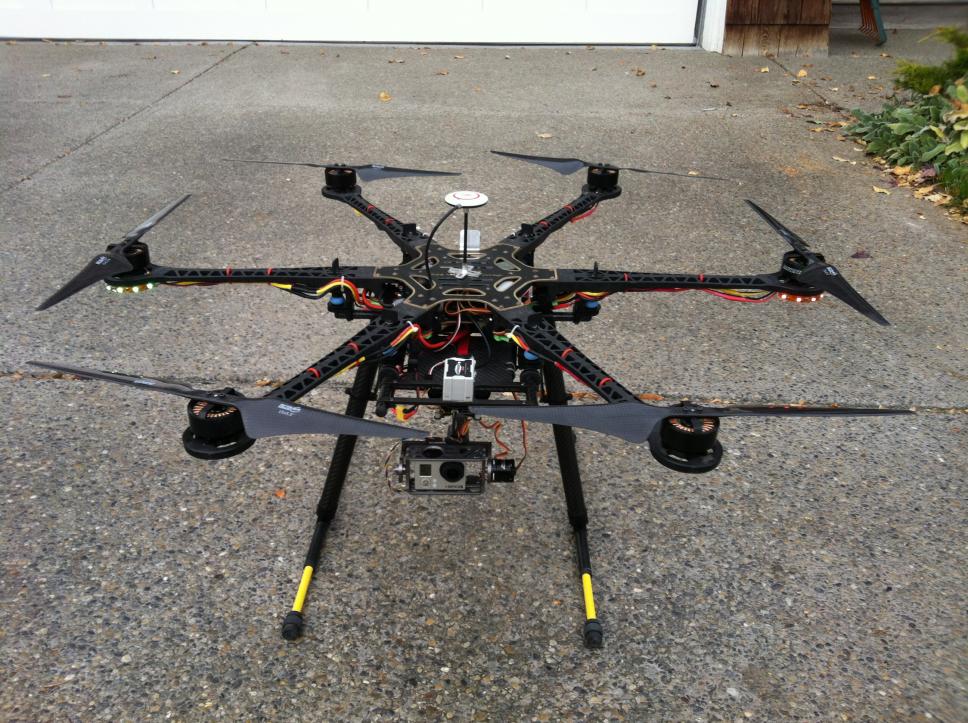

FYI - This was my RCT800 which has 800 mm motor arms versus the DJI550 which had only 550 mm motor arms. That enabled use of larger props, i.e., 15" 5.5 pitch, with higher torque motors.
I used RCTimer 15 x 5.5 carbon fiber props, HobbyKing 35 amp Opt Turnigy Multistar ESCs and 420 kv Multistar motors for a smooth flying machine that could carry the Hero GoPro3 Black camera on a BGC system for 23+ minutes.
