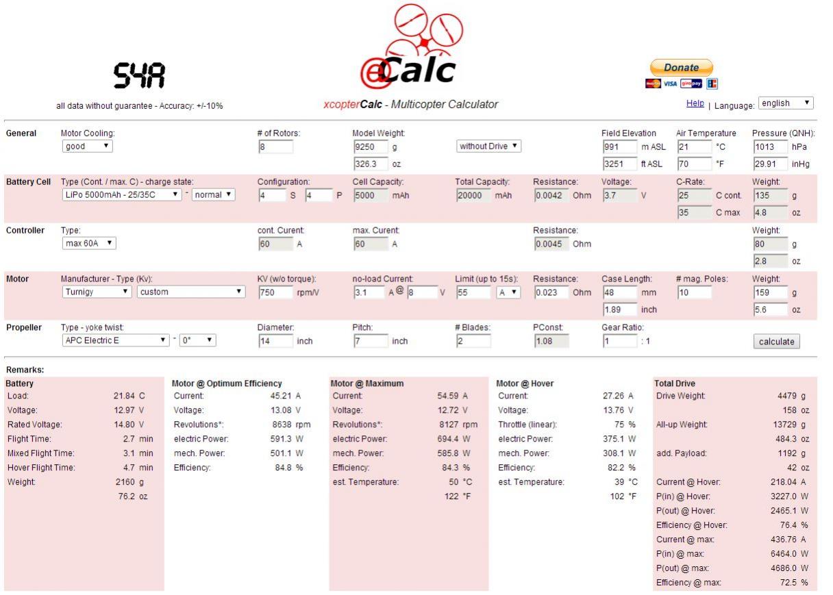

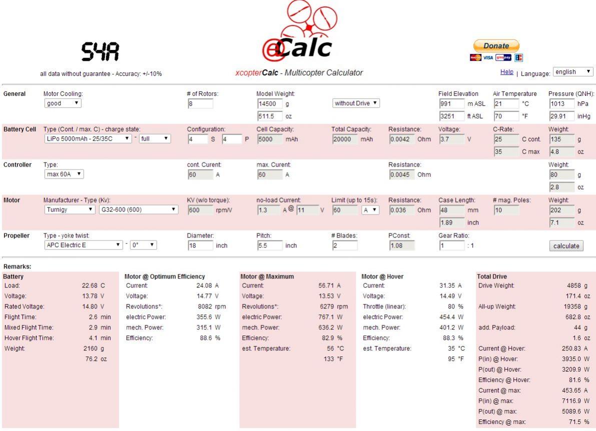

Staying with a big prop (which is what you need to lift weight) , I found a nice motor to suit, and it's only a little more than that last motor you proposed:
http://www.hobbyking.com/hobbyking/..._Brushless_Outrunner_600kv_US_Warehouse_.html
http://www.apcprop.com/ProductDetails.asp?ProductCode=LP18055MRP
Still on 4S and 60A ESCs - according to eCalc you could tip 20kg AUW :tennis:
EDIT: remember to set your battery charge state to "full" in eCalc

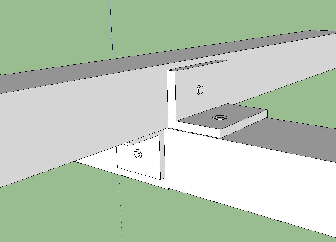

If it were me building the frame, I'd use Epoxy and four small pieces of angle:
http://www.onlinemetals.com/merchant.cfm?id=62&step=2&top_cat=60
Pop-rivet them together and be done:

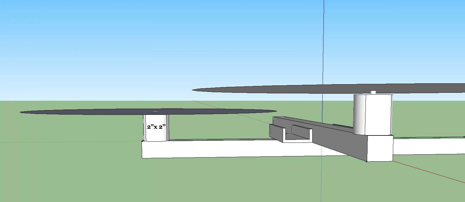

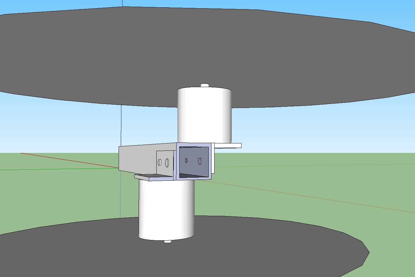

If you use 1" x 2" Channel http://www.onlinemetals.com/merchant.cfm?pid=20270&step=4&showunits=inches&id=1008&top_cat=60
on the upper attachment, you'll have battery trays:

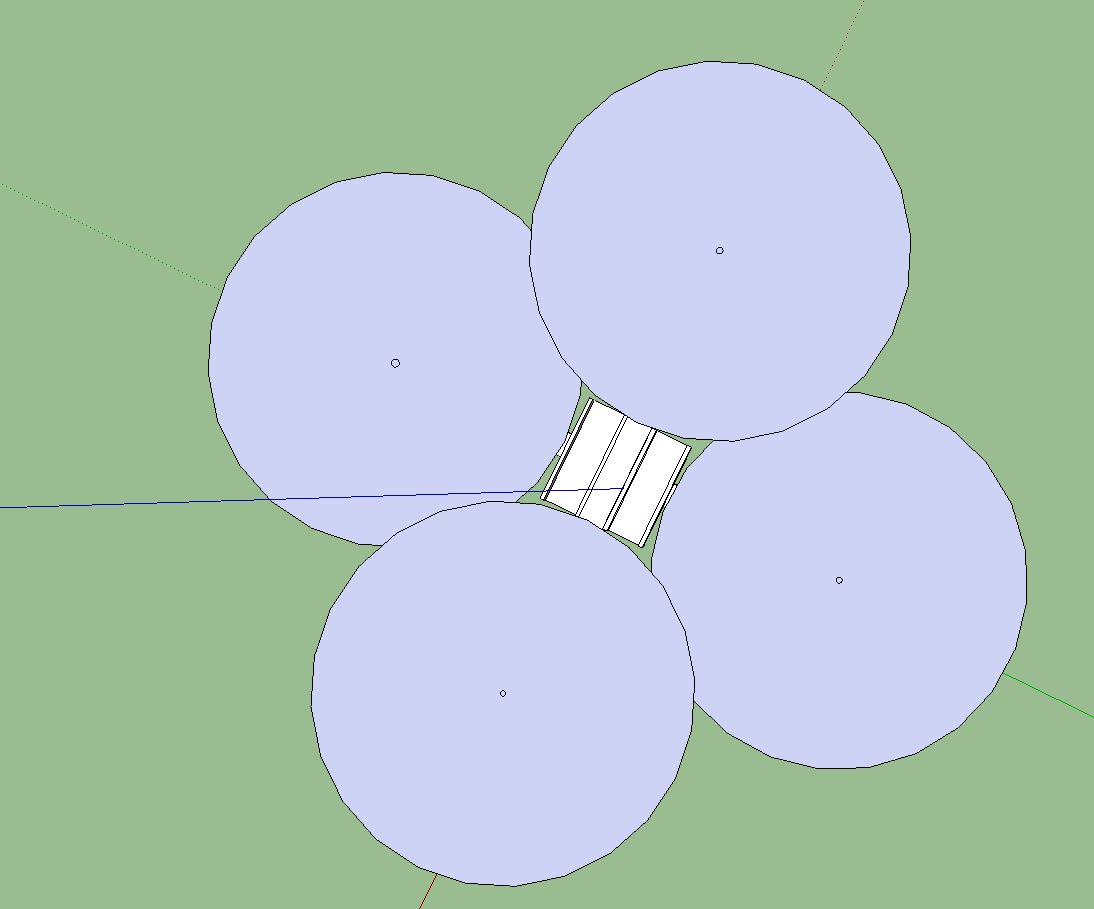

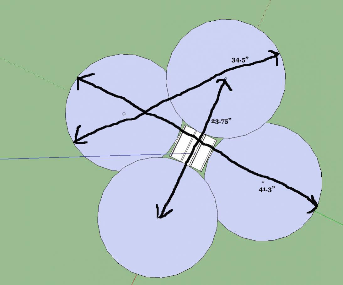

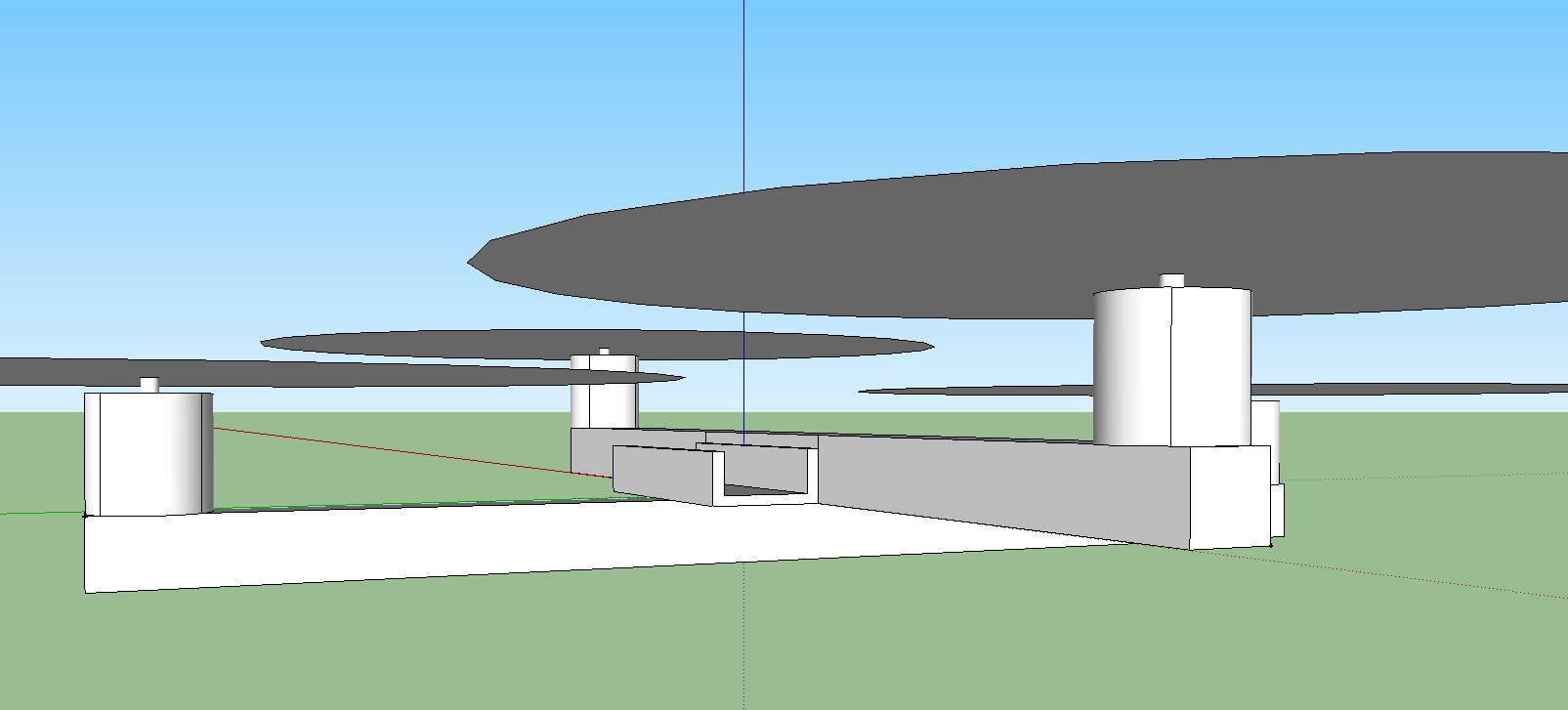

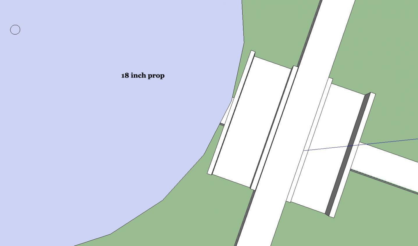

As long as I was in Google Sketchup, I drew it out exactly with 18 inch props.
The motors that Jess suggested are 2 inches high with a 2 inch diameter.
You'll have some nice overlap. See any wasted airspace?
View attachment 16310 View attachment 16308
And the props should clear easily:
You add the bottom props. Ack! I'm telling myself to butt out now!

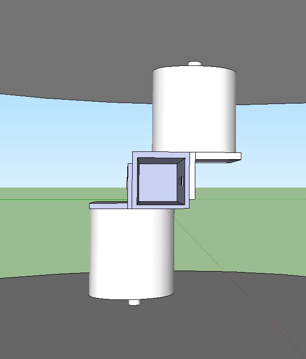

You can offset the motors when you mount them on the ends of the arms to provide easier access to the screws and catch a little more air:
View attachment 16312 View attachment 16311
Now I can sleep.
