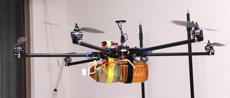

hi i have built a skyspider hex (pic attached ) and want to confirm that the hex-rotor V is the correct motor mixer to choose.
also has anybody used a on screen display with the DJI
thanks
JeffView attachment 1710

You are correct with Hexa V. Remember to check the center of gravity because of the configuration of the spider hexa. That will significantly effect your flying characteristics if it is not calculated correctly. Looks great! Let us know how it flies.

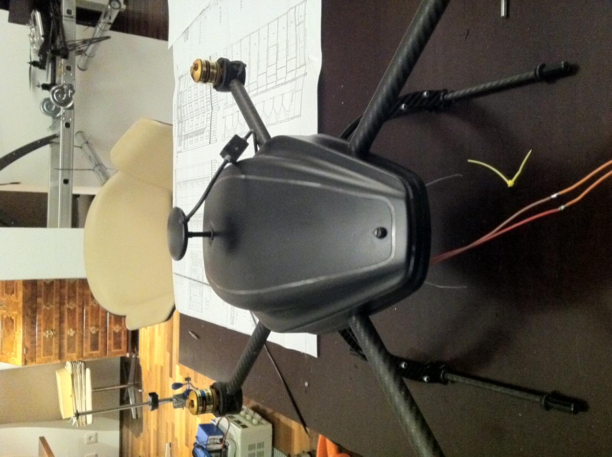

Hi Everyone.
Here is a photo of 95 cm Carbon frame. Center plates are 15 cm diameter, 6 legs are made of 45 cm long and 16 mm outer diameter 3M Carbon. Motors are T-Motor MT3506 650 KV, ESCs are Hobbywing 30A, propellers are APC 12x3.8
View attachment 1712View attachment 1713
Best regards.
Adnan.
