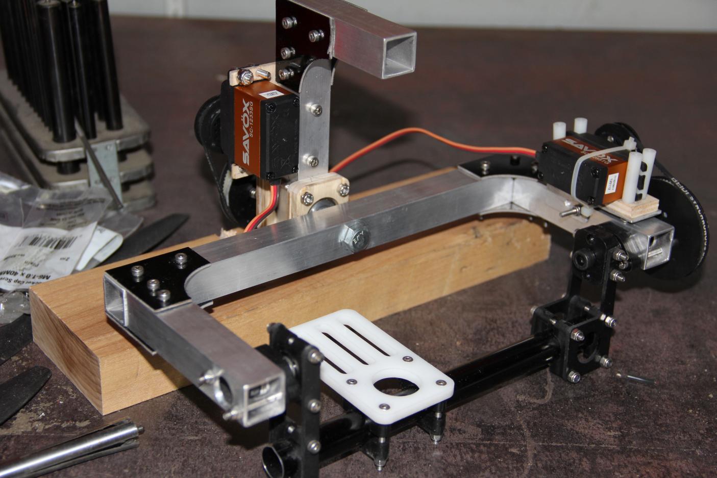

Well here's my first attempt at building a gimbal from scratch, sort of...
it's big and clunky but I didn't have to buy anything more than a couple of 6mm bolts. As soon as my neighbor brings back my wheelbarrow I'll take it to the kitchen for a weigh in but it feels no heavier then a bottle of beer (cheap beer, not froo froo boutique beer).
Figures, on the eve of the brushless gimbal revolution, I build a servo based gimbal. The basics are there to convert it to a brushless gimbal eventually.
