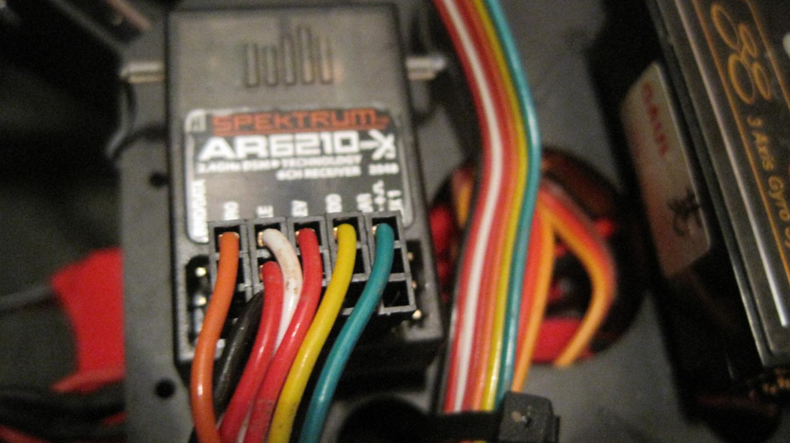

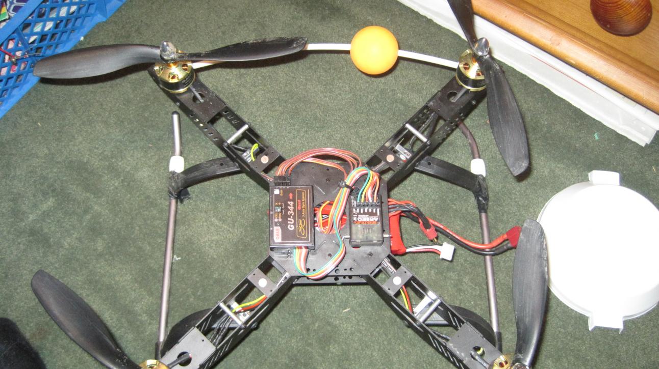

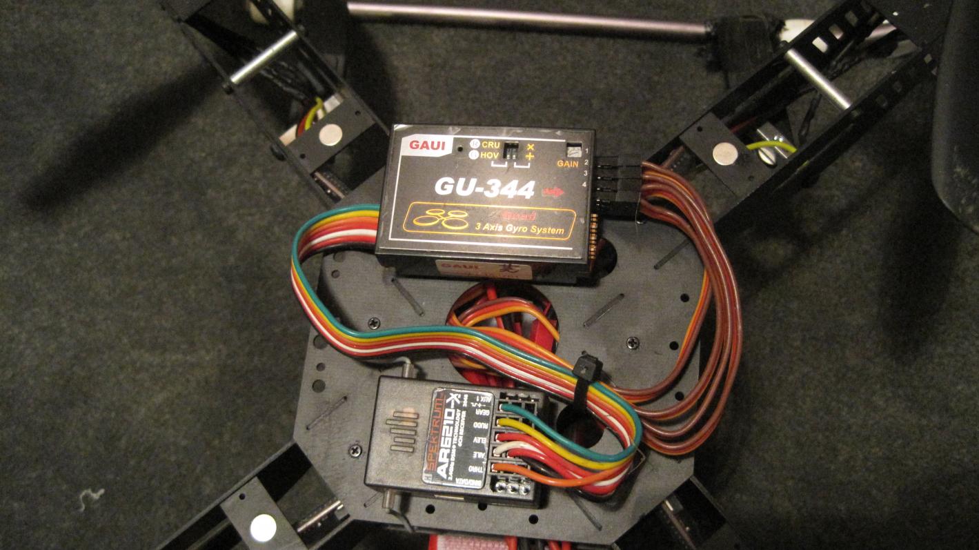

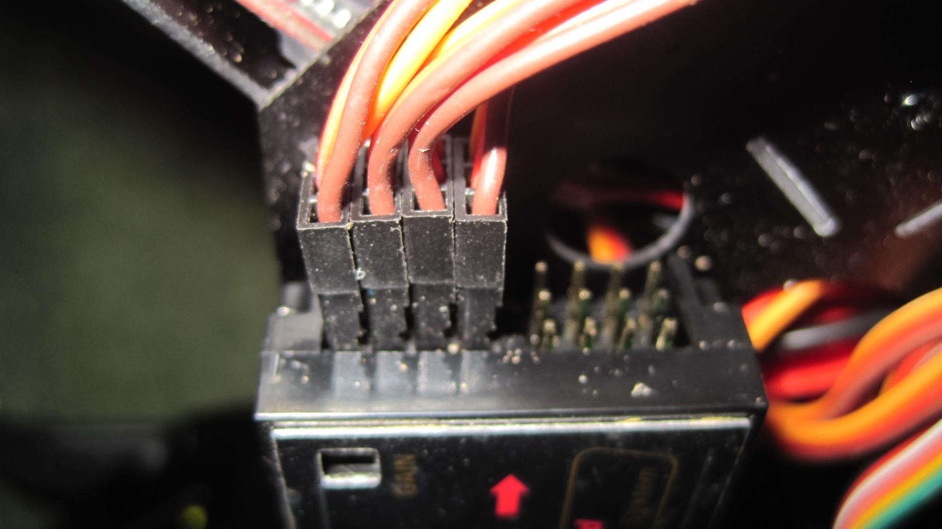

Everything looks as per, in your pics, just recheck your wiring. I have my gain set at around or <50% so it could just be throwing a bit of a fit @ 100%, I think when I first flew mine the gain was set at about 70% and it oscillated so I dialled it down till it was steady. I notice you have the green wire connected so it could be the settings in the Tx. Try disconnecting the green wire and set the gain at about 60%, switch between cruise and hover with the dip switch on the gyro, best to switch it to hover for a start (green light). give it a good push to get it up out of ground effect, in hover you shouldnt have to touch your cyclic stick at all and it should just lift straight off.
When I use my Tx to switch between cruise and hover (green wire connected) I set my Tx setting for gyro at 30% and 70%, if you set both cruise and hover to 50% for a start then adjust as necessary. I would say forget about the remote switching until you get it flying properly.

Alex , Check your wires inbetween the esc and motors , and make sure they match in this order Motors at 1 oclock and 7 oclock , and 11 and 5 o clock are the same colour as per the manual .
It is only a thought , but looking at the skids in the picture this has been off the ground and in a bad landing and it could be a possibility that the cables have come apart inbetween the motor and Esc and then put back in wrong.
