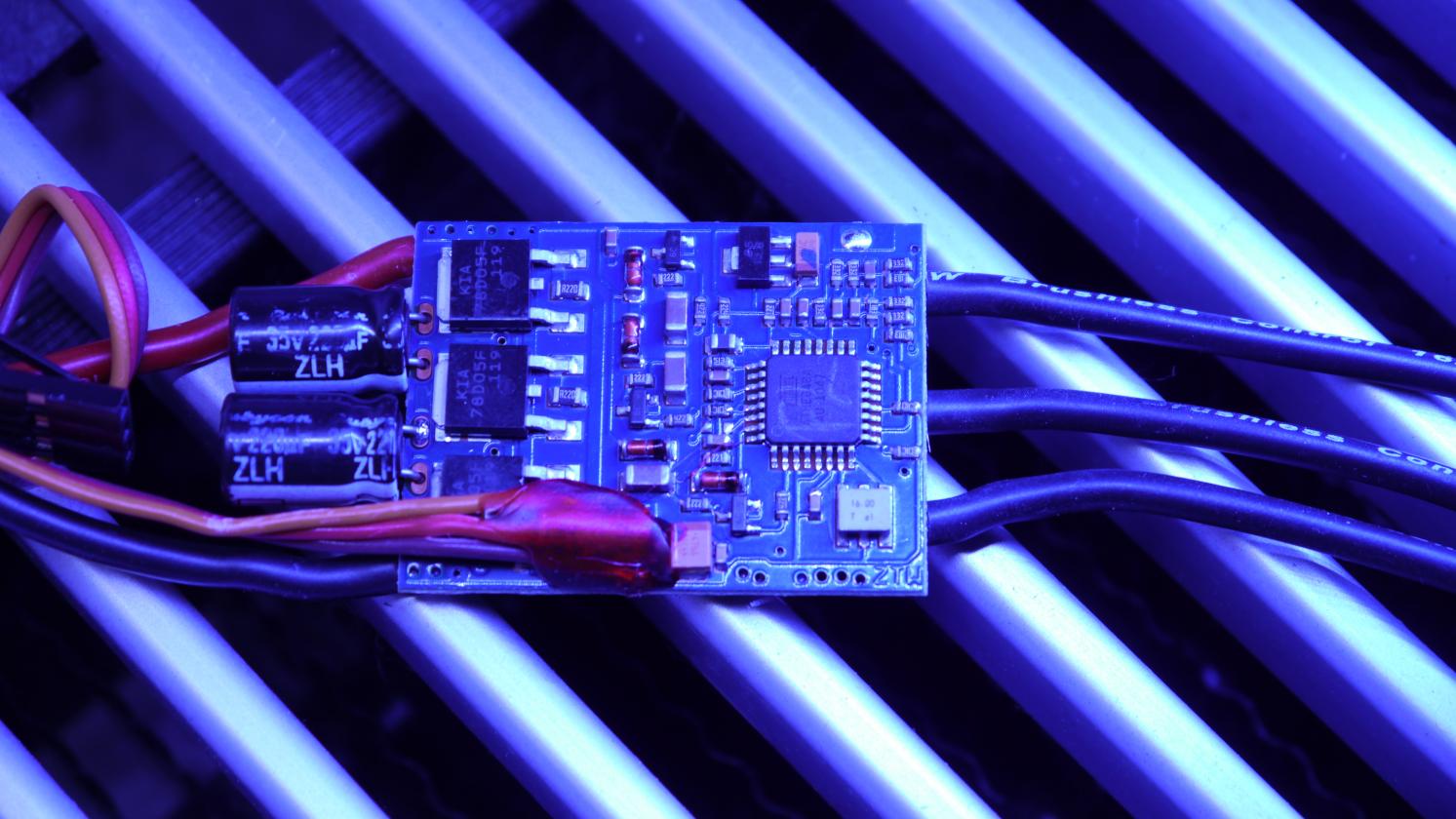

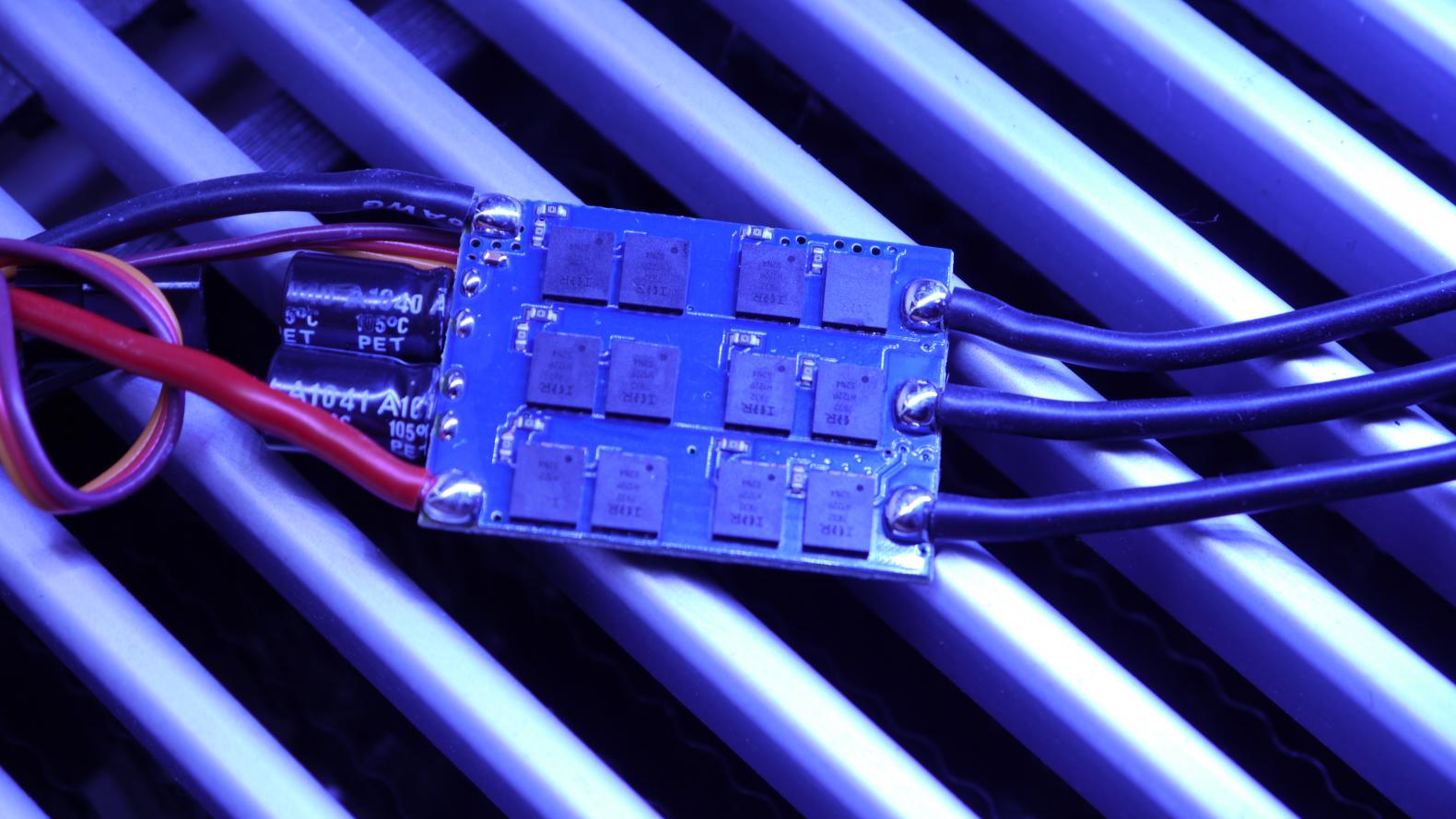

HI Bart,
i personally certainly fell for the thought that the V2 might be better than the V1. Back then ordering them though i explicitly expressed that I will be using them with WKM thinking bluntly that they have to be compatible with most given motors used in the MR scene.
Things changed though on the maytech.cn page to the better and they explicitly offer the V1 version as multirotor packages now:
http://maytech.cn/eng/prolist.asp?p...tor Servo Propeller for RC Hobby from Maytech
Its just a jungle out there concerning the counter ESCs and finding the right ones if you want to step out of the line and using something new that could be better. On the other side Maytech seems to one of the first with a few others to adopt to the market and taking the MR scene serious.
Build wise the V2 are certainly of higher quality than the normal hobbywing turnigy ESCs.
View attachment 3612View attachment 3613
