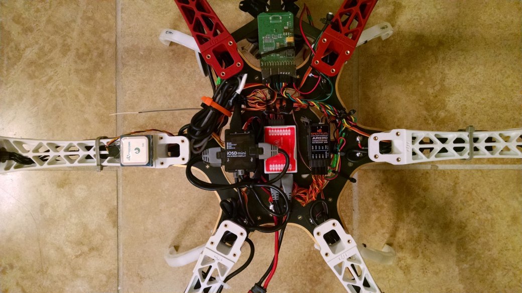

So, I decided I needed to build a "long range" multirotor. After a lot of calculation and experimentation, the current incarnation is as follows (pictures attached).
MR Configuration
F550
Naza M V2 + GPS
Spektrum AR9310 (for the long antenna leads)
Zenmuse H3-3D gimble + GCU
GoPro Hero 3+
iOSDmini
MFD TeleFlyPro OSD (only for antenna tracking, OSD turned off)
Immersion RC 600 MW VTX
Immersion RC Spironet VTX antenna
2S 2350 mAh video battery (runs TFP OSD, VTX, an Hero3+)
4S 11,000 mAh flight battery

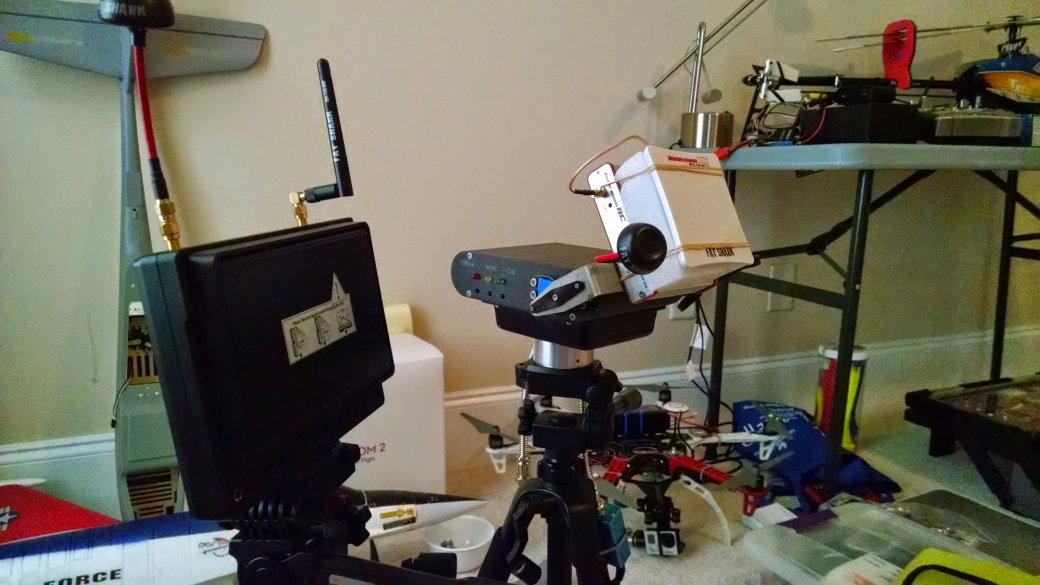

Ground Configuration
Spektrum DX8
Immersion RC Diversity Receiver
Immersion RC Spironet RX antenna + RHCP "patch"
MFD Antenna Tracker (NEMA encoded on the video downlink)
generic 7 inch video display (also diversity but not used)
With the current MR setup, I'm getting about 17 mins of forward flight time (at reasonable forward flight speeds). Next steps are to change the transmitter/receiver to Dragon Link UHF, as my range is currently limited to about 1.5 miles (after that it starts to get dicey).
